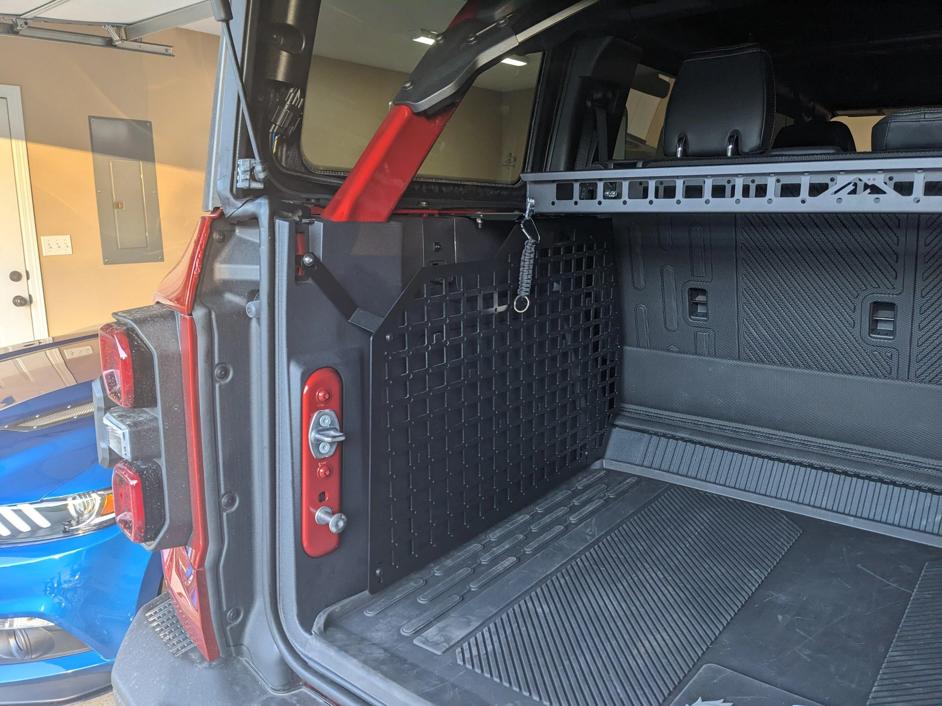

Looks terrific. Would like to do something similar. I'd love the details on where and how you routed the wiring? And what gauge?
Thanks
it comes with a 7' harness which isn't long enough, but they make a 7.5' extension harness to add to it. its ran down the side panel corner then under the rocker panel sill top panels all the way to behind the dead pedal panel then through the rubber grommet plug. The two harness connectors between the two harnesses I got to sit under the drivers top middle sill pop off panel, its tight but got it to work. The gauge is a Measurment 2-1/2 Dial Glycerin Filled. I may at some point put a regulator on it so that I can set it at 45psi for refill since the system holds 90-100psi.

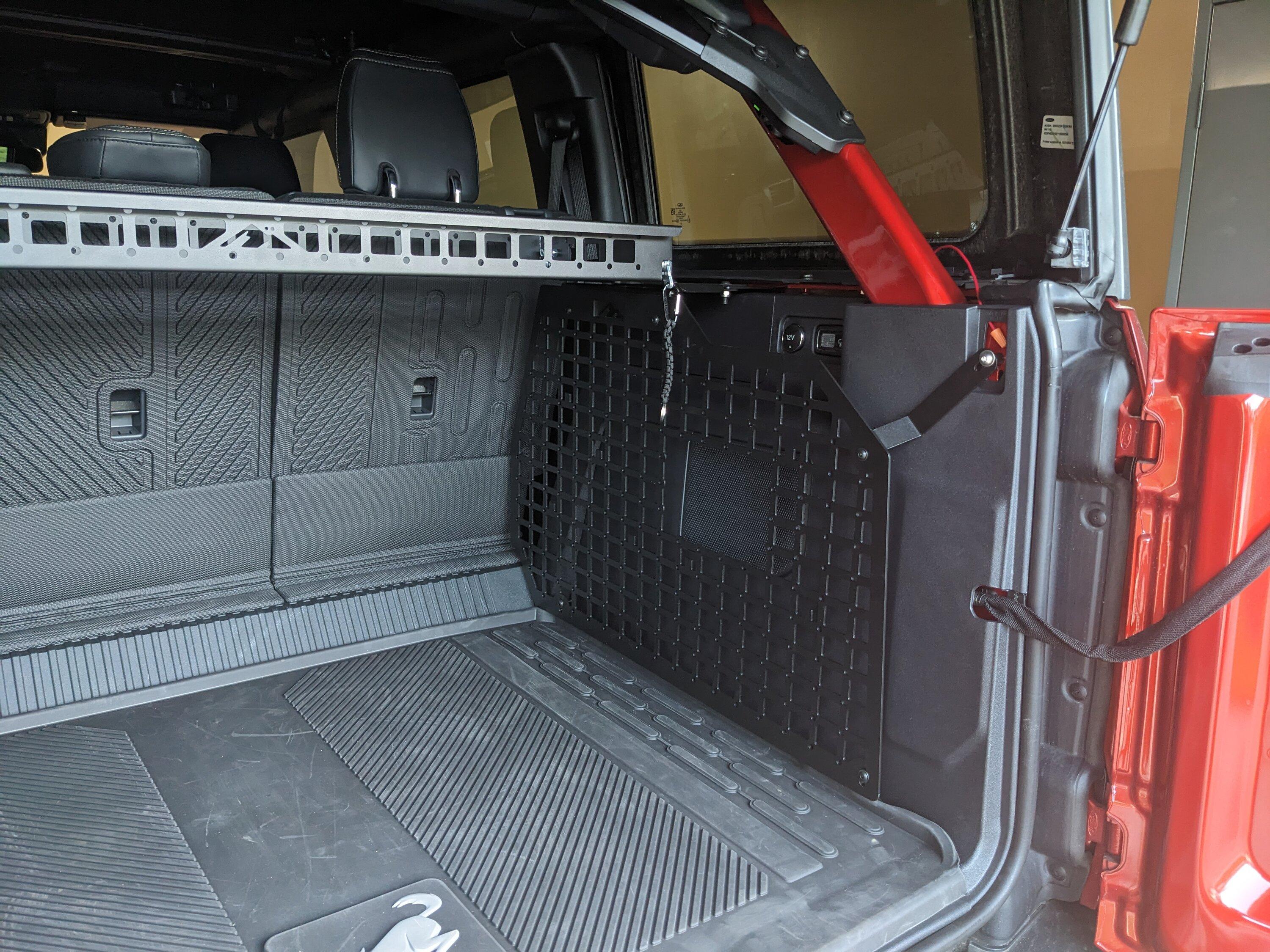

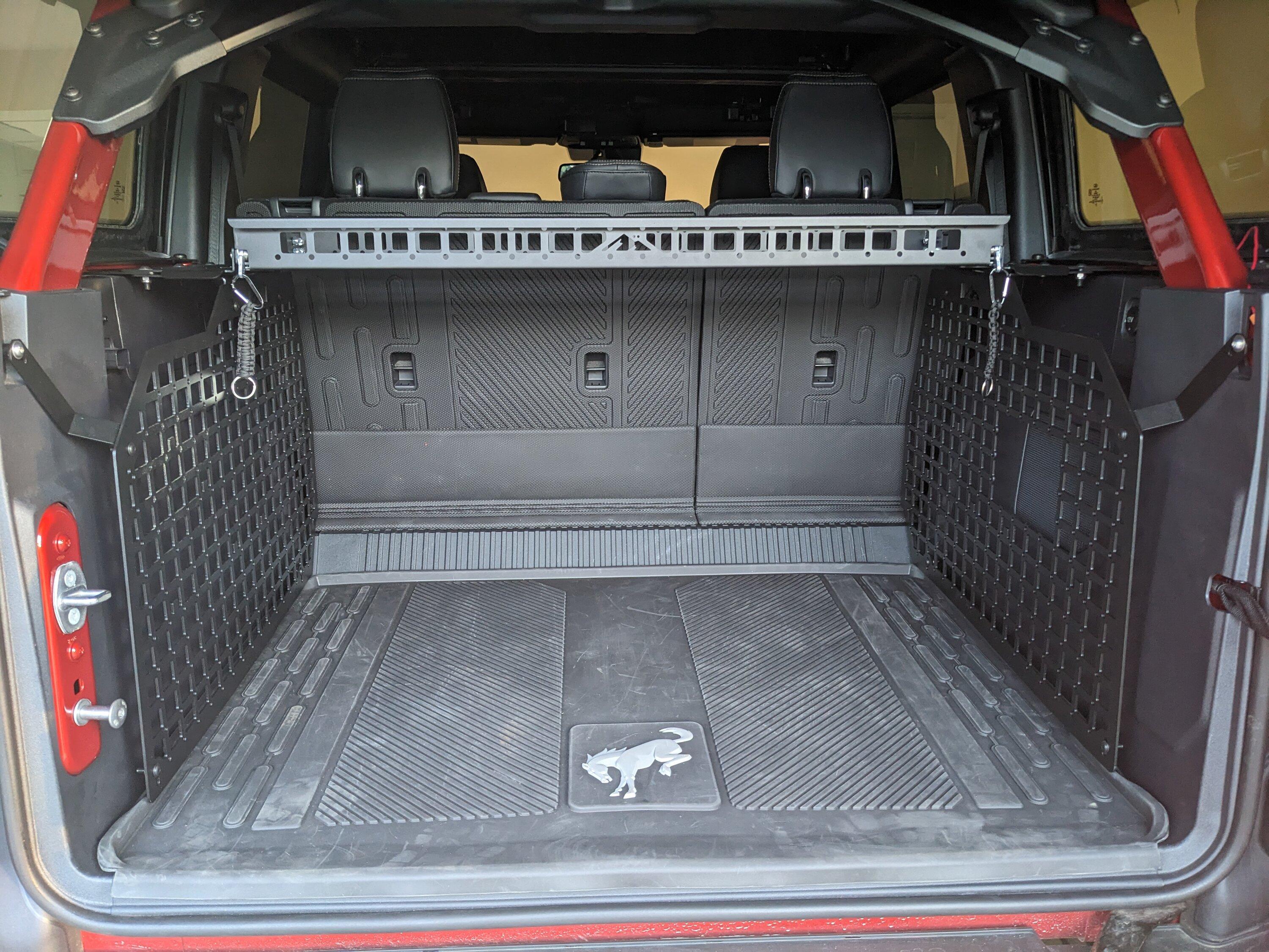

Finished the side installs after I upgraded the subwoofer. No more worries of scratching up the panels. Next up install the onboard compressor. @Copperhorse73
Any rattling in the cargo tray? Could you feel comfortable mounting a small 10” subwoofer to the tray?
Once in a while you might hear a rattle if its empty, but since I carry bungie cords I just connected those and zero issues. Given the weight of a sub I would say you wont have any issues.

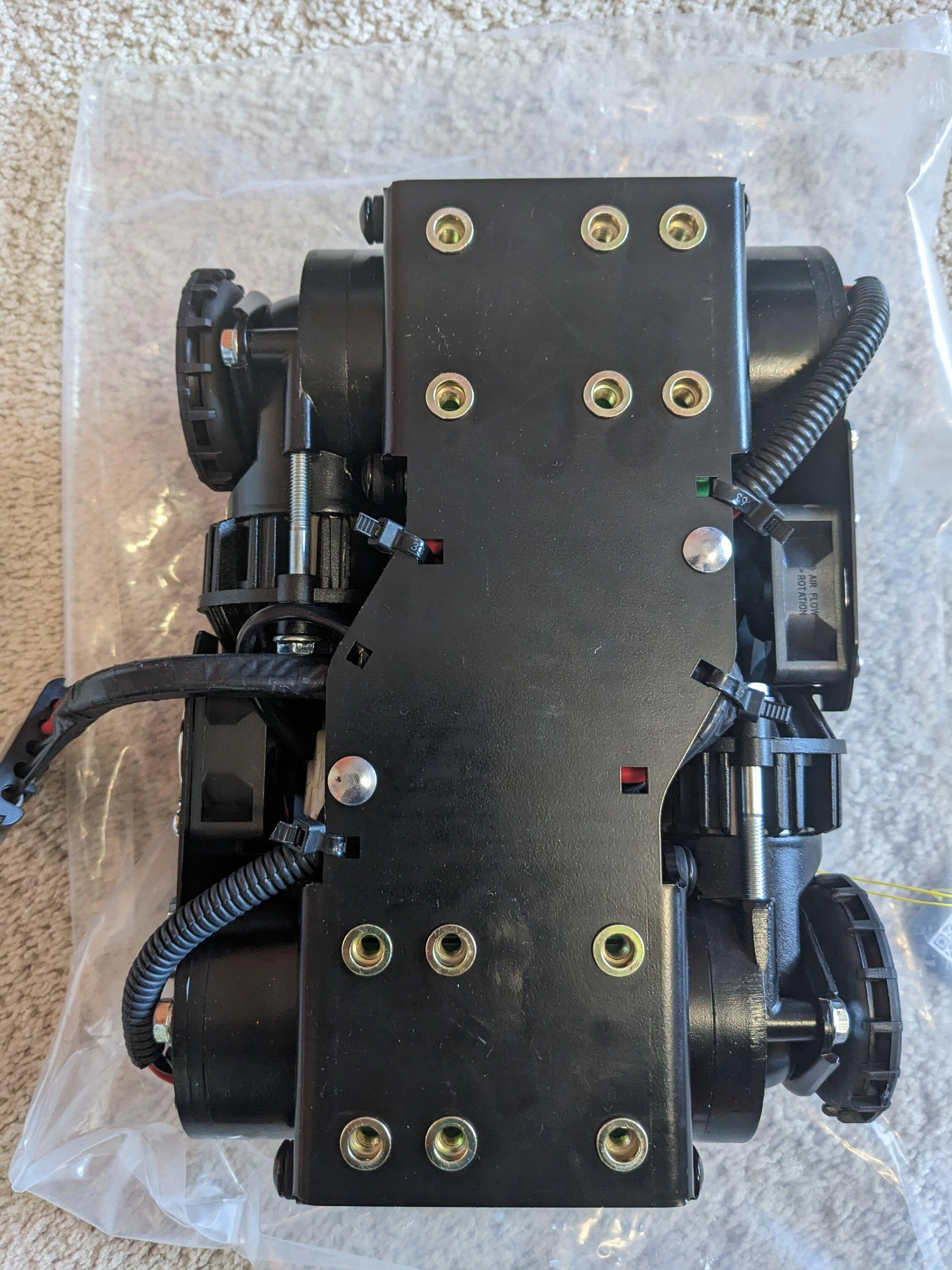

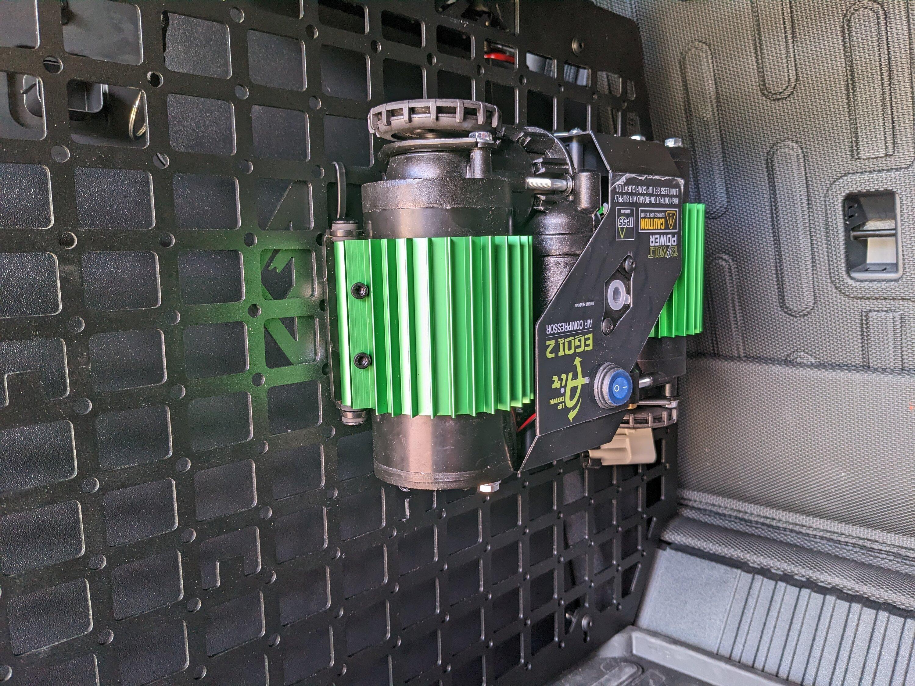

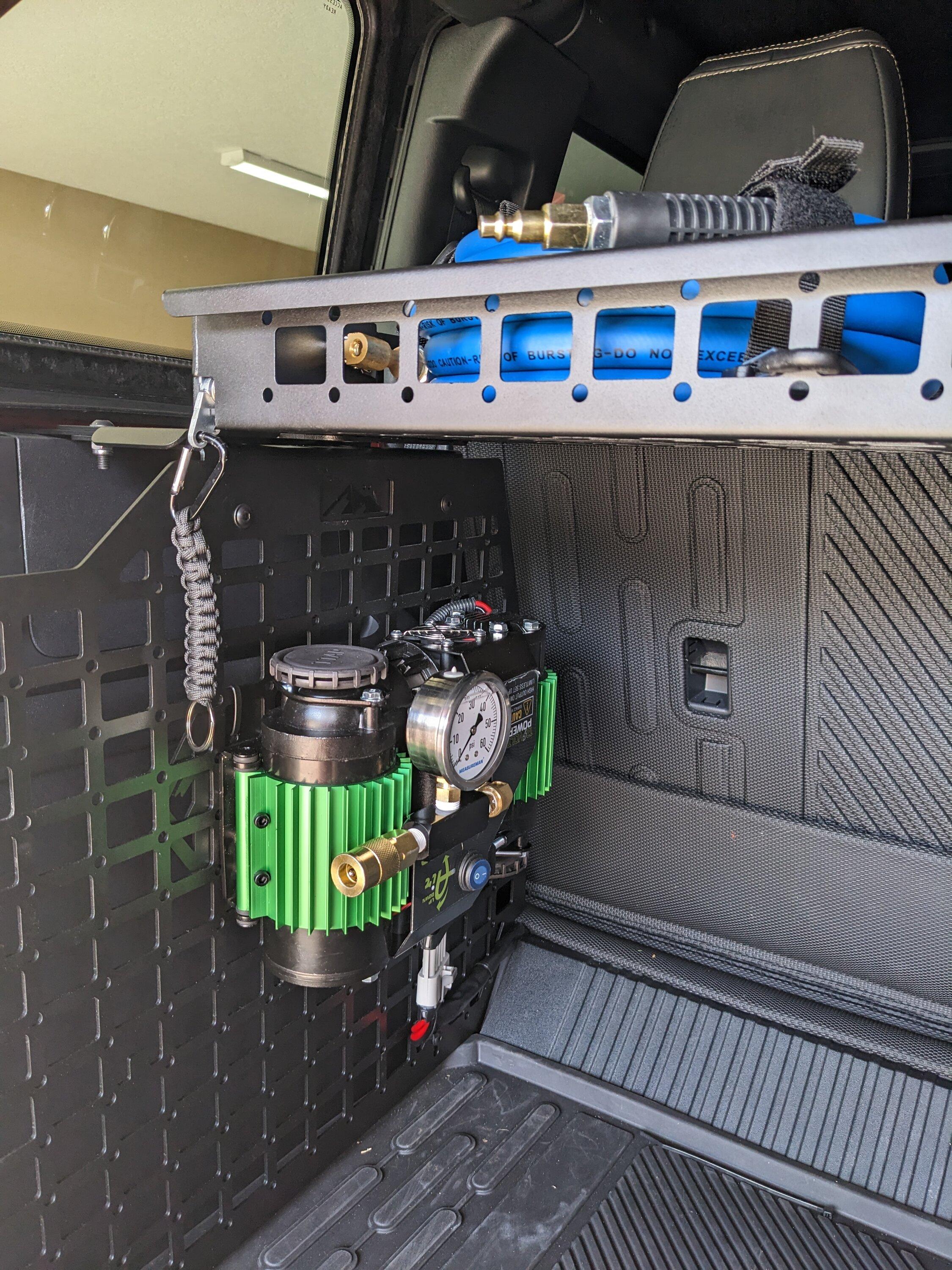

Getting closer just waiting on an extension harness and fittings. This is an EGOI dual compressor and has a switch on it so that's a nice feature.
This has a bit different backplate than the ARB but you can get 6 of the 8 bolts needed for the Mountains2Metal molle plate and it's very secure. @Copperhorse73
Do you have any experience or opinions on the EGOI yet? It’s at that price point where I’m thinking “it’s $100 more to get the ARB, so why not get the ARB”
I have used it a couple of times no issues so far and I like the simplicity of the built in on/off button instead of wiring in a separate switch.. I got the EGOI for a lot less (discounted at $449) so that is the reason I did it.

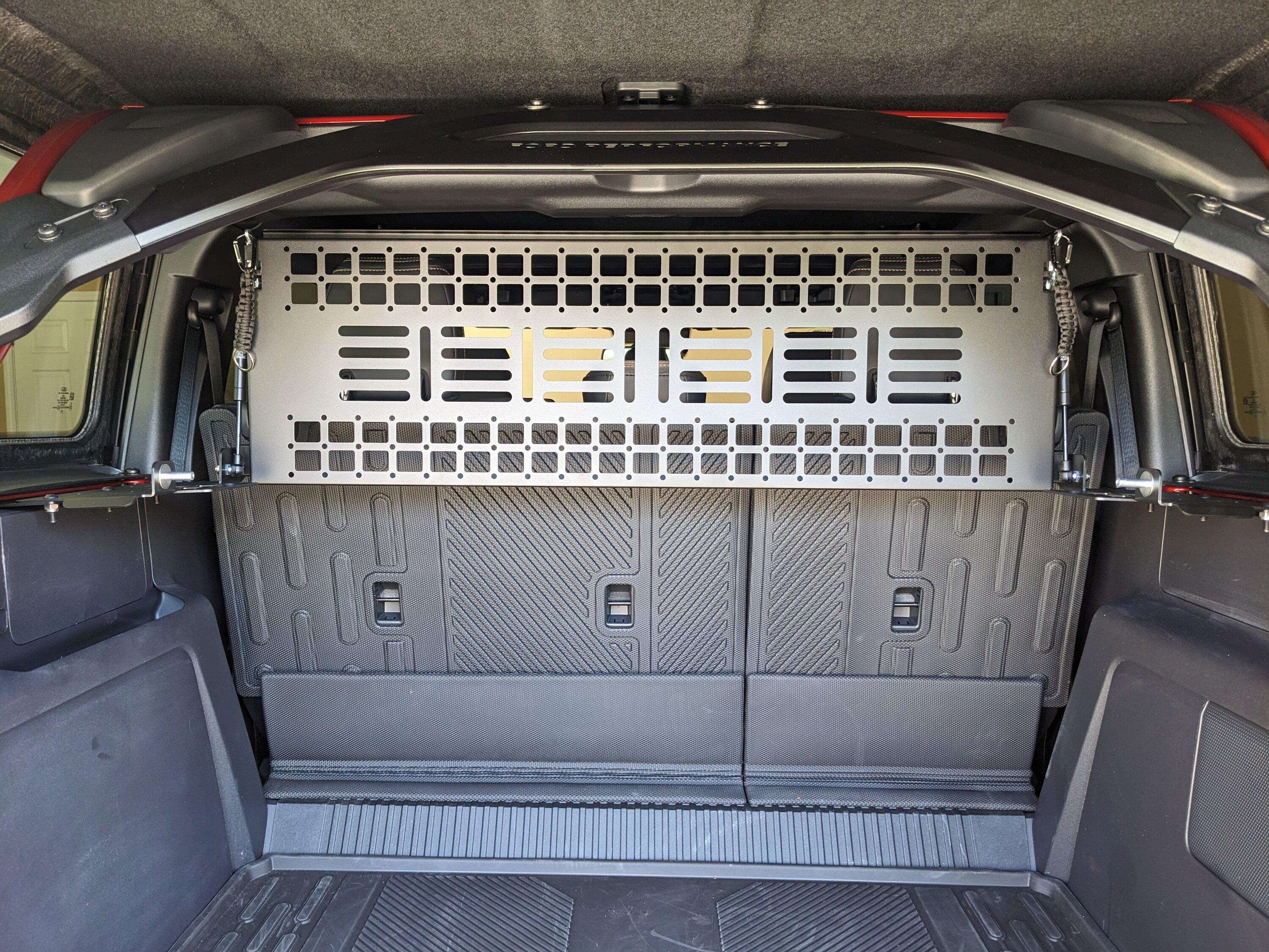

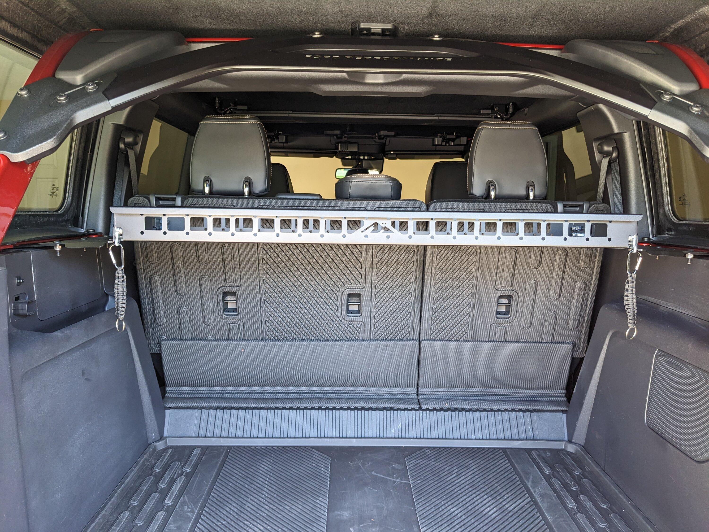

I like that the M2M panels allow for rear seat recline.
