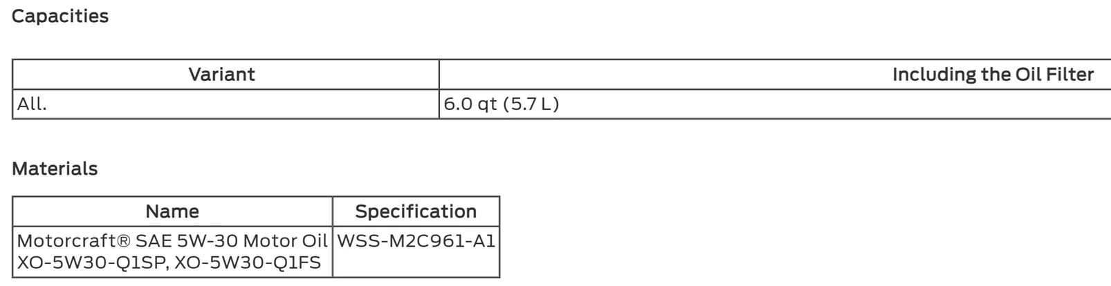

Good day everyone. I have a 2023 Wildtrak 4 door. Please note that I didnt measure the first time I changed it.
I installed a Ronin plug during the first change.
Today I changed the motor oil and filter. After measuring what I took out and put back in, both are at about 6.4 quarts.
I was under the impression that it took 7.7 quarts. The lipstick reads at slightly above max with the 6.4 quarts. I also let it drain until it stop (tiny drips left).
What gives?

Interesting. Thank you very much! I didnt realize. Good thing I checked the dipstick before continuing to add.

6 quarts

Before I drained I losses the filter, removed cap and dip stick got 6.5-7 in.

I just changed the factory fill on 24 wildtrak with 3,300 miles. Remived filter first, then let pan drain 20 min. Didn’t spill any draining and it measured almost 7 quarts. 6.5 quarts went back in be at full mark
