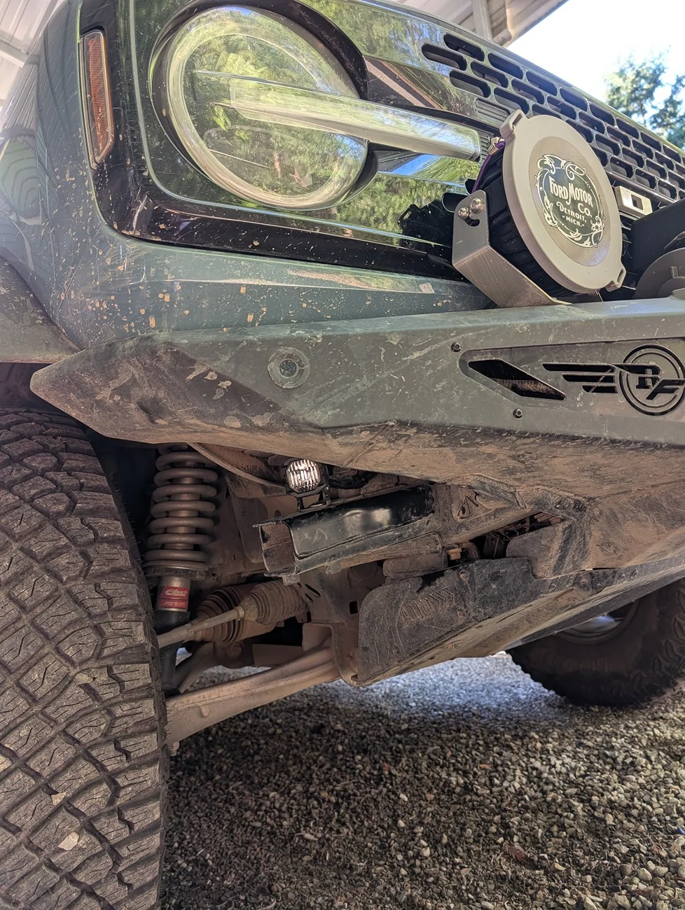

Mounted a set of Morimoto 1 Banger combo beam lights on top of my crash bar mounts to serve as cornering lamps and wired into my fog light switch. With the extra clearance of a ADD Rockfighter bumper it projects light were I wanted it. The positioning is a bit vulnerable, but I'm hoping they can hold up to the abuse. I may 3D print a shield for them, though. The combo beam has a nice spread to it with a brighter area towards the middle. Very nice lights. The little dudes feel robust and the mounts are stout with a beefy, large torx headed carriage bolt for mounting. The T-20 Torx screws on the sides for the pivot point and angle adjustment seem to hold very well. Have some issues with the FORscan programing for cornering functionality, but I think I can get that resolved. Light pics are headlights only - 1Bangers only - both. I have the right one angled slightly more outward since right turns tend to be sharper.

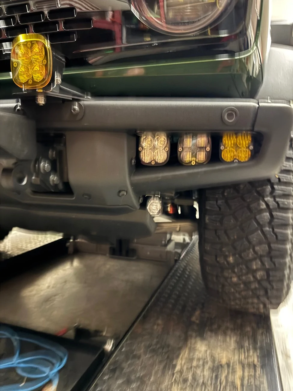

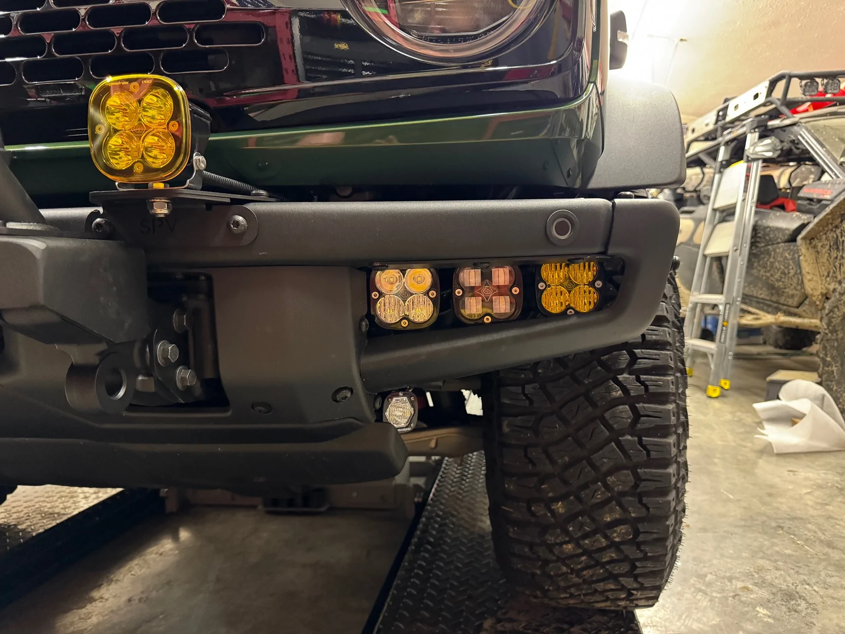

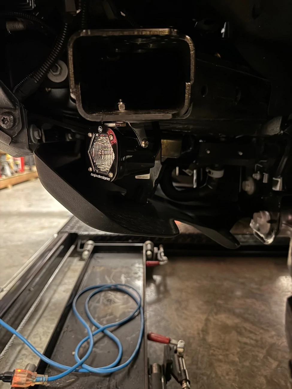

Cool. I did the same thing with a pair of BD S1 with the trail lens. They are tucked back somewhat protected by the skid plate.

Here are some quickies from a totally dark garage. This is only the pair of S1 nothing else
