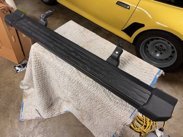

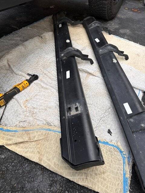

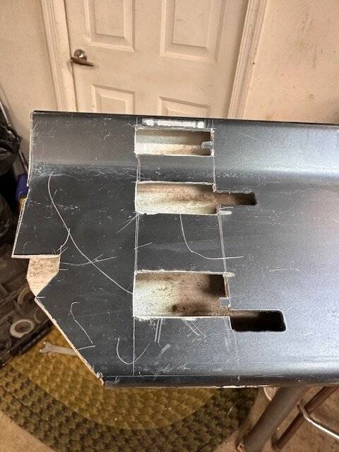

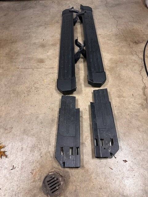

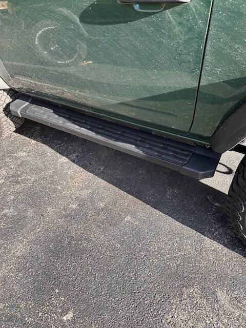

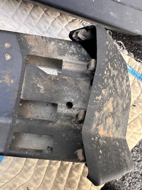

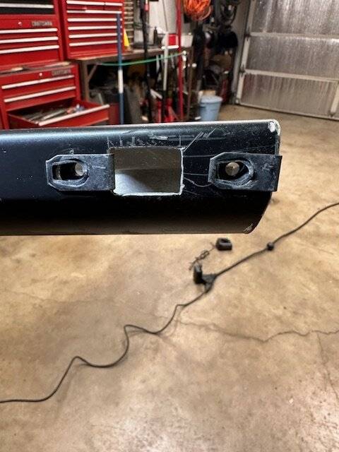

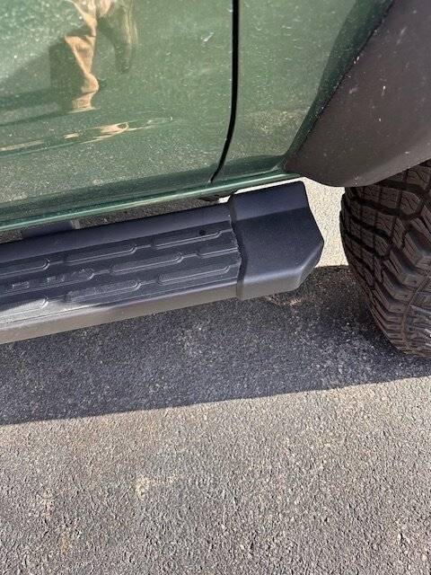

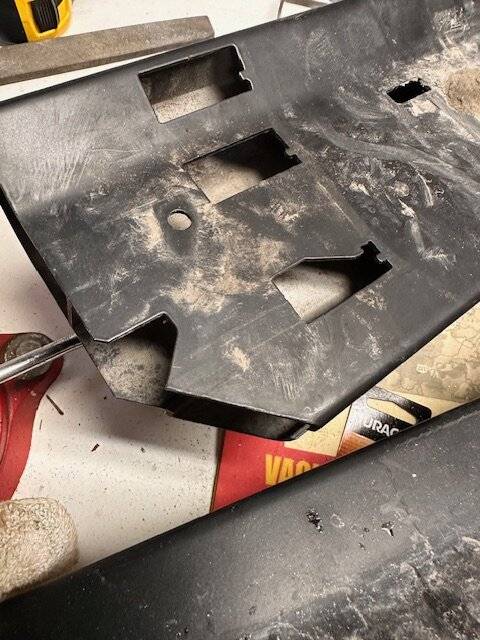

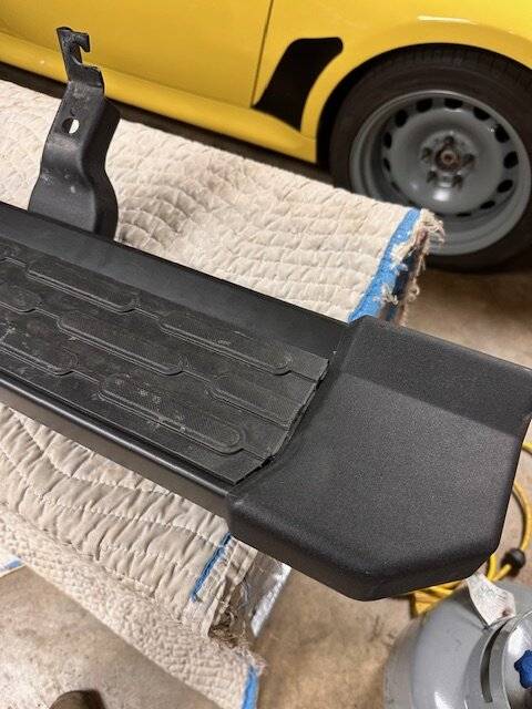

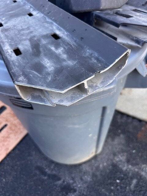

Saw a post a while ago about someone cutting down a rock slider. One of the comments someone made was 'now do a step!', Picked up a four door oem step set, cut them down, made what I consider an acceptable set for the two door. they are aluminum, so it was infinitely easier to cut than steel. Cost me 100.00 and a Saturday morning just putzing around..

I would have sold you my factory 2 door steps for $100... Possibly less, depending on my mood.
You did a great job though.
