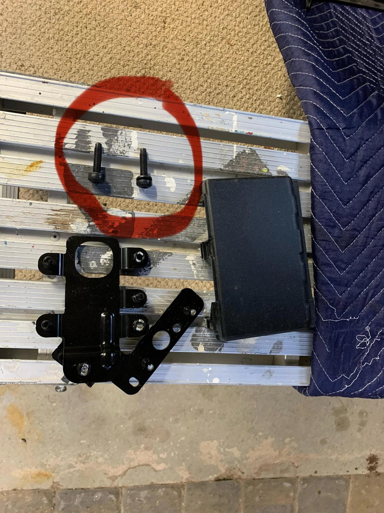

I recently purchased a MOD bumper that came tonally in pieces. I mocked it all up and I have 8 Torx 45 bolts left. 6 are for fog lights and 2 are slightly longer than the others. I looked at the diagrams and stared at the bumper for an hour but I can’t figure out where these go. Any ideas? Thank you!

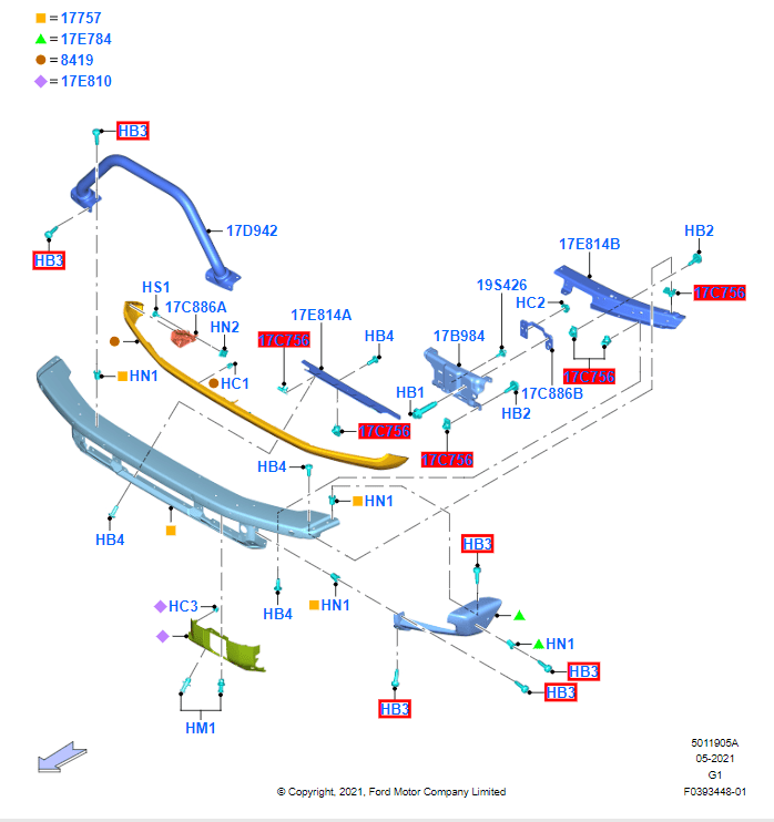

4 of those go on each side for the removable end caps, the only other place those same bolts are used is for the push bar mounting locations.
Everywhere you see HB3 listed in this picture

Yes, thanks that’s what I saw too. The end caps came on it but maybe they were put back on with wrong bolts? I will check that too..didn’t think of it.
Thank you!
