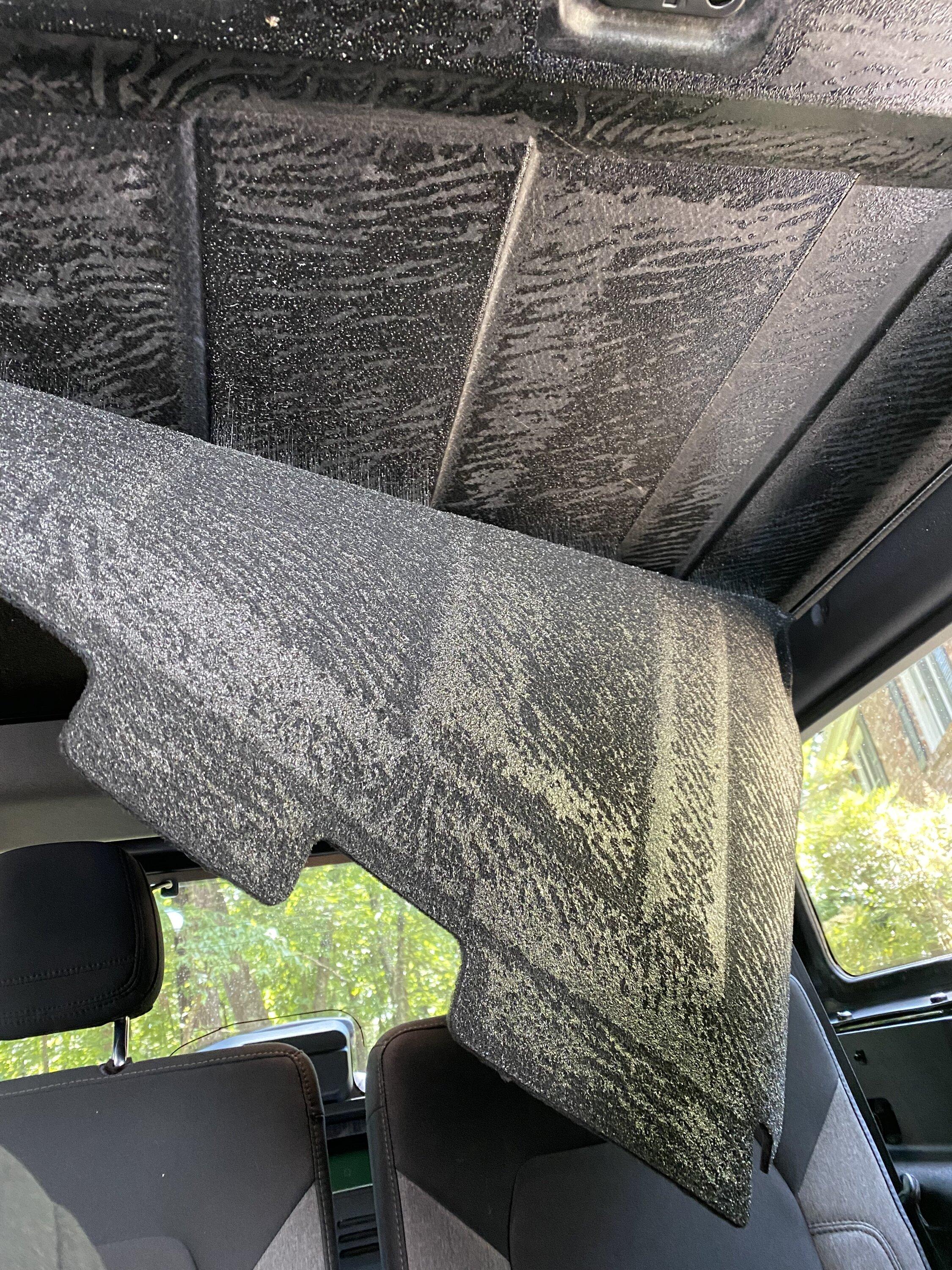

First issue @ 11 months. Always garaged. Opened door to this surprise yesterday.
I am aware that there is a service bulletin. Dealer says approved method of remedy is 1 try to repair in situ, ,if that doesn’t hold, top is replaced. This dealer is 50% at successful repairs.

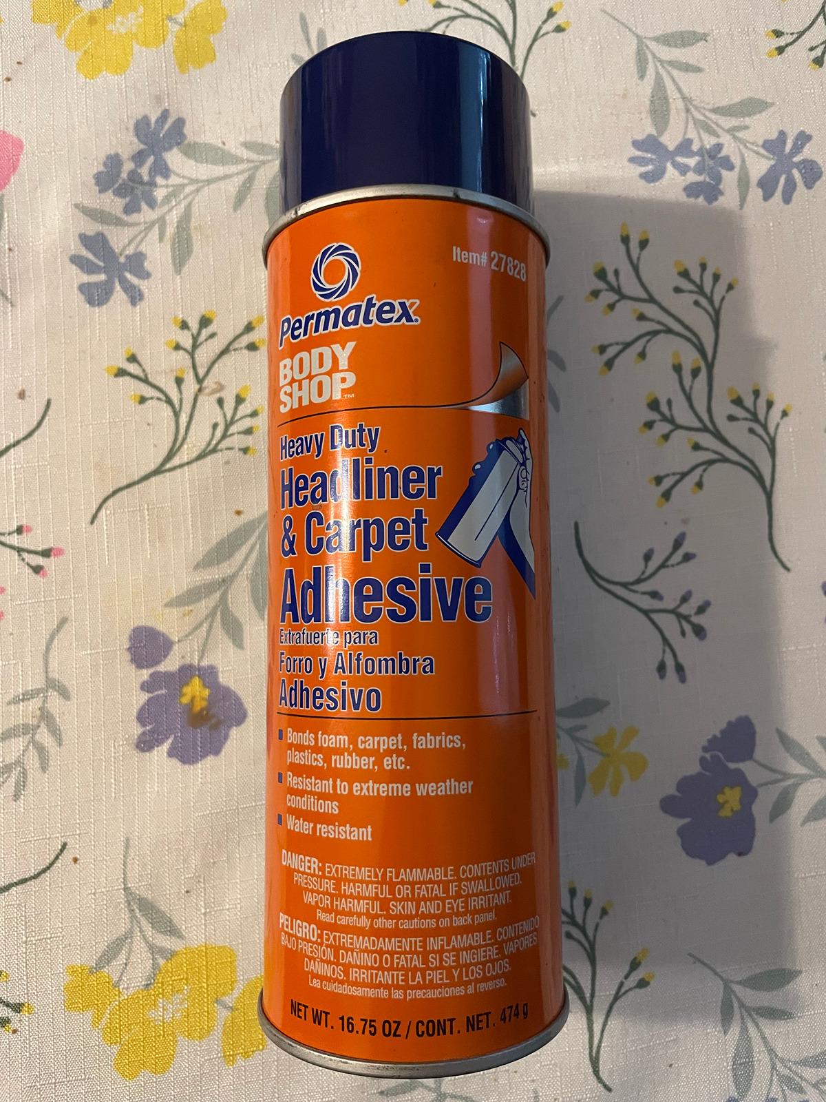

I would try some headliner contact cement. Permatex makes some pretty good stuff that I have used...
