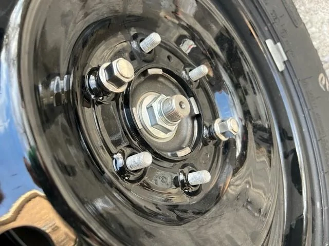

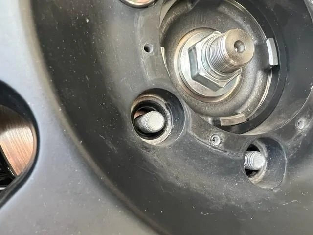

So I got my black diamond with Steelies and pulled them off to replace with Method 315's and could barely see the wheel studs. The methods are much thicker. I was able to get 7.5 turns which seems ok, but man they look short. Is the wheel stud shorter for the steelies, only 7/8'" long? see pics.
thoughts??

In theory, the depth of the engagement of a nut onto a stud (lug) should at least be equal to or greater than the diameter of the stud. At 7.5 turns you are probably "right there". That said, it is easy enough to replace the studs. They can be banged out with a hammer and you can "pull" new ones in with a washer and high quality nut. I'd recommend that you swap them out.

That sucks, but it makes perfect sense that the thinner flange on the steel wheels can use a shorter stud. I’m surprised this is the first post I’ve seen about the issue.

So long as you are getting a full nut of threads you are OK. I know you cannot tell for sure w/ the capped nuts but you should be able to confirm w/ by using an un-capped nut for visual verification.

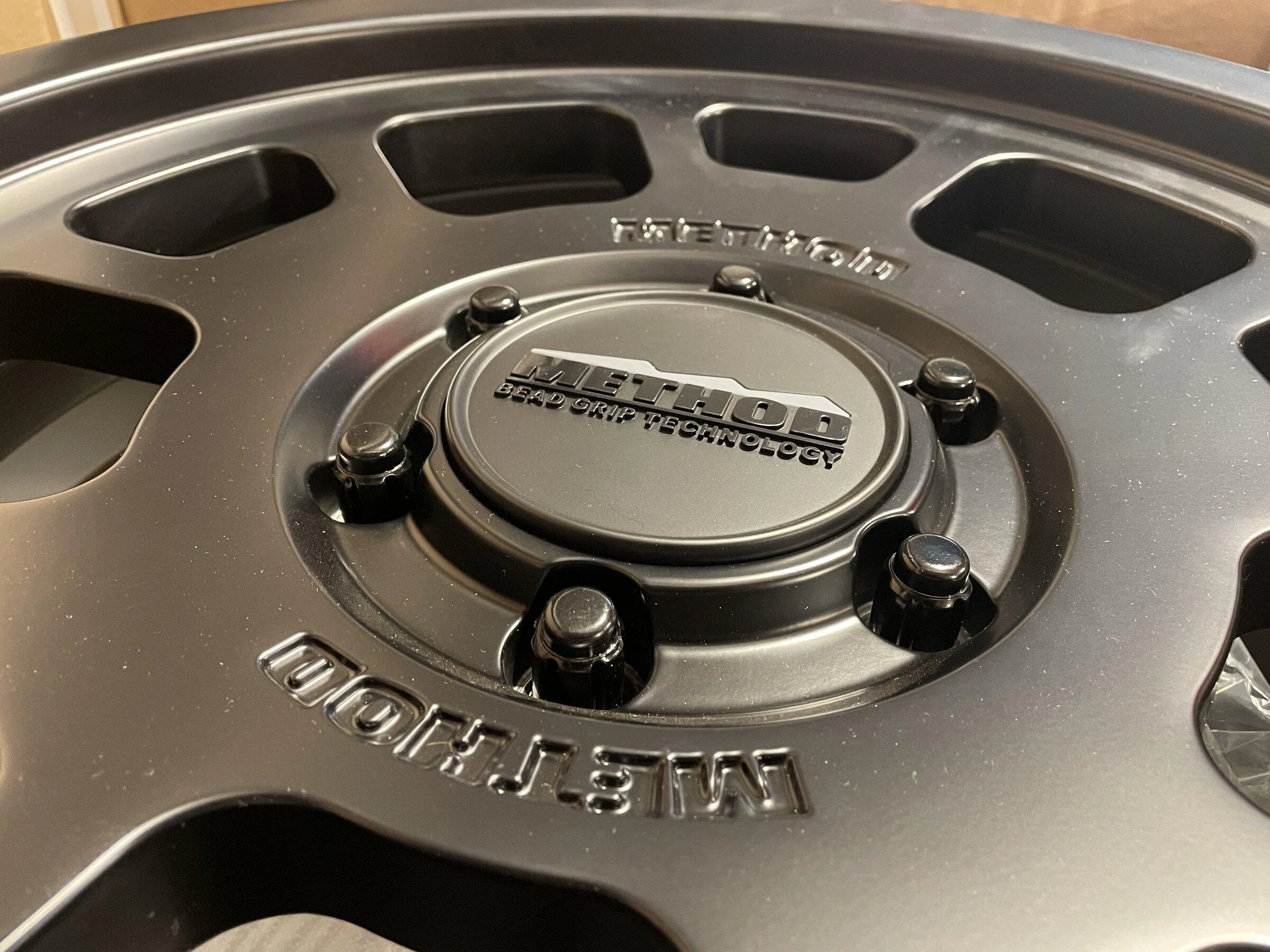

Here is a pic - Method 315's 8.5x17 0 Offset

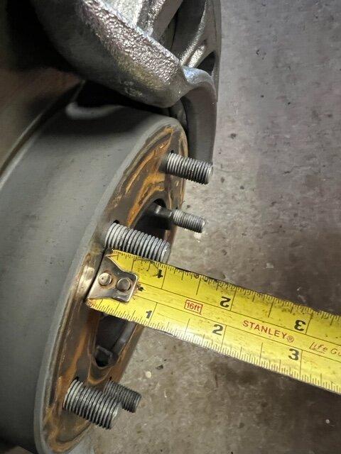

I am having the same issue with my badlands and Liberty rims. I only get about 5 turns. Does anyone where i can get longer studs and have a part number ?
