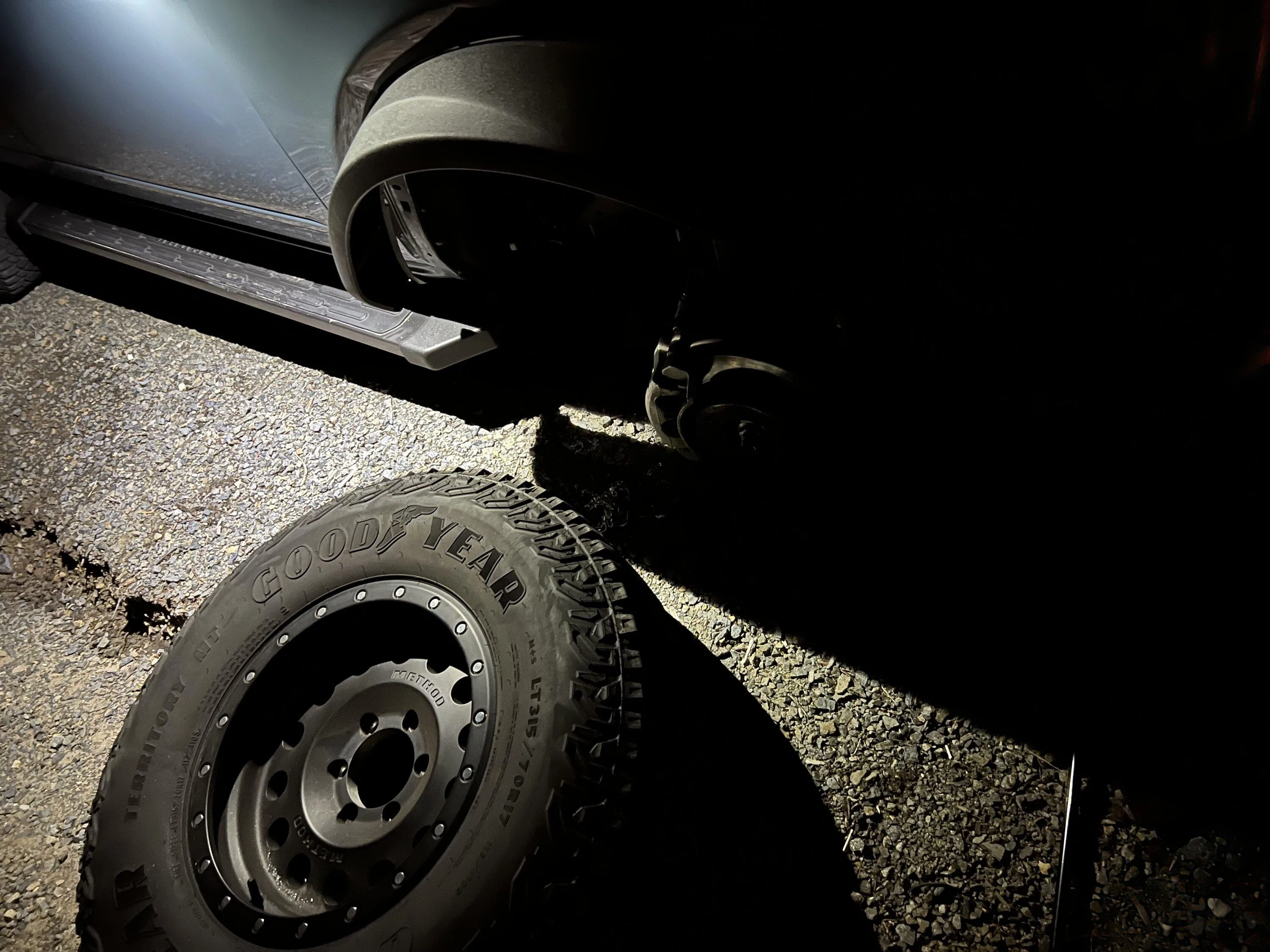

Hello Everyone!

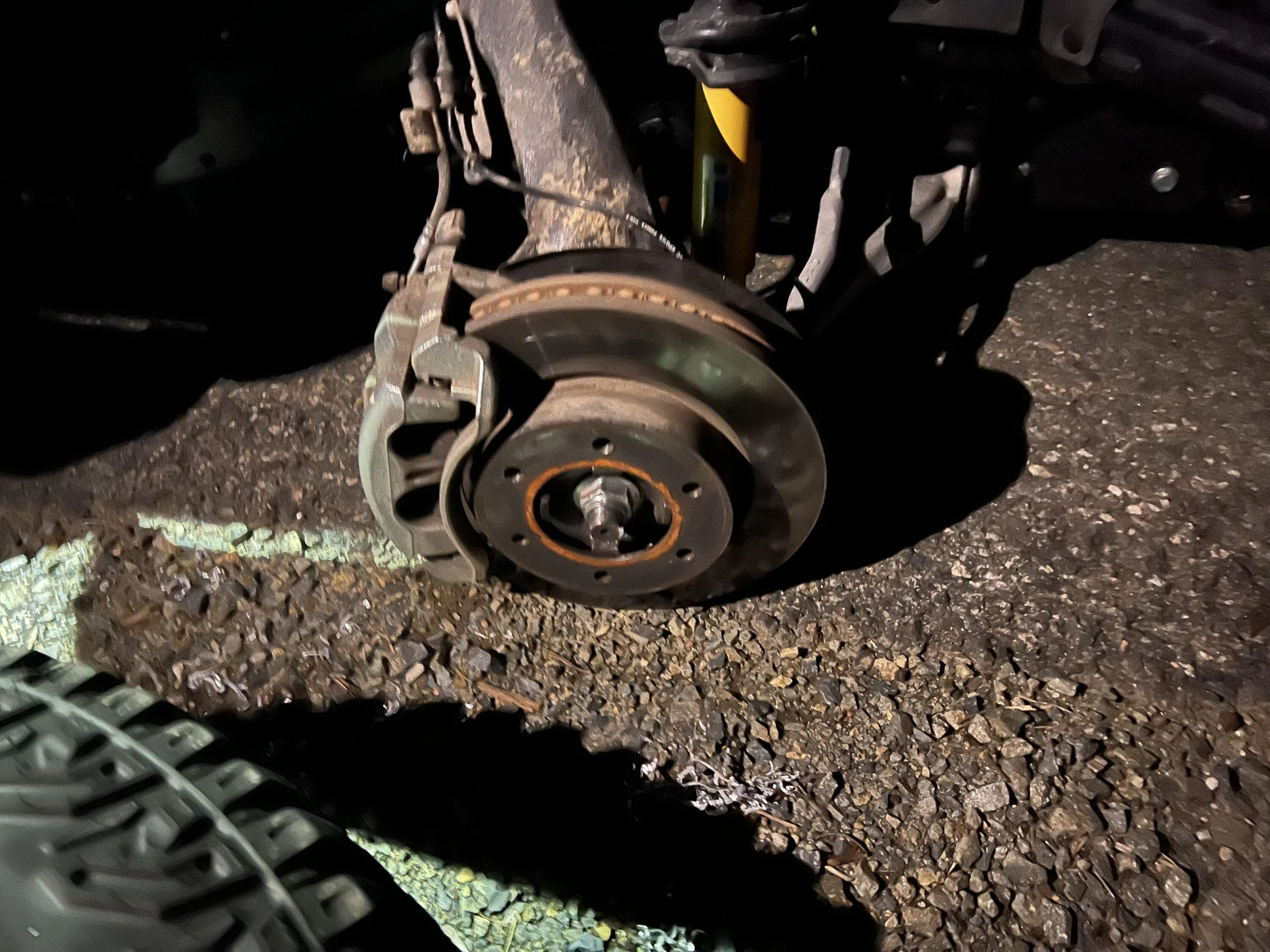

this is my first topic and I’m not sure where to share this, but I have 5 Broncos through my company and 1 has Method MR 307 wheels. I heard a light wobble in the front diff area Saturday and thought I’d take it to Ford on Monday. Saturday night, I’m driving the Bronco at 55-60 mph and the right front wheel fell off. I looked at it and the wheel studs sheared off. I have 26k miles on this truck. 23k with the wheels on it. Ford has serviced it from the beginning because it has a service contract. They have rotated the tires every time.
I took it to Ford and the service department told me they were not going towarranty it because the Ford hub is 93mm and the Method MR307 is 106mm.
The irony is this dealership along with every single dealer in the country is selling them and adding to new vehicles. I purchased these wheels through Discount Tire though but this shouldn’t matter. It’s the point they’re installing them at the dealer but won’t warranty the same wheel.
I just contacted Method as well and sent them info regarding this wheel. Question is, is this a fluke or could this happen to all others? If so, Method/Ford should take these off the market.
This could have been catastrophic! I was with my 16 year old son. What if I was on the freeway and the wheel fell off?
Any recommendations or suggestions are welcome!
