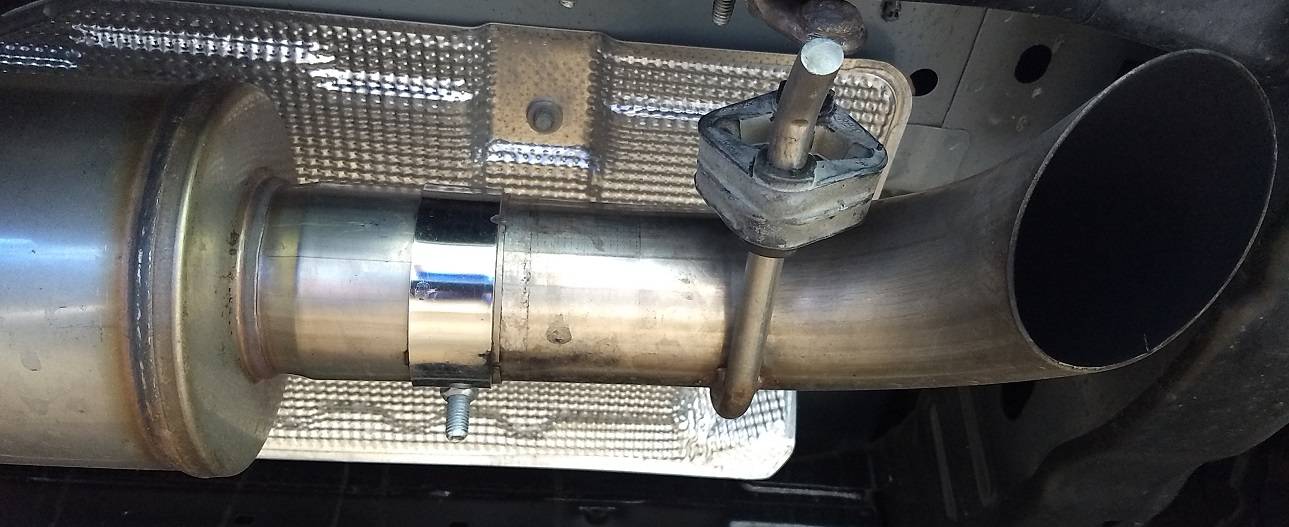

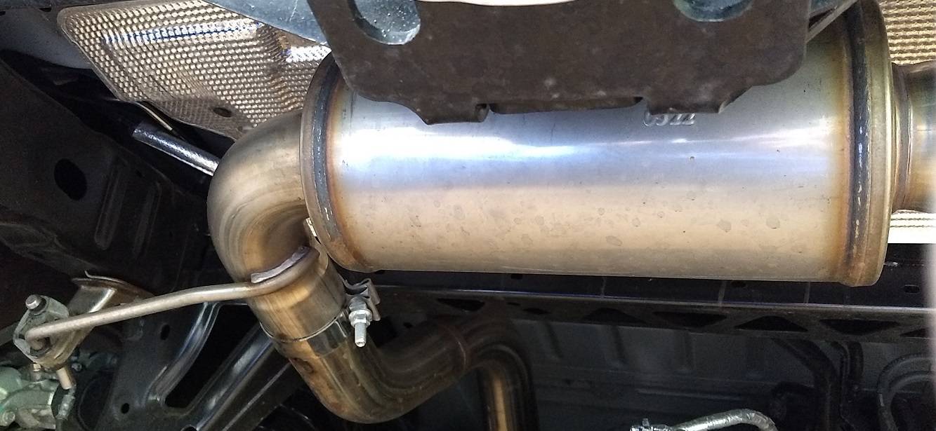

Ok- installation was fairly easy. The fit, finish and quality of the exhaust system is excellent. It is fully bolt on, assembled super easy and included the nice round HD band clamps. It fit right in the factory stock exhaust hangers. It has a muffler included that goes further up in the system and it fit very nicely. (It was great to get the factory huge muffler tank out, LOL) I used basic ratchet and sockets- you will need deep well sockets. The system is a 3” and 2.5 inch after the split. The polished tips are 4” and I was able to adjust the tips so that they are the exactly the same on both sides- protrusion and distance from the bumper- I am a stickler on this. Some systems I have done in the past I have had trouble getting even. The same system fits 2.3 and 2.7. There is an extra exhaust hanger and spacer to install if you have the 2.3. For 2 door Broncos you have to cut the mid pipe shorter. I tried to use my tail pipe cutter, the pipe was too big- so I used a plain ole hack saw and took my time to get an even cut all the way around. I don’t have a lift either- I installed it in my home garage laying on the floor. I had only one issue of a rattle that I easily resolved. The hanger on the first pipe that bolts on where the factory system comes off goes completely through the factory rubber mount instead of fitting into it like the factory hanger. It then passes through a hole in the frame. When I wiggled the exhaust to test for rattles it was too close to the edge of the hole in the frame and rattled against it. So I simply took a heater hose the same ID has the hanger, slit it and installed it on the very end of the hanger where it goes through the hole in the frame. I secured it with a wire tie. It is far enough away from the pipe and insulated by the hose so it should not melt. Rattle gone. For others installing this system you could maybe just cut the hanger shorter so it does not go through the hole in the frame. I would have had to remove that pipe and was too far along to do so at that point. It took me about 3 to 3.5 hours to put the system on taking my time.
OK now for the sound…....simply put I love it. Start up, through all the gears and cruising RPM’s it’s perfect. Deep and throaty (for a V6), no rasp, no drone at all. It’s a little “loud” and so throaty at start up but “loud” and “throaty” are very subjective. It quiets down a little after initial start up. Sound clips are OK but don’t do justice in my opinion. You have to hear it from outside the vehicle and in the drivers seat. And drone is a problem with some systems. Not with this one. And yes it definitely has more punch- I noted it off the line immediately. I drive with a very light foot so now I just barely have to step on the gas and it takes off. I averaged 22.7 MPG before the system on regular gas. It will be interesting to see if mileage improves. The worst part is the smell of the system breaking in. So, all in all I would definitely recommend this system. I am thinking the K & N intake next and would love to do an E85 tune. I have two Racetrack gas stations 2 miles from my house that sell E85. But both can wait- I’ll just enjoy the sound of the MBRP for now.

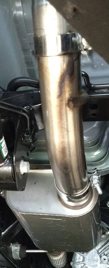

I have the Overland version which has the muffler and resonator with the single tip in the stock location and it's a little quieter. That first pipe that goes into the frame hole did not line up great for me so I tried bending it some in a vise. It helped, but started rattling a week later so I just cut the excess portion off. I think they need to go back and look at that bend or make the hanger piece shorter so it doesn't go through the frame. I went with the stainless since they love brine and salt on the roads in NJ. Mine still looks pretty good after a year with some slight exhaust leak stain. It fits pretty solid though.
Nice. Interesting that you had the same problem with the first hanger being too lang and rattling. I probably should have just cut it shorter but so far so good. Do you also have the 2.7? The increased exhaust flow on the 2.7 is not as much as it would be on the 2.3. The 2.3 does not have 3" all the way back like the 2.7 does. It would be interesting to see the sound and performance improvement bolting this or the dual exhaust on a 2.3.

Yeah, I have the 2.7 on a 2 door so I had to trim the pipe. The stock I-pipe is 2-3/4" that necks down to 2-1/2" going to the muffler (I'm pretty sure), so the 3" cat-back really helps it breathe. I think the stock 2.3 muffler is a lot worse than the stock 2.7 muffler which is why the exhausts help the 2.3 more.
