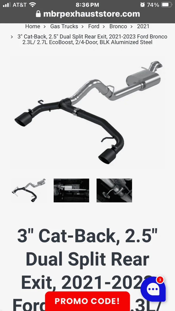

Update: I bought the cat back with the dual outlets and installed it, and I love the sound outside and I’m fine with it inside. It doesn’t have any drone but you can definitely hear it in the cabin, especially when you get on it. My wife isn’t crazy about it, so that might be an issue, ha ha. When I do serious off-roading I will remove the tips since they hang down a little bit but everything else tucks up really nice and high and tight. I have a couple of videos that I attached. and the only reason I said it was a pain in the ass to install is because I am an anal perfectionist, and I had to adjust all the fittings a couple of different times to get the dual tips to lineup perfectly.

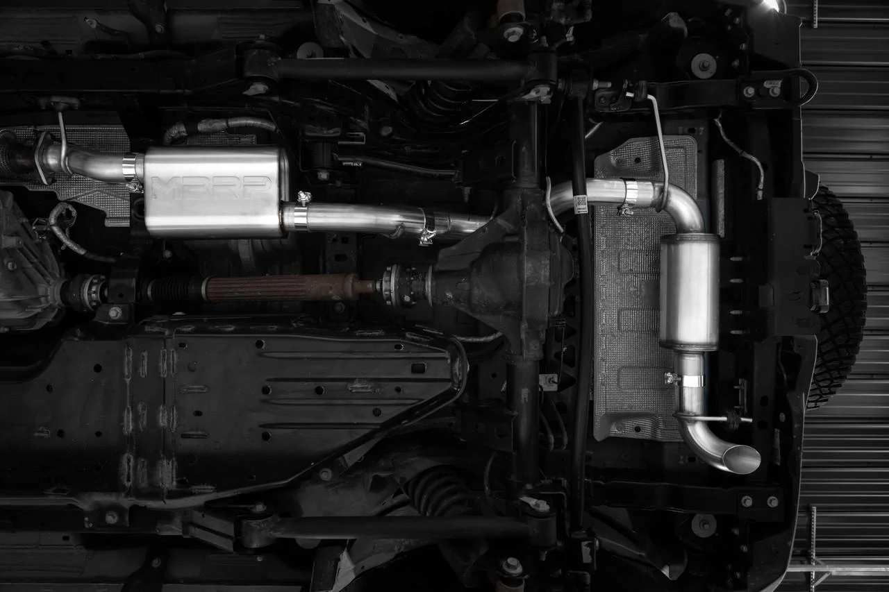

No, the Overland has the extra resonator at the rear so it's a little quieter. With the 2 door, you have to cut around 12" off the pipe behind the muffler since it's made to fit the 4 door with no cutting. Here's a picture of the setup. I like the sound of it, louder than stock but not over the top loud.

You can hear it a little under normal driving but it's not too bad. It gets aggressive when giving it extra throttle but still not overly loud, that's why I wanted the overland with the resonator and muffler. It's probably still a little loud for the wife though (I don't have that problem). Yours definitely sounds louder on pavement but the video with the snow is pretty muted so it's tough to tell.
