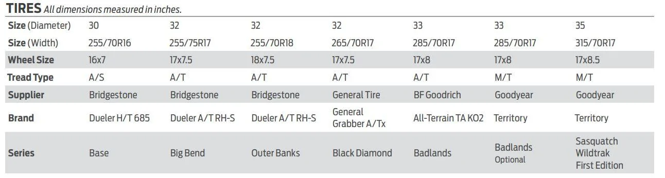

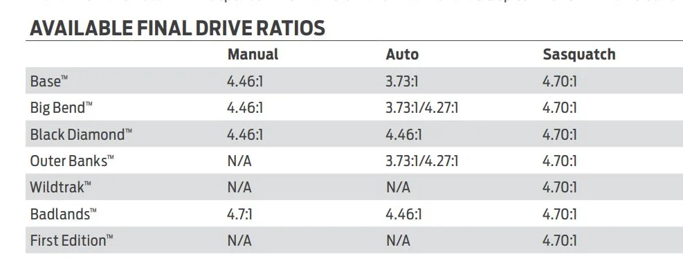

How are you getting that combo without aftermarket parts? the only model with 33"s is Badlands and that has the 4.7. Other models have 30"s or 32"s and 4.46
Ford Bronco Manual Functionality Bronco final driv
Ford Bronco Manual Functionality Bronco Tires

How are you getting that combo without aftermarket parts? the only model with 33"s is Badlands and that has the 4.7. Other models have 32"s and 4.46
I am getting it through aftermarket tires.
Almost everyone getting a Base model agrees that the useless 30" van tires are going to be replaced immediately, or once the originals wear out.
Best guess in the Base model thread is that 255/85r16 ( 33" pizza cutters) will fit without mods.
The much cheaper 285/75R16 is a maybe.
Gonna have to see what the factory backspacing is.
