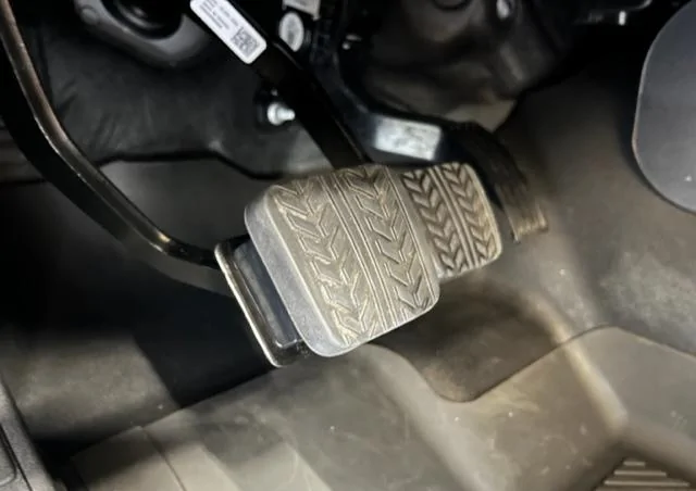

I'm 5'8" and need to move the seat forward (not all the way) to get the clutch to the floor. Right leg is bent up more than I like. I also don't like sitting that close to the steering wheel/air bag.
I've researched clutch pedal extenders but have not pulled the trigger on any yet.
Ditto. I'm almost 5'8" on a good day. I can move the seat forward and operate the clutch just fine. However, just not fond of having my knees close to the lower dash. As for being too close to the steering wheel/airbag, does your BD have a telescoping steering wheel? We simply telescoped the steering wheel forward for more clearance.
To get more lower dash/knee clearance, I fabricated a clutch pedal extender out of 3 slabs of 3/8" aluminum and a flat piece of 1/8" to insert inside the clutch pedal pad. Used the 3/8" slabs so I could easily adjust the amount of extension at a later time if I wanted to. Bolted everything to the clutch pedal like a sandwich using two SS bolts---rock solid. Gives me approx. 1 1/4" of extension. My knees are now a more comfortable distance from the lower dash.

Hey thanks so much for this. Been looking for a solution. Looks like factory. I'll check if I have the telescoping wheel.

So I'm 5'2" and bought a manual 2-door heritage and I love it! However, like the woman pictured above, I sit too close to the steering wheel for safety. I can reach the pedals this way and sit the back up straight for comfort, but I would definitely like to scoot back a few inches. I've looked around and haven't found a good pedal extender online; I may rig one up like the above suggestion.
Have any of you found a good pedal extender for the clutch?
