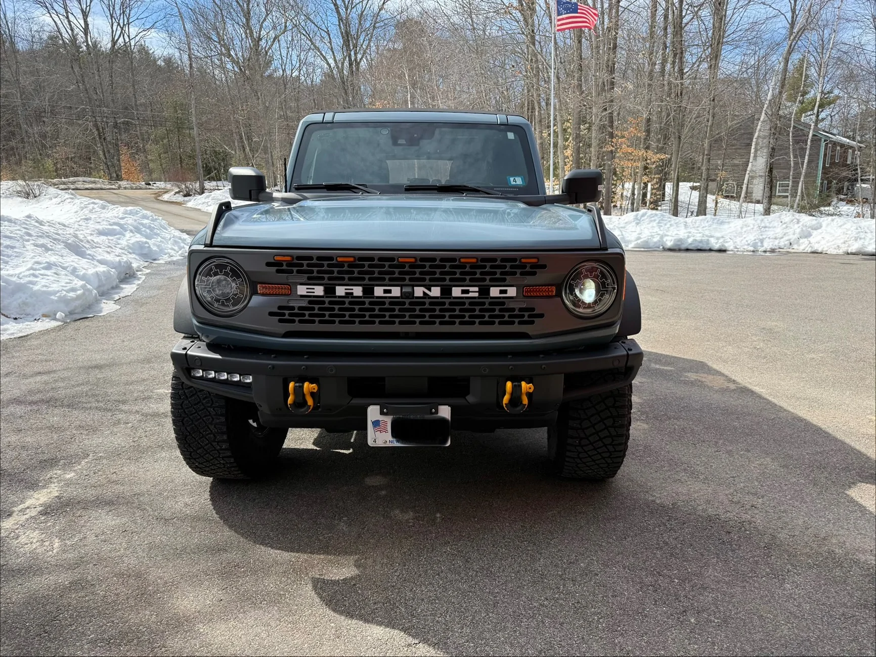

I installed Oracle heated headlights this winter into my 2022 FB Badlands SAS. I recently ordered @Mabett fog lights to install into the modular bumper. I installed one and it took out the headlight, side blinker and from blinker stopped working. Has anyone experienced a similar issue or know a fix, or could it be a bad harness?

If you disconnect the fog light, does everything work as normal again? Try to eliminate any blown fuses, and may want to consider having the fog lights on their own aux switch if issues continue.

Definitely run the fogs on an upfitter switch if you have them. Fogs will last much longer if they aren’t coming on with your headlights every day. The draw from the fogs could be reducing the power to your headlights.

I disconnected the harness from the fog lights and reconnected just the head/blinkernligjts. Everything worked as normal.

If you have factory aux switches, connect them there instead. An alternative option could be a Trigger controller for more aux control as well.
