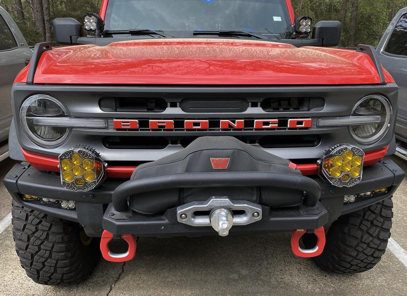

I used the LP6 brackets that came with the lights. For this location, I had to cut the inner side of each bracket to follow the lower valence contour so they could be aimed correctly and not make contact with the paint. Had them installed for over a year with no issues.
Ford Bronco LP6 and mounting options for modular bumper Baja Designs lights 2

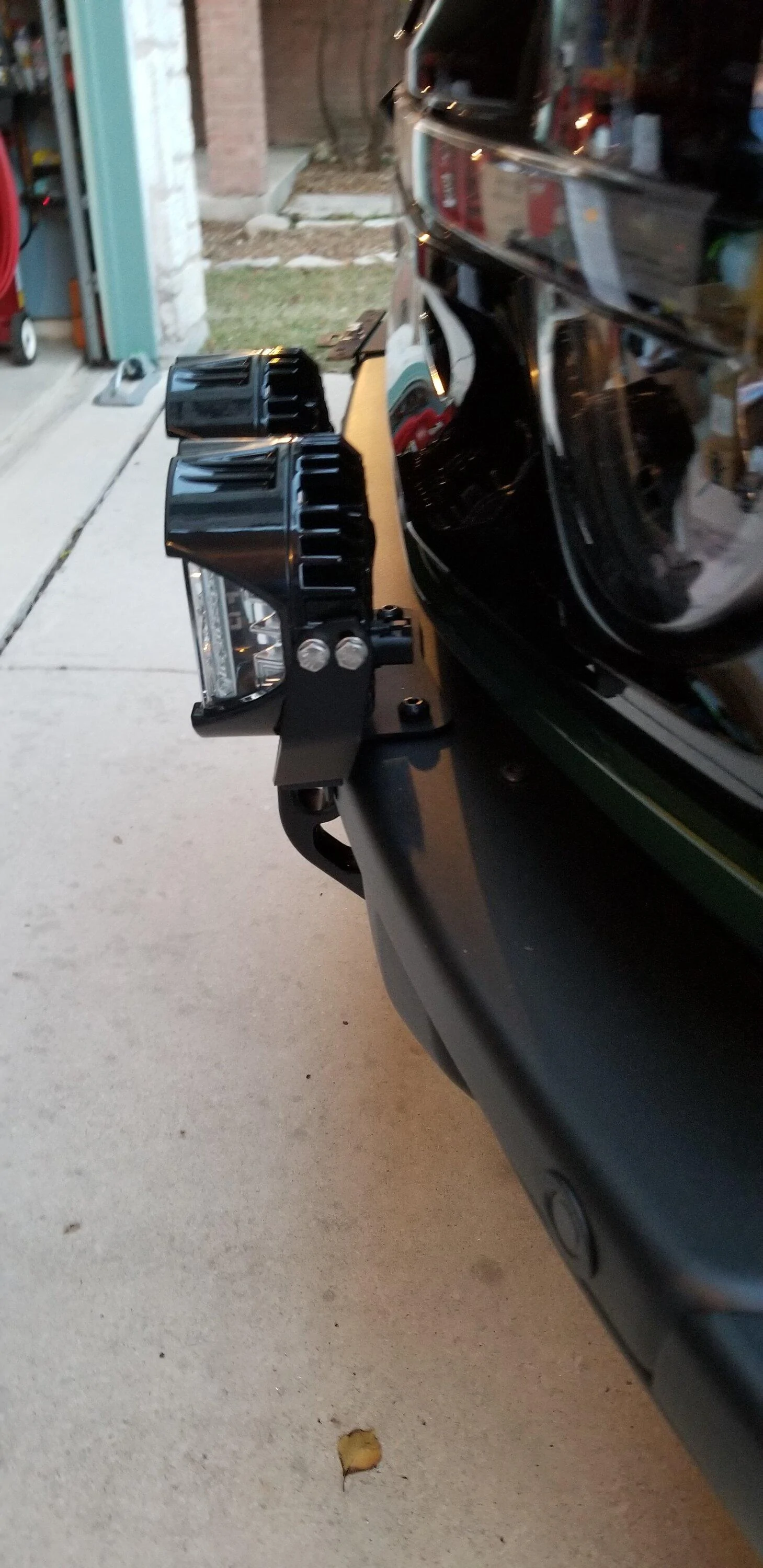

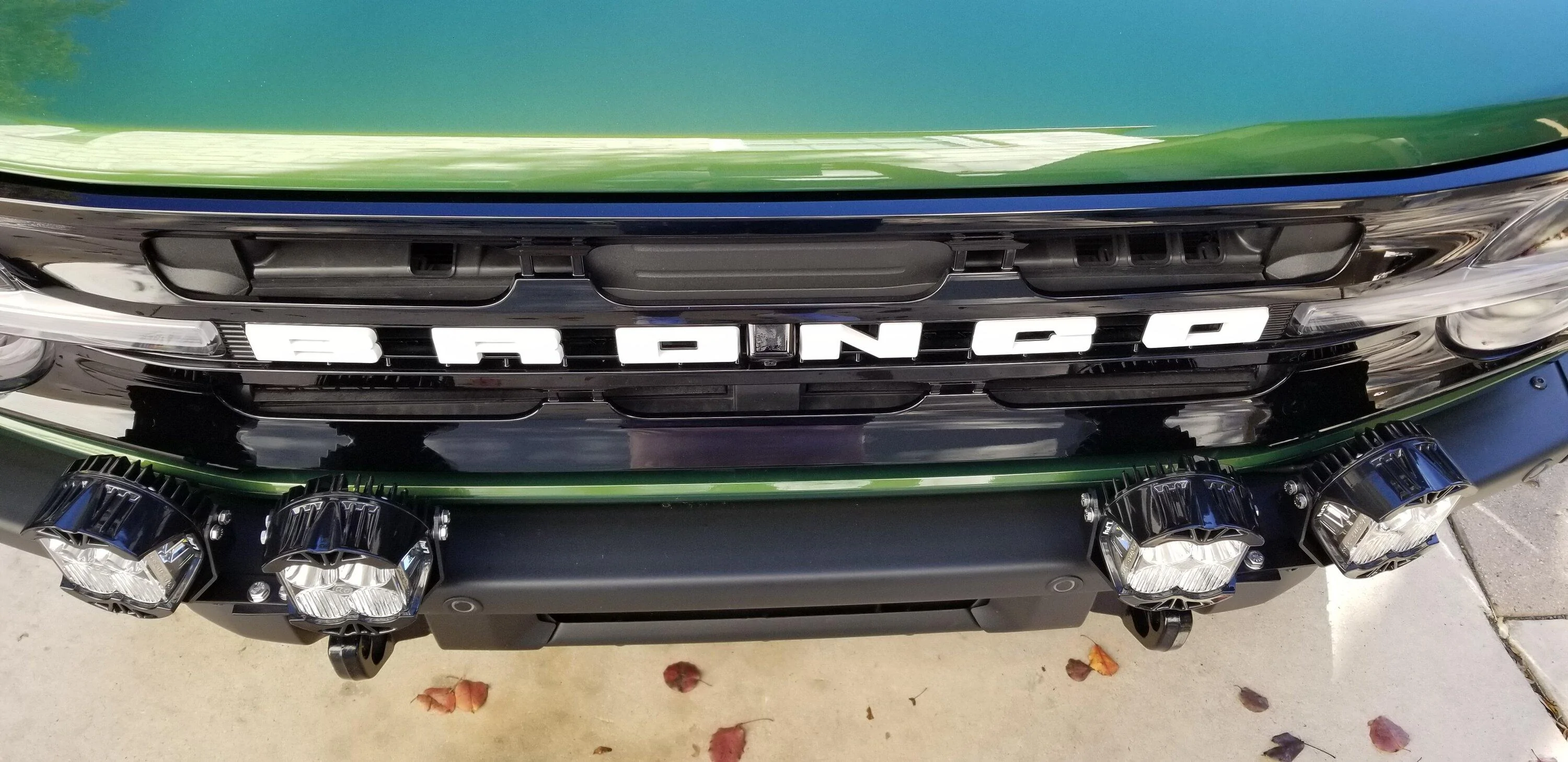

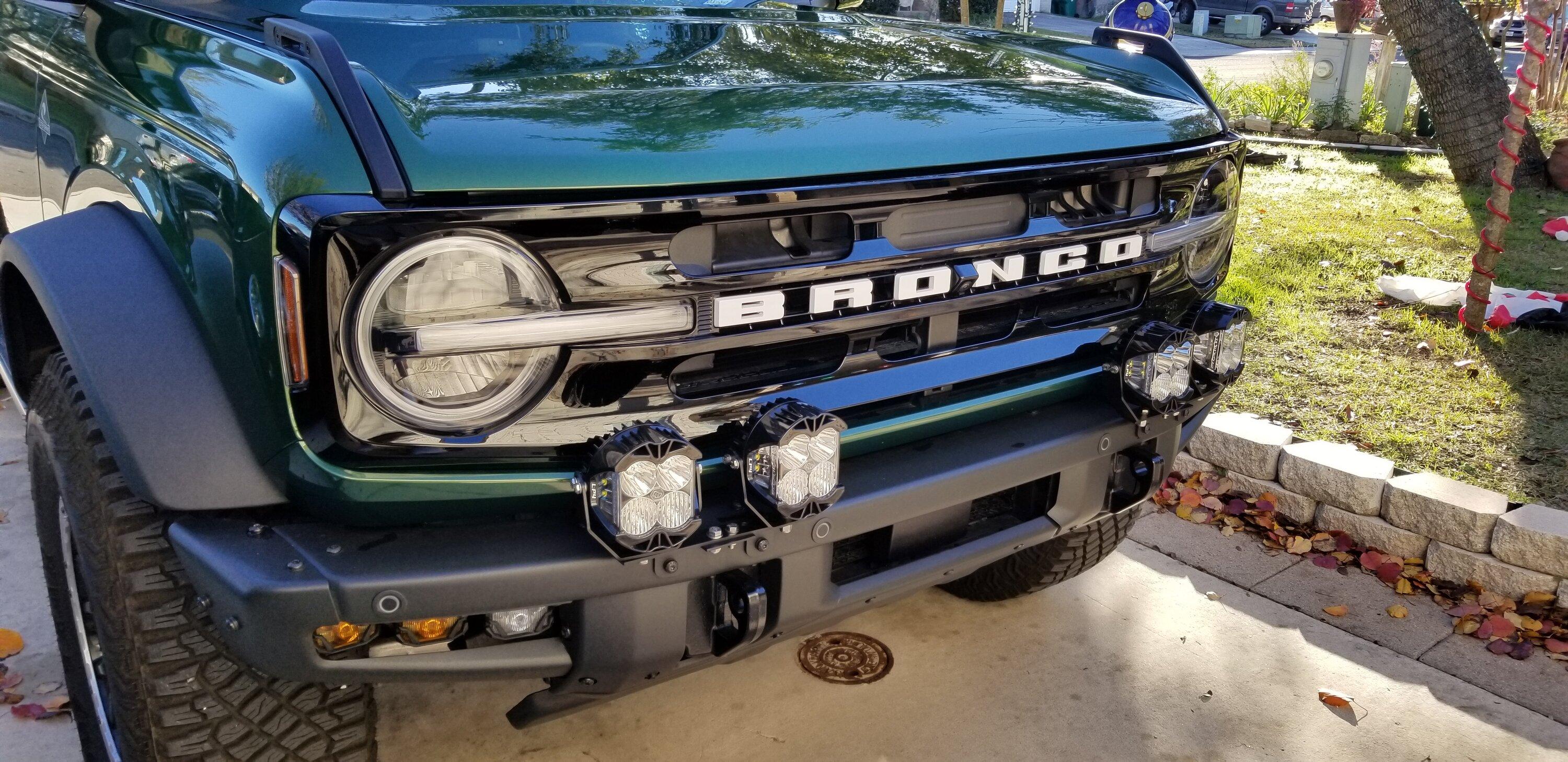

Dang OP...you were going through the same thing as me at the same time. So I am a little late to the party. I also have the SPV brackets. I too did not like how far they stuck out. Also, I wanted to add quad set of LP4s instead on on set of PL6s. So here is what I did.
Ford Bronco LP6 and mounting options for modular bumper 20231220_150044
Ford Bronco LP6 and mounting options for modular bumper 20231228_135832
Ford Bronco LP6 and mounting options for modular bumper 20231220_174139

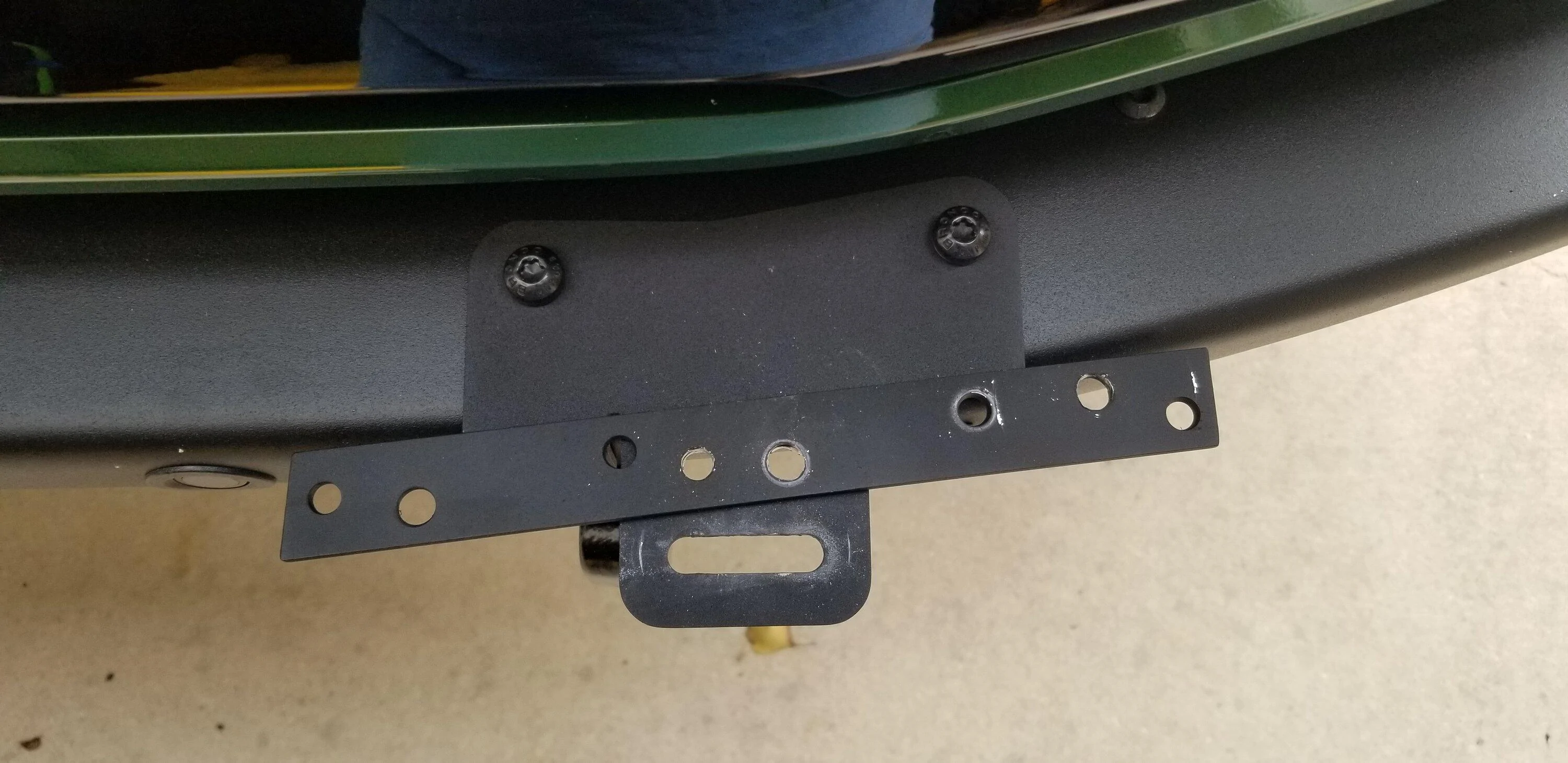

I'm still in the testing phase. I cut the excess from the SPV brackets and drilled holes so I could angle the bars to give me a staggered look to match the bumper. So far the brackets don't rattle nor bounce. Once I am convinced I have everything just right, I will take the brackets off and use them as templates to make new bars and the weld them to the SPV bracket, that way I end up with just the bolts for each LP4.
Ford Bronco LP6 and mounting options for modular bumper 20231224_160748

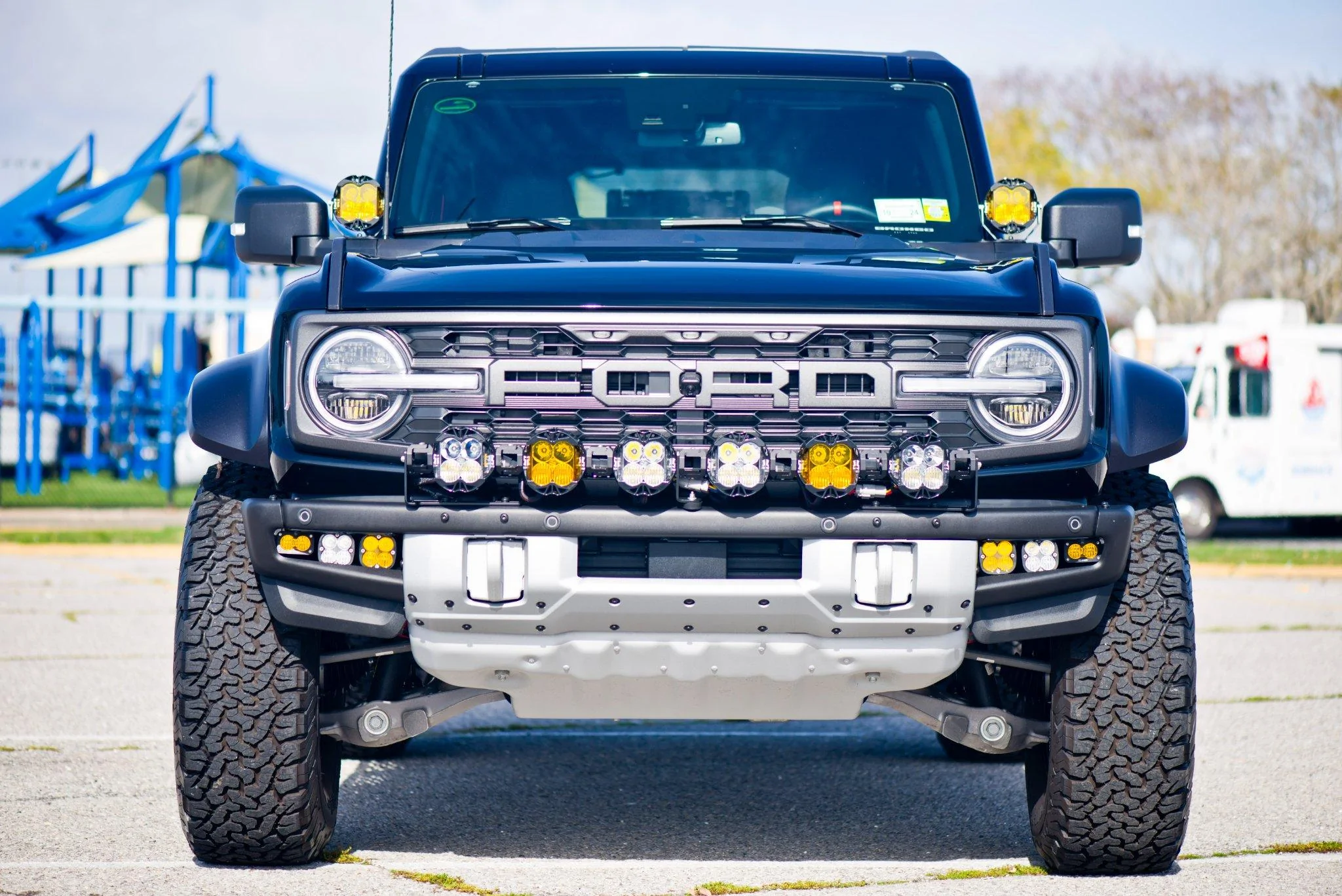

At that point you shoulda just went with our LP4 Linkable kit :)
https://www.4x4truckleds.com/lp4-li...4-pro-for-2021-ford-bronco-hd-modular-bumper/
