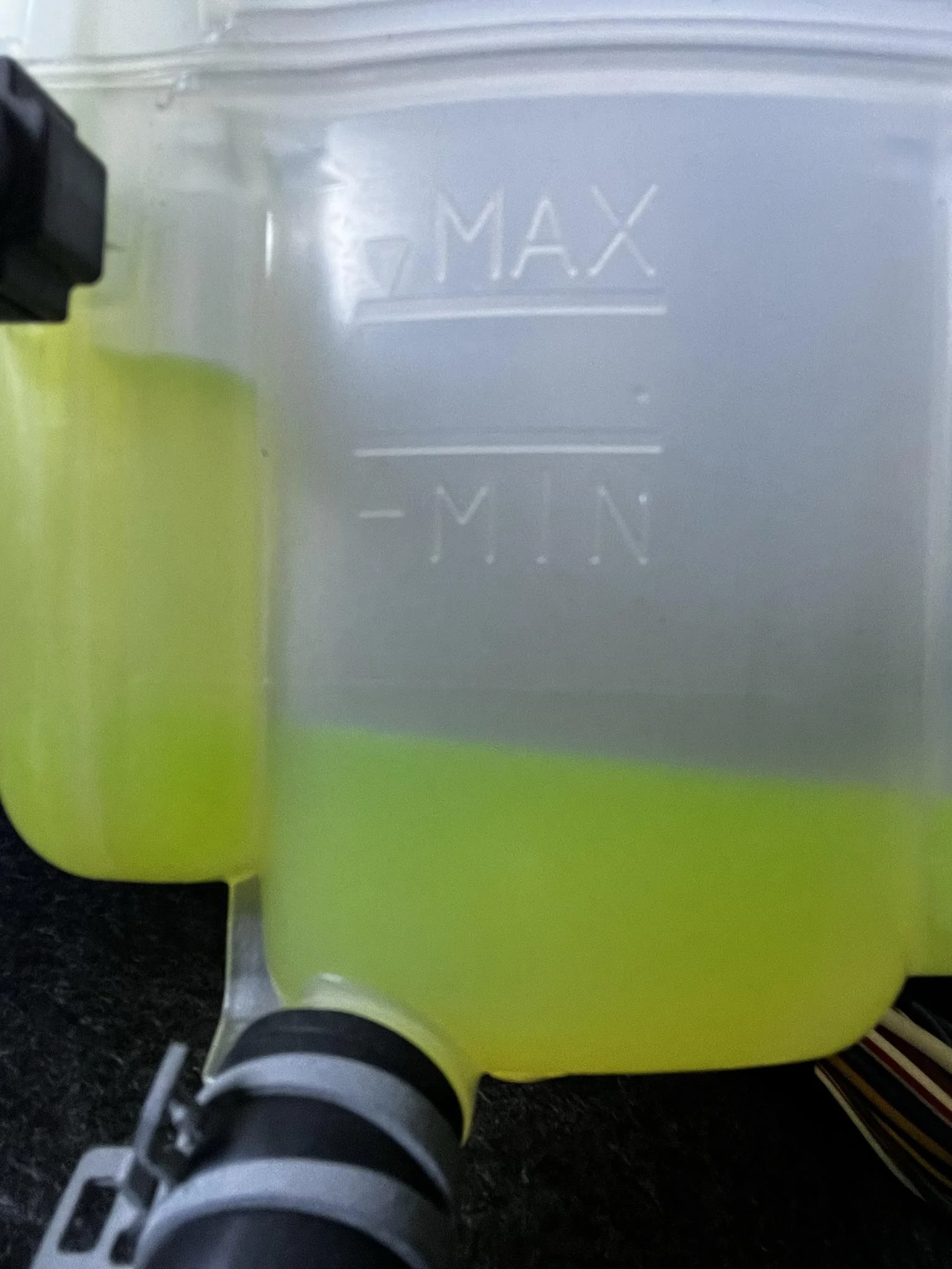

I decided to check my coolant level today because of all the murmurs. I have had mine for about 3 weeks and 800 miles. When I looked cold it was a little below minimum level. Below the bottom line. So I heated for 10 mins like the manual says and the level came up to just below the max line. So it's fine. Do not put more coolant in until you warm your vehicle up. Yes I know it's been stated before. But you know, better safe than sorry. Didn't think we needed do not eat warning labels on Tide either. But here we are....

Per the manual you are supposed to read the level while cold. Where did you see anything about warming up the engine??
CHECKING THE COOLANT
When the engine is cold, check the concentration and level of the coolant at the intervals listed in the scheduled maintenance information. See Scheduled Maintenance.
Note: Make sure that the coolant level is between the minimum and maximum marks on the coolant reservoir.
Note: Coolant expands when it is hot.The level may extend beyond the MAX mark.
If the coolant level is at or below the minimum mark, add prediluted coolant immediately.

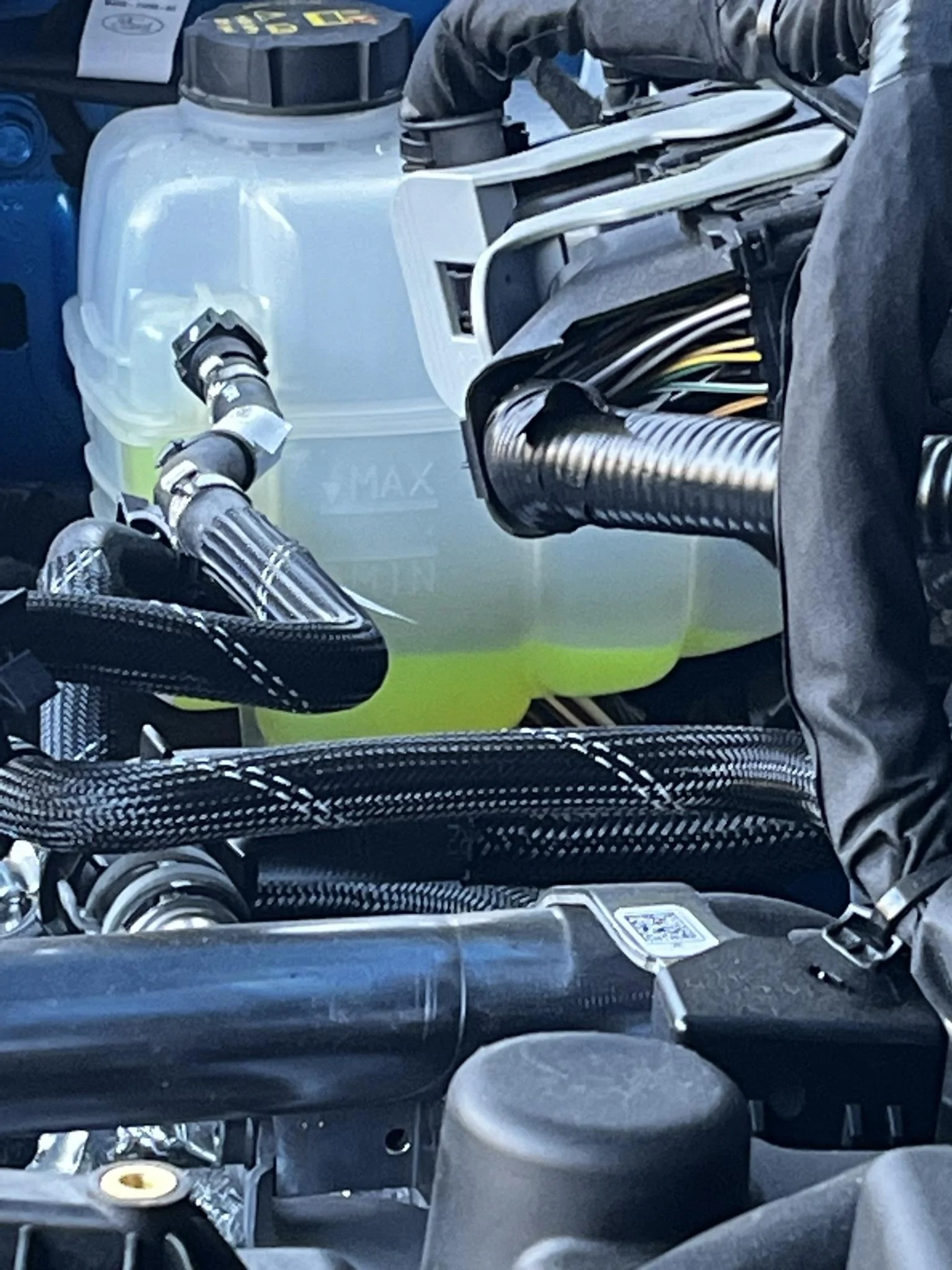

I know this is an old thread but it's still relevant. I just checked the level in my 22 Black Diamond and it was way below the MIN mark. I hadn't driven the Bronco in a couple of days but thought I'd check fluid levels before taking it for a drive.
