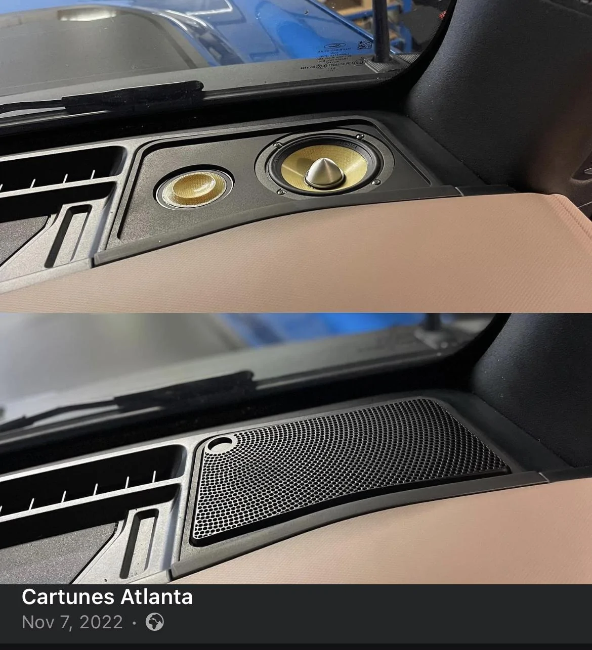

awesome setup. Few questions if ypu don’t mind.
- I only see the one 300x1 amp. How are you powering the five channels? The Helix DSP is the Amp as well. The other is for the sub.
- not familiar with that dsp how does it compare to the jl audio built in dsp in their amps. Everything I read lead me to the Helix although the JL was my second choice.
- any other photos of the gear install thats a lot to cram in with those crossovers? I can take some this weekend.
- did they run new speaker wire? I don’t know

Are you using the passive crossovers that came with the three-ways or fully active? Fully active
@Murph914 the Helix in his equipment list is a 12ch DSP amp. I'm guessing that's powering everything except the sub.
That is correct

Would like to hear your impressin of the kicker sub, same one I was planning on going with. Maybe some install pics if you have them.
I’m very very happy with it. I’ll take pics this weekend.

Id love to pick your brain on your 3D printed speaker grilles and mounts. Can you guide me to where you got them? Or where I can buy the .STL files to print them myself?

Best component dash mount I’ve seen. Do you know how much they had to cut the dash structure to fit the speakers under the grill?

Does anyone have the STL file for that front speaker grill?

How did you wire the 3 way crossover for the KX3, since the kick panel and dash corners are on separate channels?
I don’t. Sorry.
I don’t have it. I bought from Cartunes in Atlanta if you want to try to contact them.
