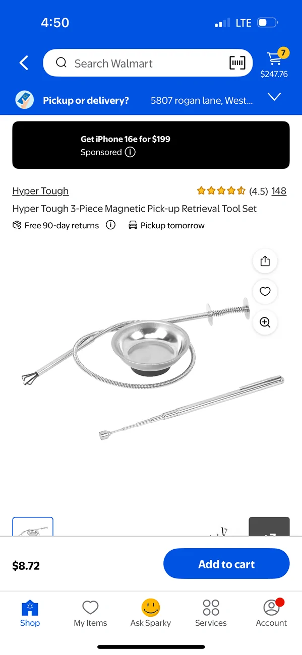

The roll cage structure there is just an empty tube - nothing inside. Do you know where the nut currently sits? The hole on the side of the cage near the front (green arrow) is a bit larger than the holes on the top and looks like a good access point. Maybe shine a light in one to the top holes and use a stick to try and kick the nut & bolt forward until you can use that forward side hole to grab them with a magnet.
Thank you sweet 8lbs little baby jesus!
I picked the kit up at Walmart below and since that hole is in the side of the roll bar I was able to get them out in less than 2 minutes.
now I feel like a schmuck living with that awful rattle for these last couple months.

Nice work! I‘ve done my fair share of dropping fasteners where they ought not to go. Those retrieval tools are a must have!
Also, if you do not have a borescope, a small telescoping mirror can be a useful tool to have.
