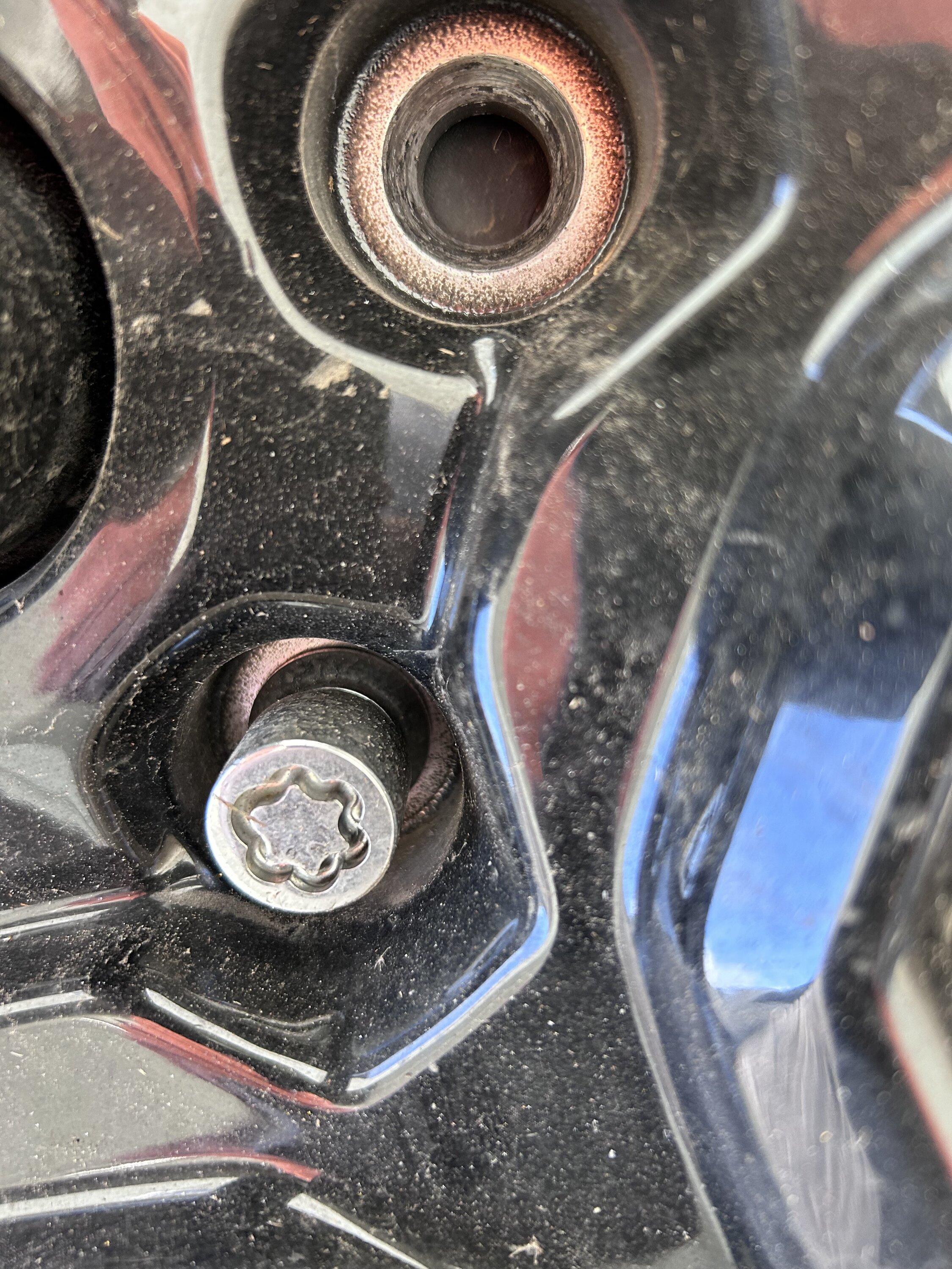

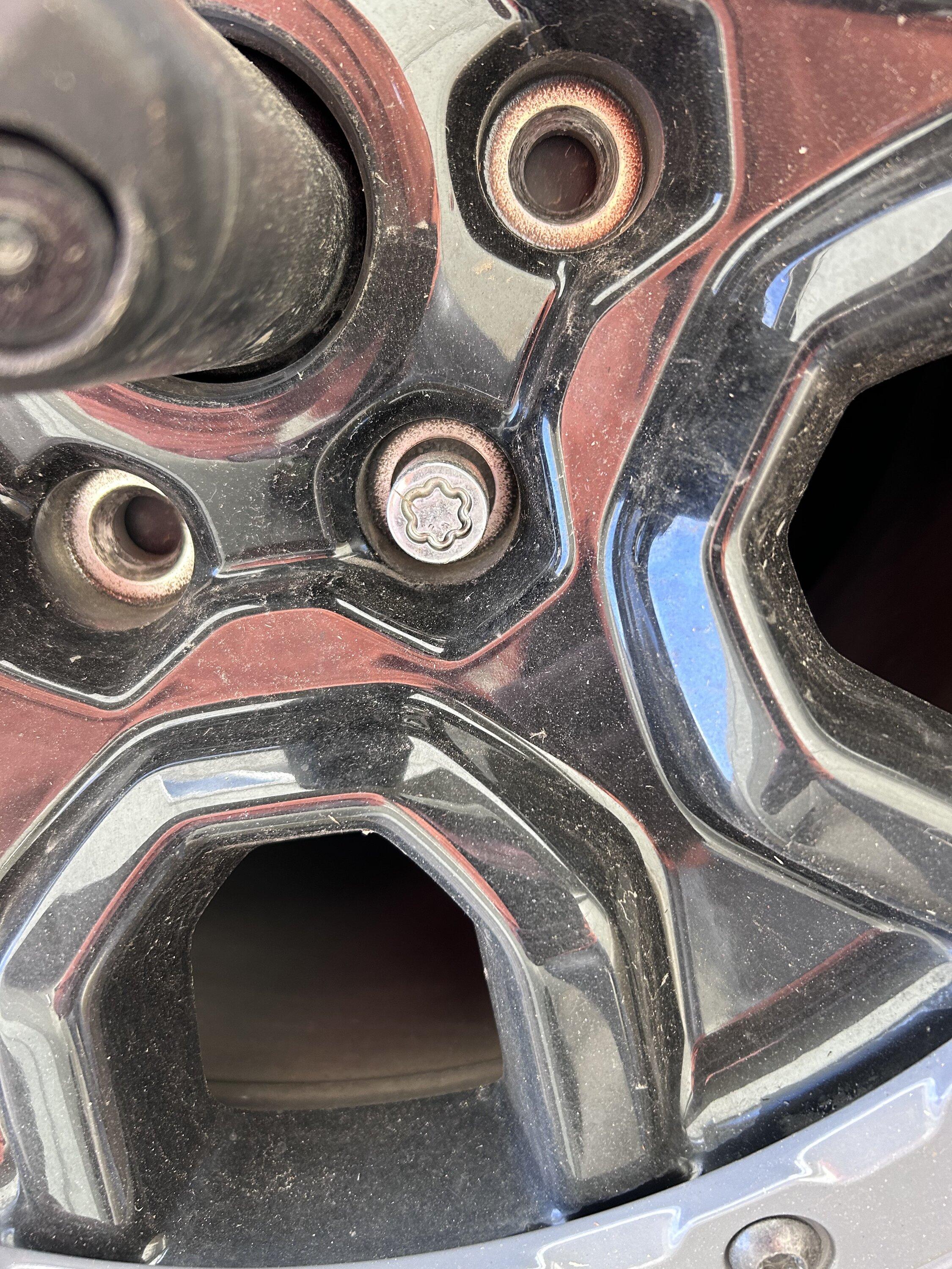

Lost locking lug nut key, anyone know model #?

I think the answer is in your own post. You mentioned that the tire shop “…. later they found one they had and were able to rotate all 5 wheels/tires.”
if you can, bring it back to the same tire shop and ask them to remove the locking Lug nuts. Since they did it before, they should be able to to do it again. Then - Purchase a new set of locking Lug nuts or regular non-locking nuts and put them on. That might be the easiest and cheapest way to get this fixed.

They were the Ford Locking set that came with the Bronco for Free(along with mudflaps that don’t fit Sasquatch). Didnt realize this Could turn in to a hassle, just thought I could order a replacement. I gotta look and see if I stashed the lug nut package somewhere?
You can order a replacement key from the vendor. You’ll need to know the manufacturer and key number. I had to overnight a key from McGard once and since you’re in no rush this is the best method outside of locating the lost key.
https://mcgard.com/customer-service/order-a-replacement-part-online-now/

or ask the shop for the ID of the master key.
i recently had to replace my locking lugs on my other vehicle since the tire shop that put new rubber on those wheels got a bit happy with the impact wrench and way overtightened the locking lugs.
they distorted the key and it shattered when i was swapping to my winter wheels.
turns out the complete set of vw/audi master lug keys are available on amazon if you can identify it.

If it is McGuard, you email them a picture of the pattern and they will sell you the correct key.

Check your glovebox for McGuard registration card or id/sn card. Ford should have included that in your owner papers.
