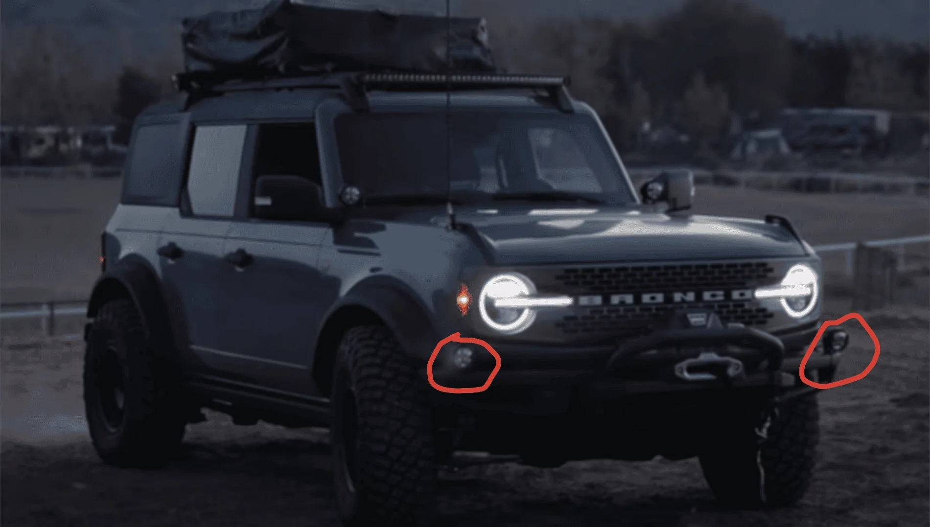

btw, this video is what gave me the idea of the pods on the front bumper as fog lights:
about 2mins in.

And I’m certainly not paying $650 for those pod lights. I’ll buy the 6” KC slims for half the price.
The great thing about BD is it comes standard with the aux switches too so makes it easier to do a clean install on any light you want to put there. The price Ford charges is hilarious but they will still sell a ton of them.
