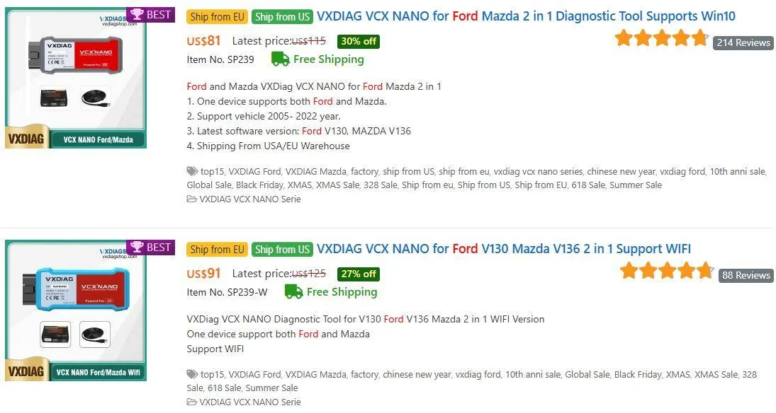

Is it the blue V130 model?
I have the non-WiFi gray model. I think that’s the only difference between the two you show there - but yes I believe that’s the model I have and it’s worked for me so far
