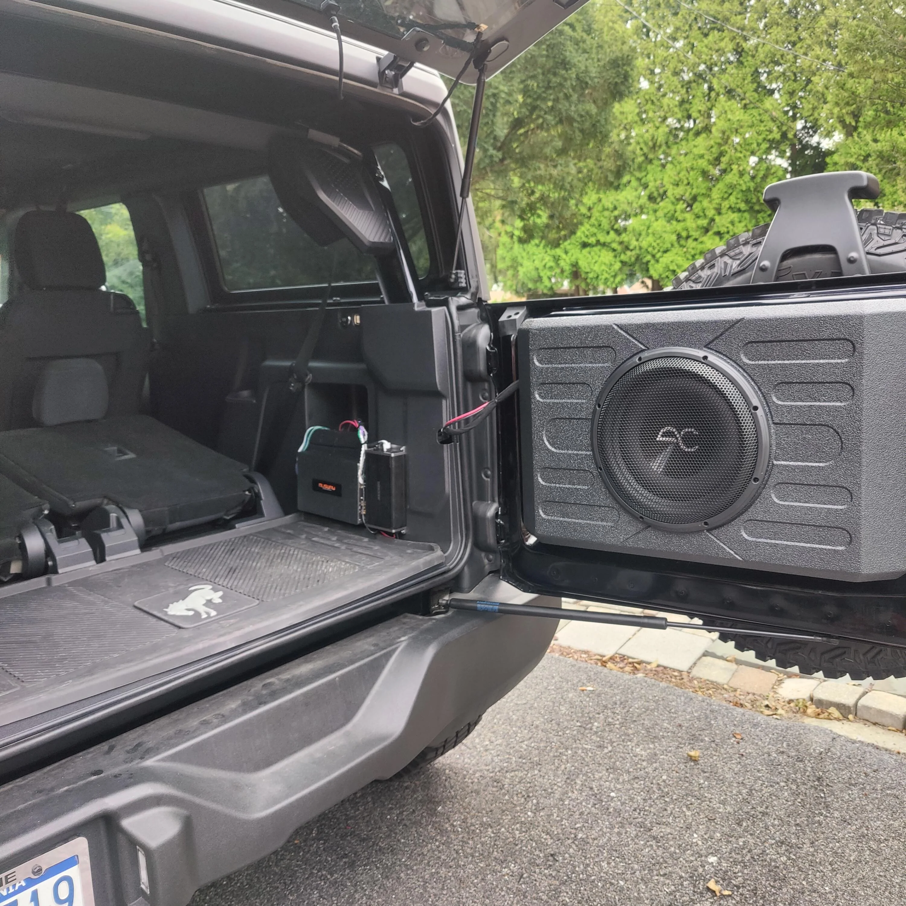

audio project pretty much complete now. Kicker ks 4" with bass 600hz blockers in dash, kicker 6.5 ks in kick panels, kicker ks 6.75 in the mabett pods in back and the stinger tailgate sub. Museway 400 powering the speakers and kicker 500.1 powering the sub.
Took me and a buddy a entire day but we got it done. Ended up mounting the amps to the side panel so I can mess with settings instead of bhind the trim. Just need to tape up the wires a bit.
With volume at 16 we were in range of 94-127 decibles with a average of 102. To put it this setup absolutely slams. There is no rattles to chase and overall im very happy with this set up.
thanks to plugandplaykits and everyone else for the input.
