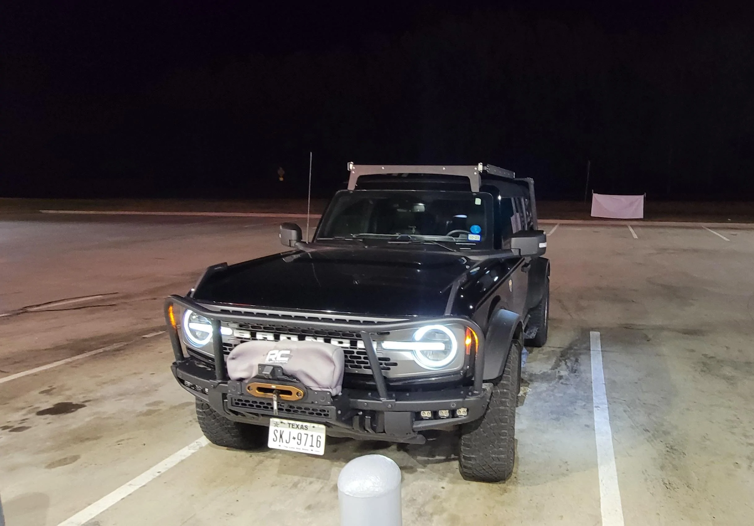

For what it's worth the jcr bull bar fits without modification with the rc winch mount

Yes, comes in 4 main pieces. the pushbars are welded to the headlight loops. the 2 cross bars across the center are bolted on. There are 4 support brackets also, 2 attach to the back of the Mod bumper and connect to the crash bar mount (if you are Sas and don't have crashbars, thenn you also don't have the bolts to attach these brackets). I have the RC pod-light mounts in the corners of my Mod bumper that get in the way of the frame brackets. The other 2 brackets attach to the bottom of the headlight hoops and to a factory bolt on the Mod bumper to reduce vibrations. I do have those installed.
I have very pleased with this grill guard. looks great from every angle and since it is bolted together, I deleted the lower cross bar since I have the RC Winch mod attachment. I love the combo look this gives and very pleased with the discount I found on amazon for price. (Scroll up to find the link).

I researched them all, including this one. Looks like they styled it after the ARB bumber. I am not a fan of the look Function is better than the westin, but I personally think the fashion won out on the Westin.

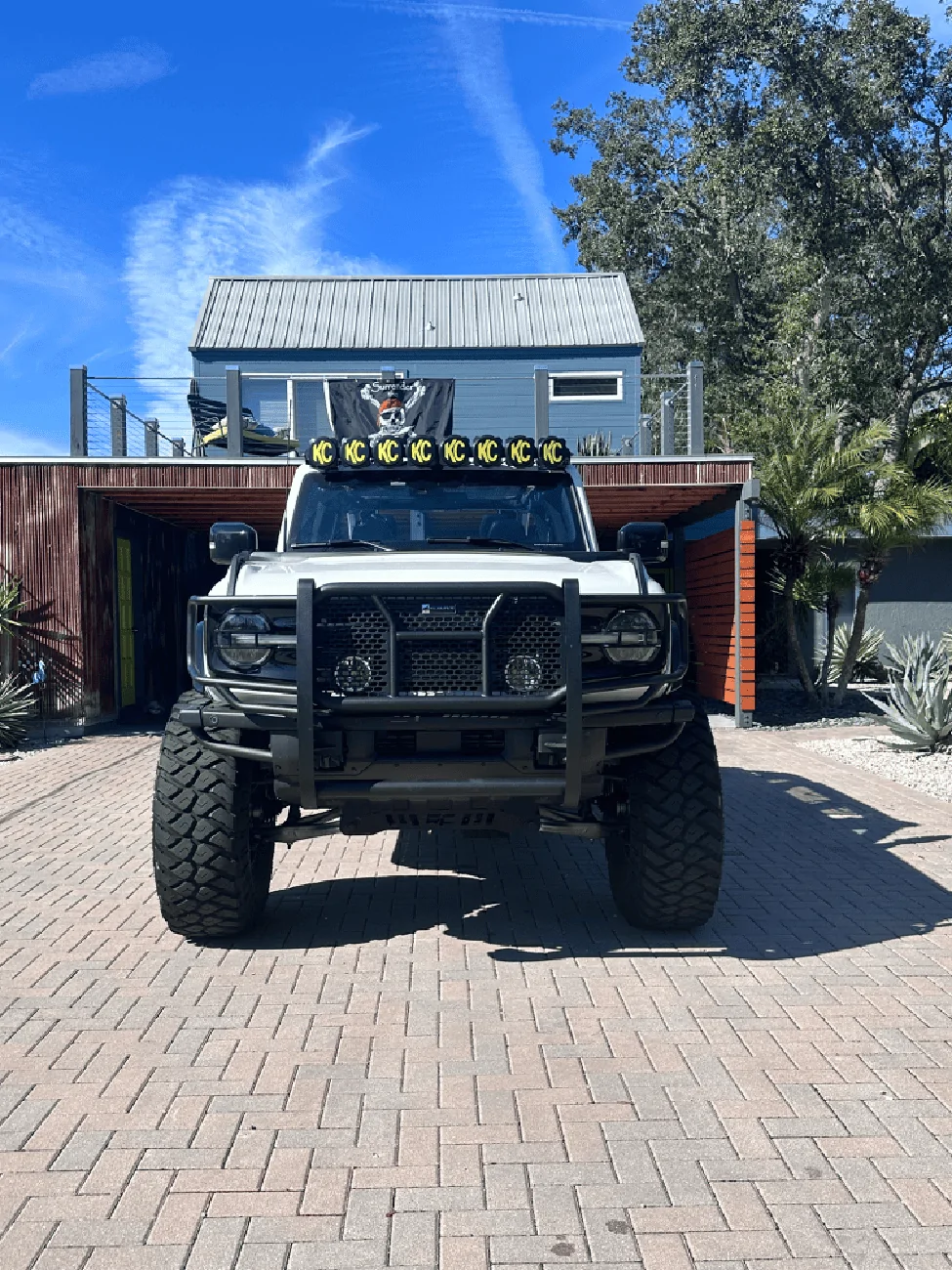

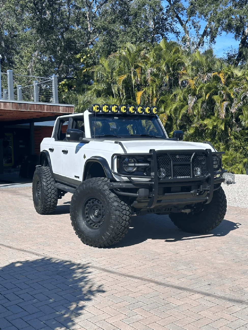

That looks awesome. Is there any way to fit a winch with it? As in adding a high mount plate?
That’s a great question. I’m not entirely sure. The middle grill panel can be removed to give you open access and there is a a little bit of room between the grill and guard as you can see by the full size pod lights tucked in there.

Great. Thanks for the reply!

With how mine sits I would say no on the high winch mount.
