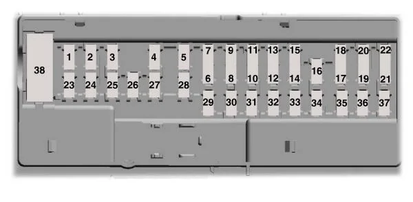

This is from the Brandmotion rearview mirror installation. Both constant and ignition fuses under the steering wheel.
