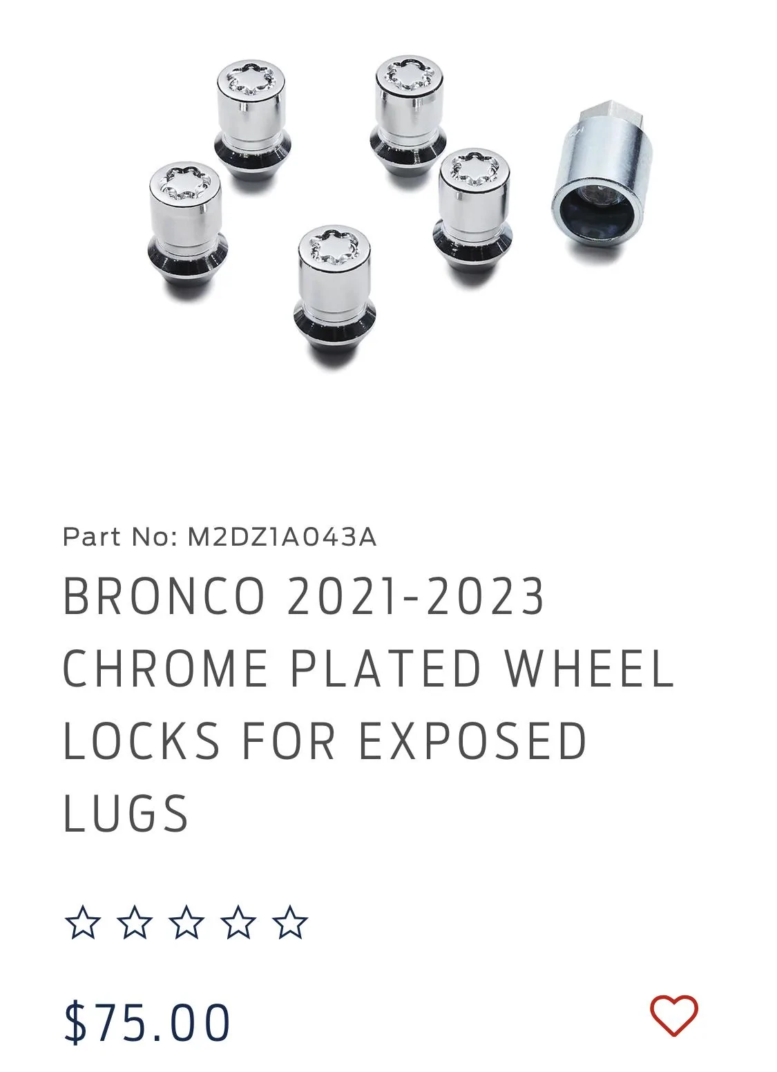

I bought the Ford 5-lug kit and threw it on. A bit high priced at $75, but a little harder to steal now. Looks good too
Ford Bronco Locking bolts for the spare wheel? 63A42440-9A03-4F83-BF67-25C8C71E6058

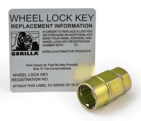

I got my son some Gorilla Guard Locks for his rims and I'm pretty confident they'd be damn near impossible to steal. With most wheel locks the outside of them are keyed different, all you'd have to do is hammer on a socket and they'll come off. Hell they sell special sockets at auto parts stores to take off the lug nuts for those that "lose their lug nut key". I like these because the outer portion of the lug nut spins freely so even if they hammer it on, its just going to spin, won't grab the inner portion. And the distance between the outer and inner portion is so small that only their thin-walled socket will fit. Will be getting these for the Bronco eventually.
Ford Bronco Locking bolts for the spare wheel? Screen Shot 2023-02-24 at 8.51.30 PM
Ford Bronco Locking bolts for the spare wheel? Screen Shot 2023-02-24 at 8.51.39 PM
