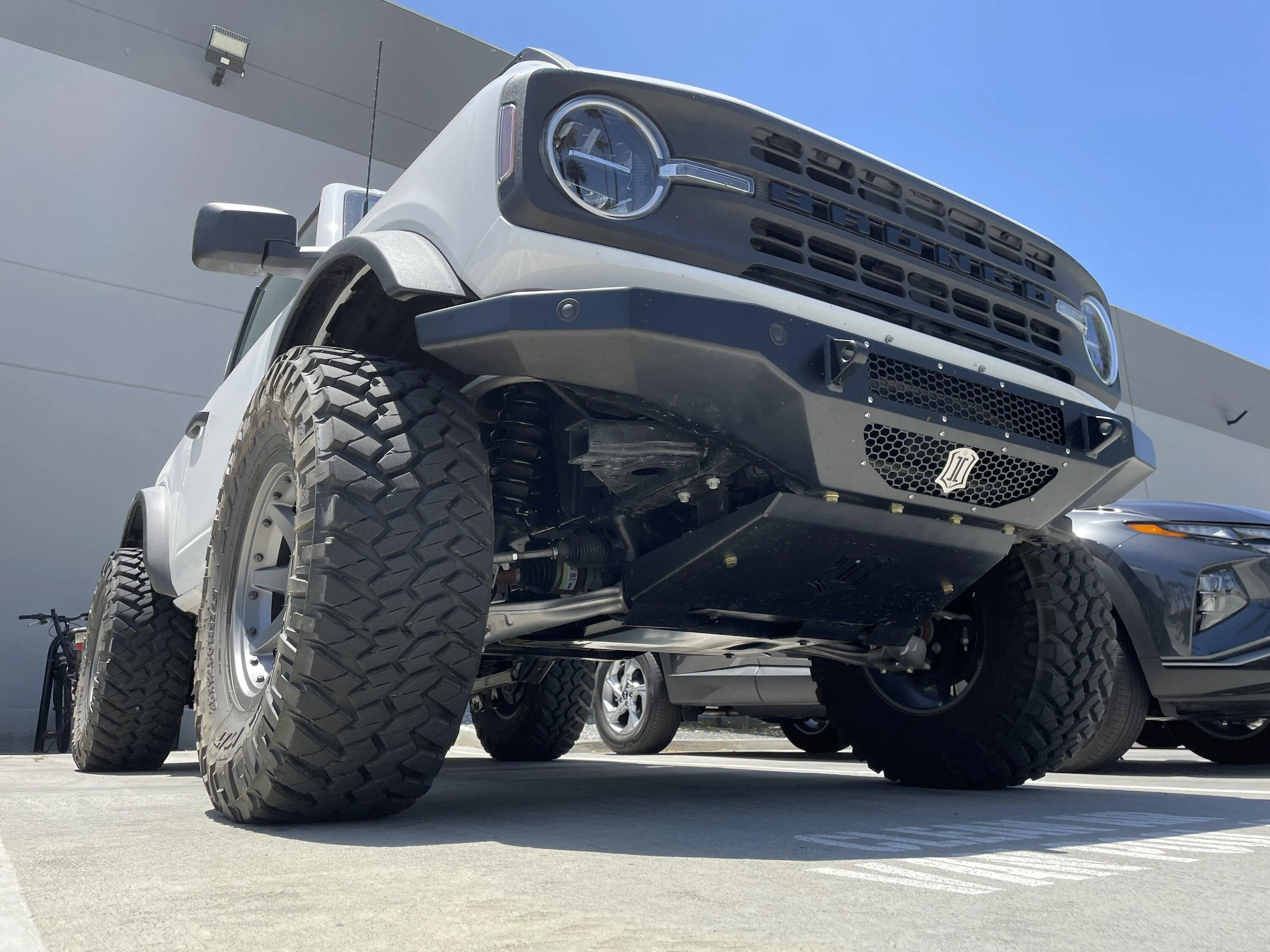

Looks bitchin' Chris! I need this to cure my crash bar reveal from my Icon bumper LOL.

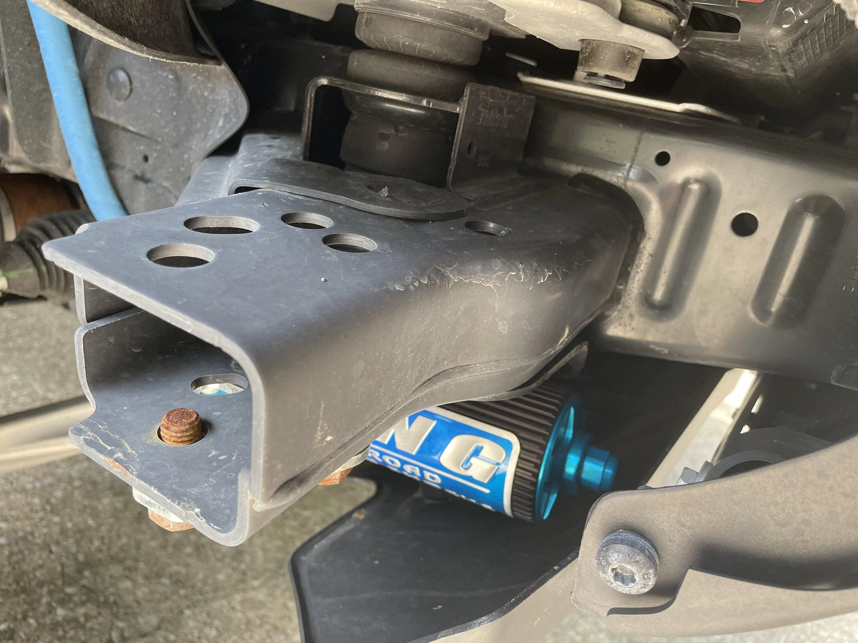

Have you installed on any Bronco’s with coilover remote resorvoirs?
They usually mount to the crashbar ears.
Just wondering what mounting options are left.

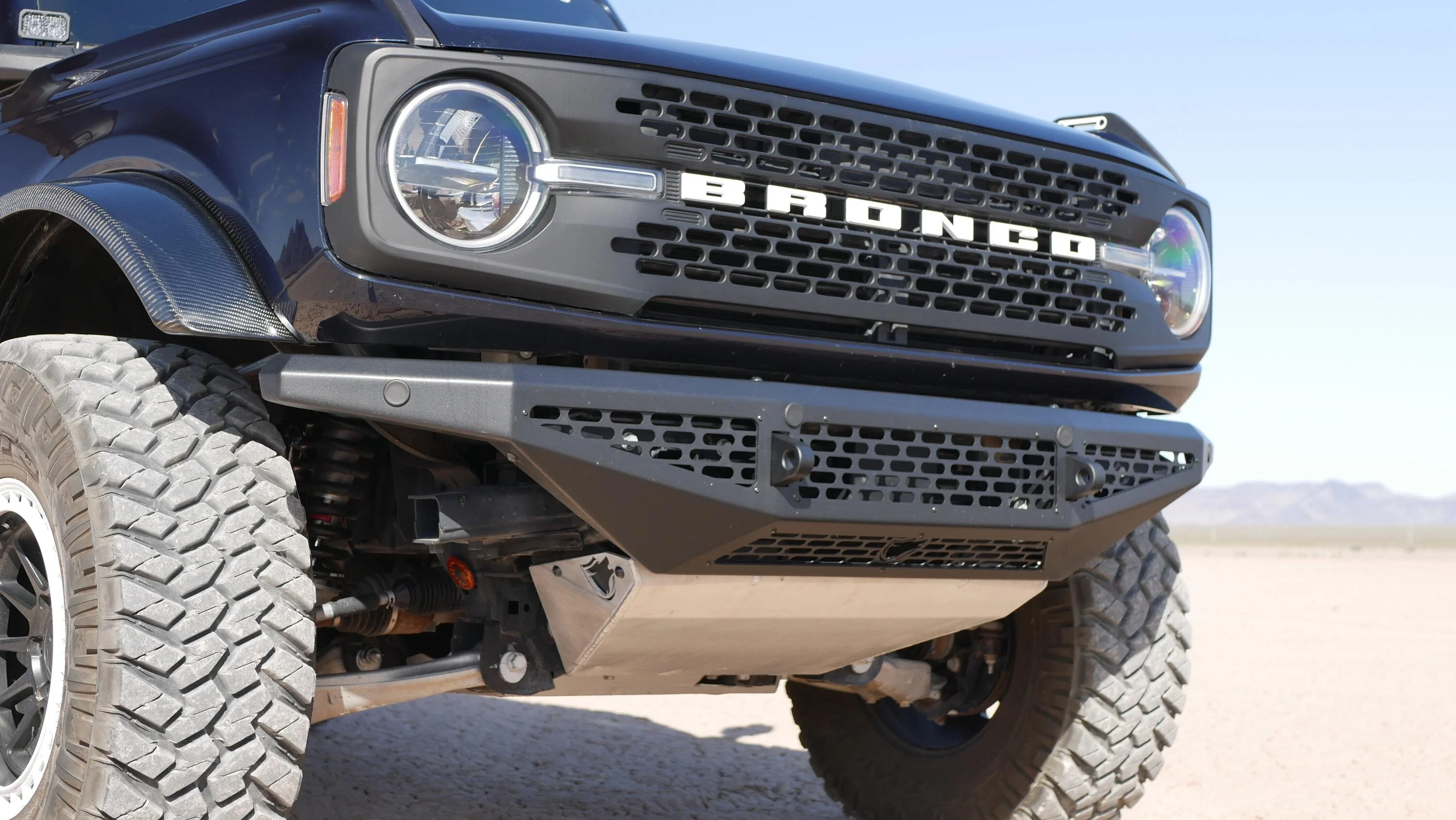

Looks awesome! I'm glad it doesn't utilized the Intercooler/skid mount bolts, like the other options. I didn't want to lower my already high clearance bumper thats also from Lobo! Been waiting for a all-in-one solution like this! The factory crash bar mount kills the look of any aftermarket bumper. Nice job!
