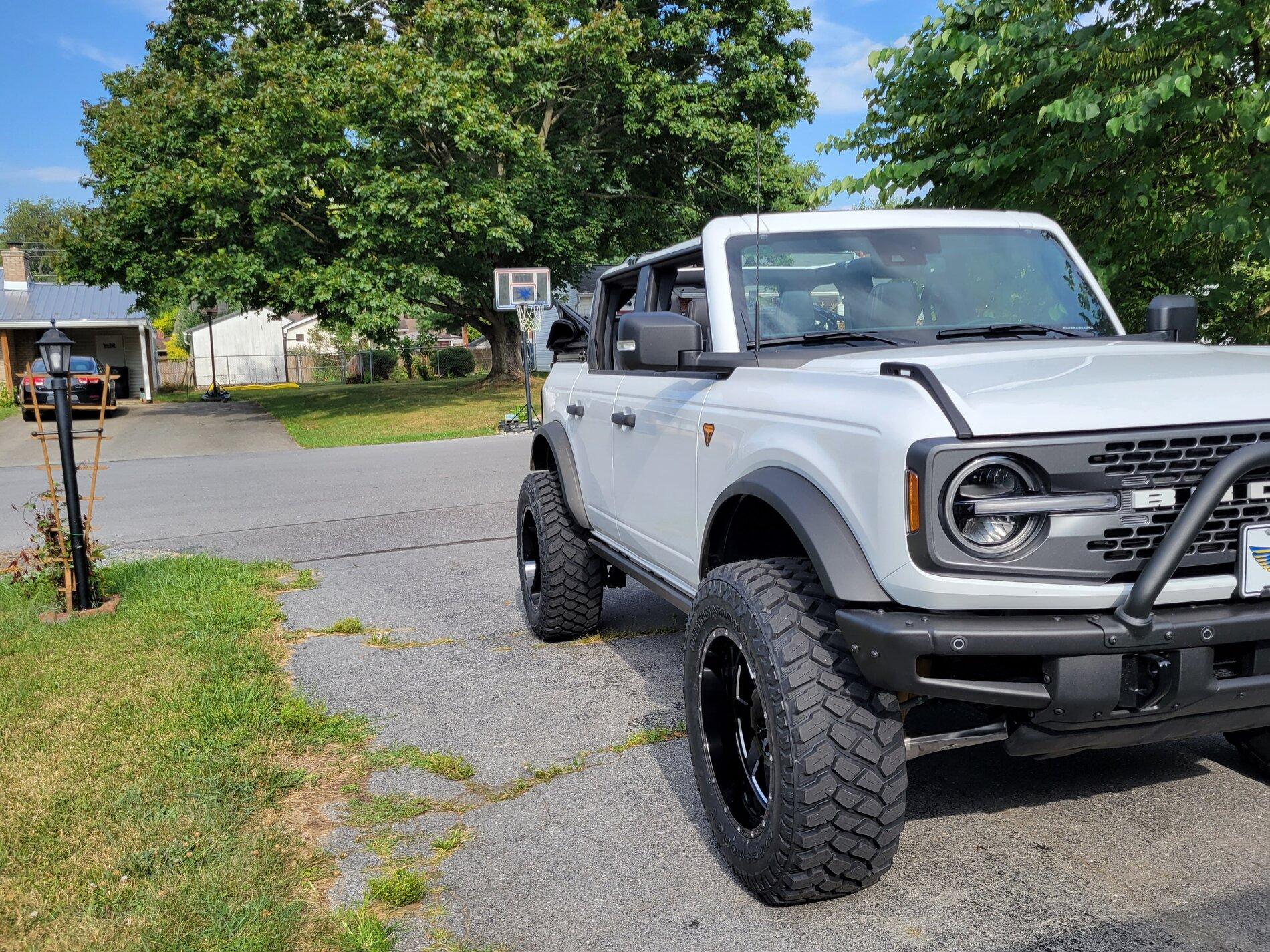

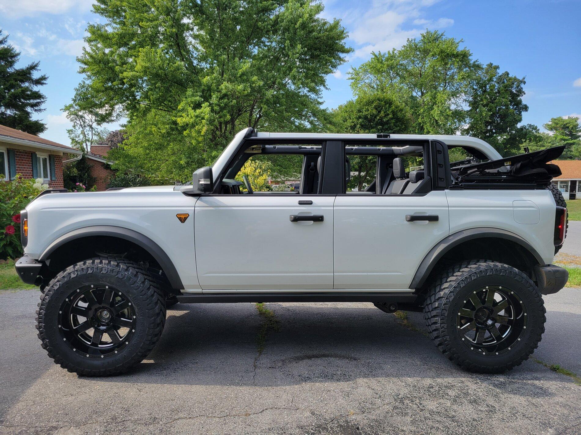

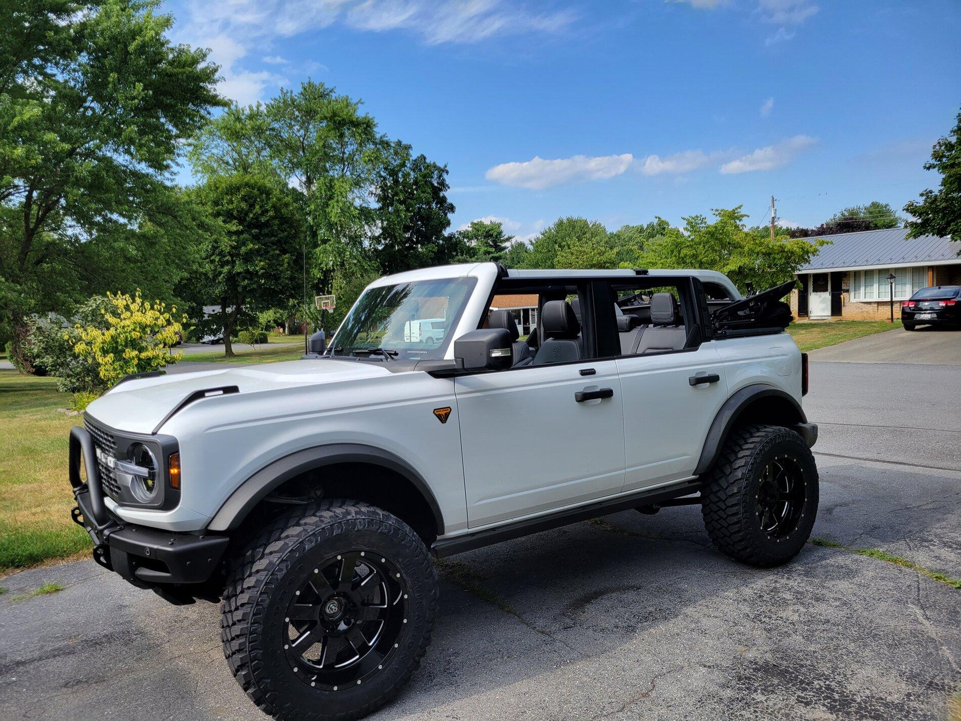

Yes it is a spacer lift. Everyone claims i could spacer it a inch but not 2. So I took the gamble. I guess we'll see, lol
