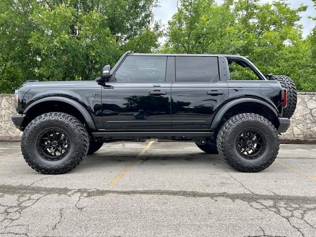

Probably a not so smart (didn't say stupid) question but have been thinking of switching out the factory SAS Bilstein's and putting Icon's on it. I have a 4" Maxlider lift but am wondering when selecting right Icon's do I go with the 2" lift one or is there a standard one to use?
Second part of the question is since the 2" one is sort of (from what I am reading) a 2" lift will it possibly help support the stance a little? Since my lift has settled some I get some rub at full lock on my wheel liners that I didn't get when first lifted. Was hoping that maybe I could gain 1/4 to 1/2 inch of height with the taller shock and my current lift.
Lastly, will the Icon's give any better ride/dampening over the factory SAS Bilstein's?
TIA, Dave

17x9 with zero offset purposefully so it doesn't rub and didn't when first put on really. Keep in mind I bought and lifted it in April and just rolled 3K miles so I am not really rolling with it. 37x12.50 Nitto Trail Grappler MT's
