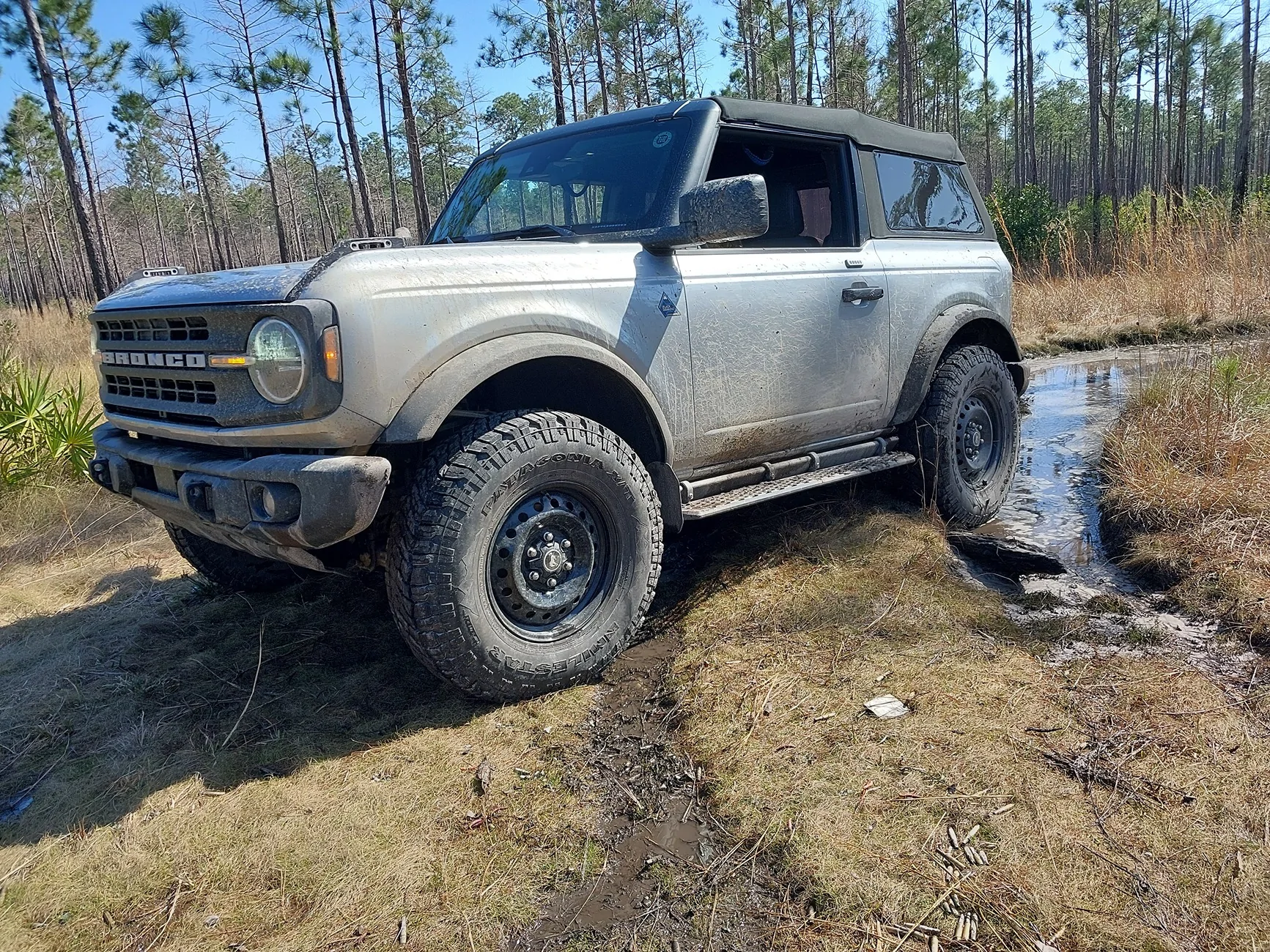

I still have the stock KO2's on 17x9s. I used the Rock Krawler 1" level kit.
Rock Krawler Ford Bronco 1.0" Adventure System
Ford Bronco level kit for 2021 non sas badlands stock 33s

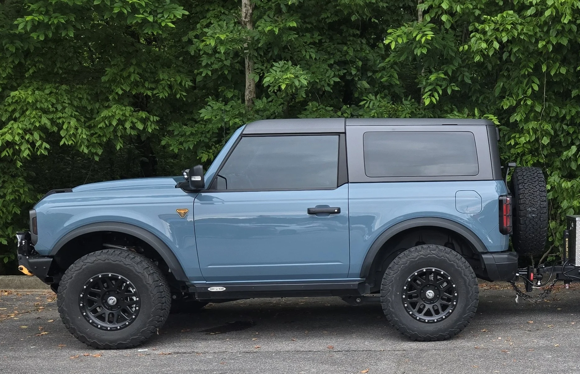

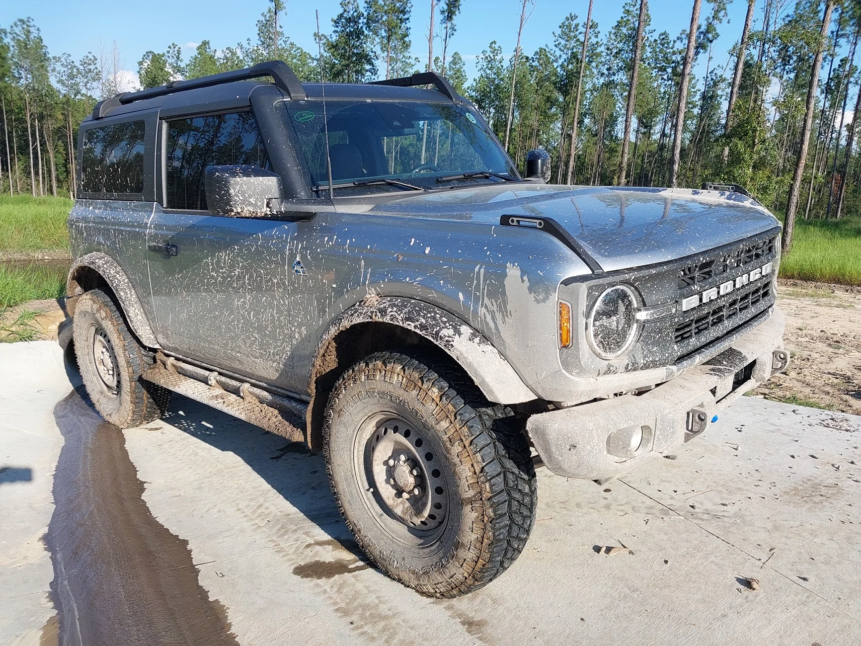

I ran true 34s that were 10.5 wide and technically taller than the SAS goodyears with the Zone lift and no issues. This was with Badlands non-sas Bilsteins.
