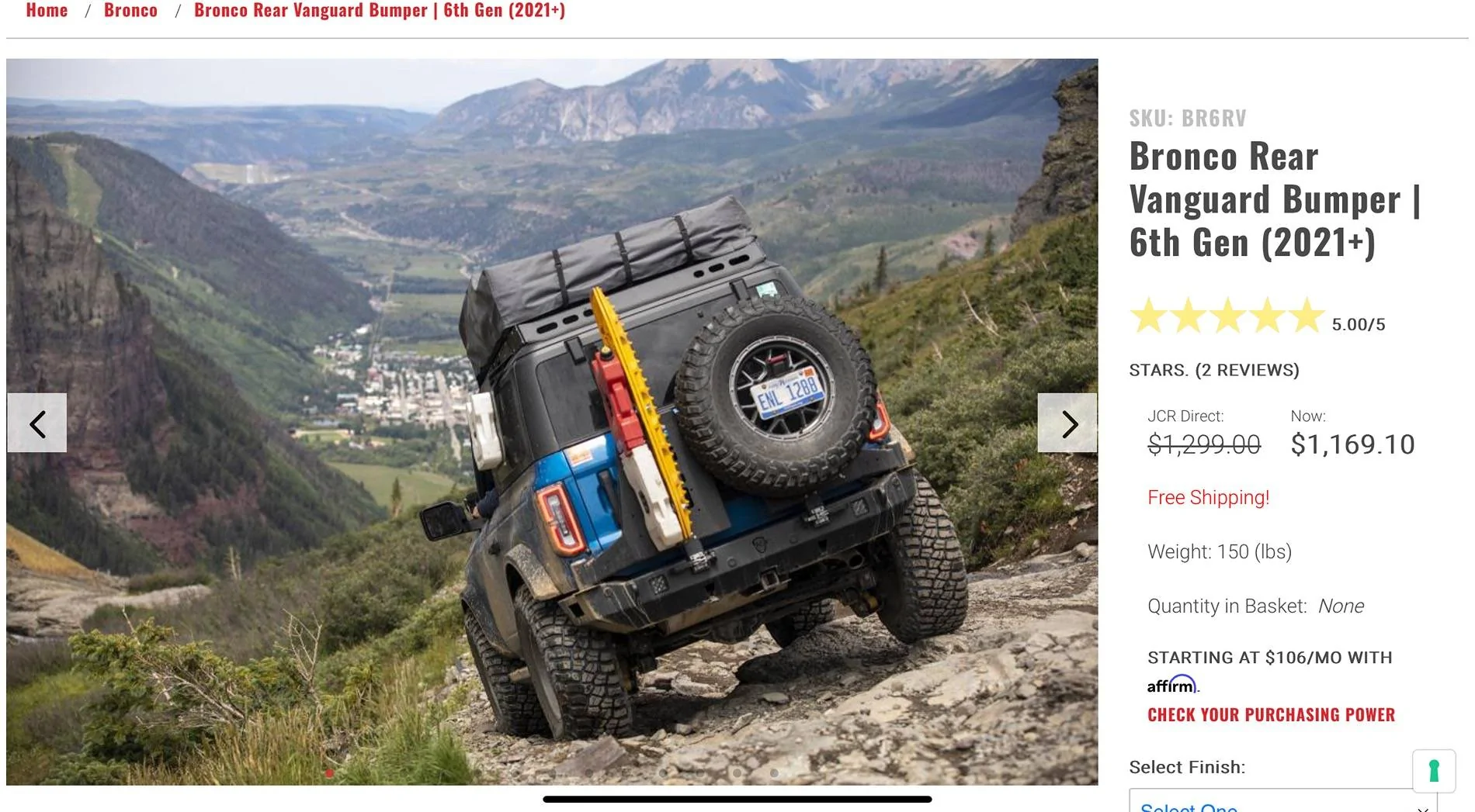

I have JCR - picture from their web site here. Mine has a 35, tanks, skids, shovel etc. on it and has held up through rough driving. Doesn’t connect to the tailgate. Fold down tables on each swing out. Backup camera and license plate mounts are clean. No complaints, and JCR installation videos / support are great.
Ford Bronco Let's talk about bumpers IMG_1642
