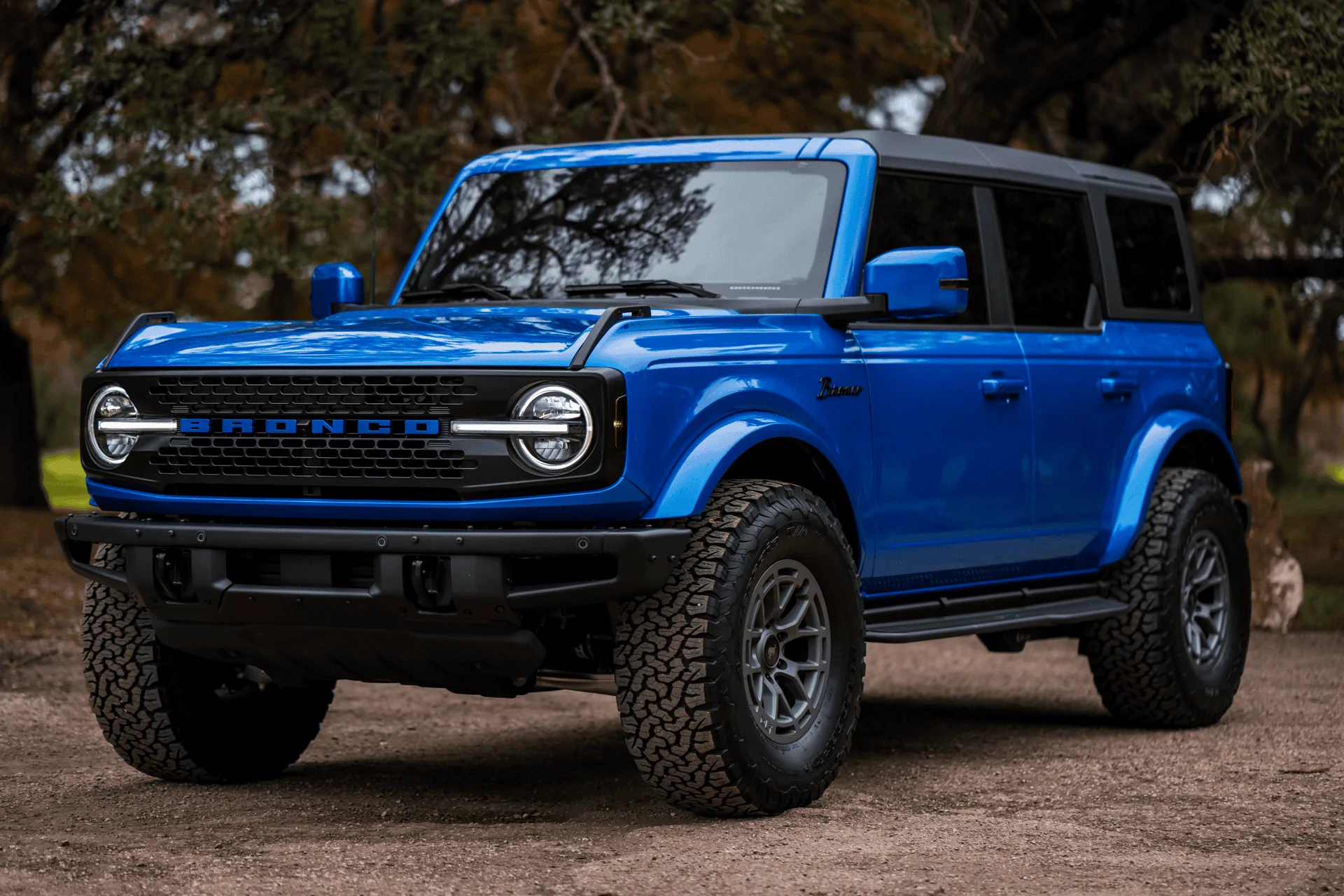

4 Door Badlands, Velocity Blue
I have a non-sas Badlands that came with the optional BL wheel as well. I liked that wheel, but ultimately decided to replace it to help go up in size. My wheel is the same size and offset as the sas wheels (17" and +30 offset), and I got the same size tire as a sas as well (315/70R17). I removed crash bars, but haven't done any type of lift. No issues at all. Considering a 1" level lift as others have mentioned, but mostly just for the look. I was able to sell my optional Badlands wheels and tires for a decent amount, so it offset a good percentage of the new wheels and tires.
If you like the sas stance and don't want to replace your wheels, you could probably do like a 1" wheel spacer and then get the sas sized tires put on. Or, finding sas wheels/tire takeoffs to buy is likely the cheapest route if you sell your current wheels/tires.
Ford Bronco Less Squat on Non-Sas Badlands ? 1702304463123

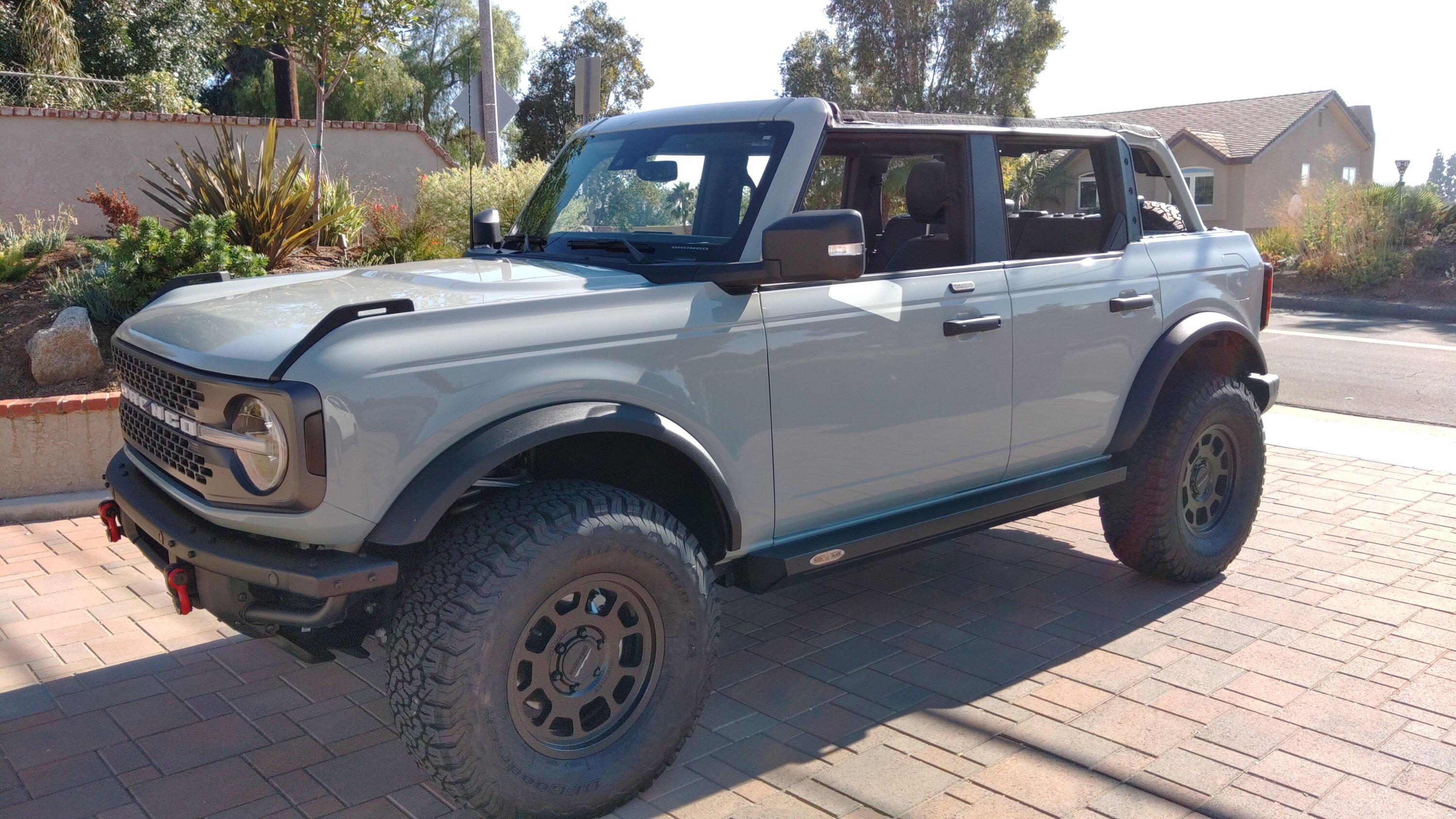

It also has a wider track width with the different offset wheels. And wider flares/bumper.
This is my standard badlands with Eibach replacement coil springs on 315/70/17's
How do you like the Eibach coilover replacement? Did you need to change UCAs? What type did you get and would you recommend?
