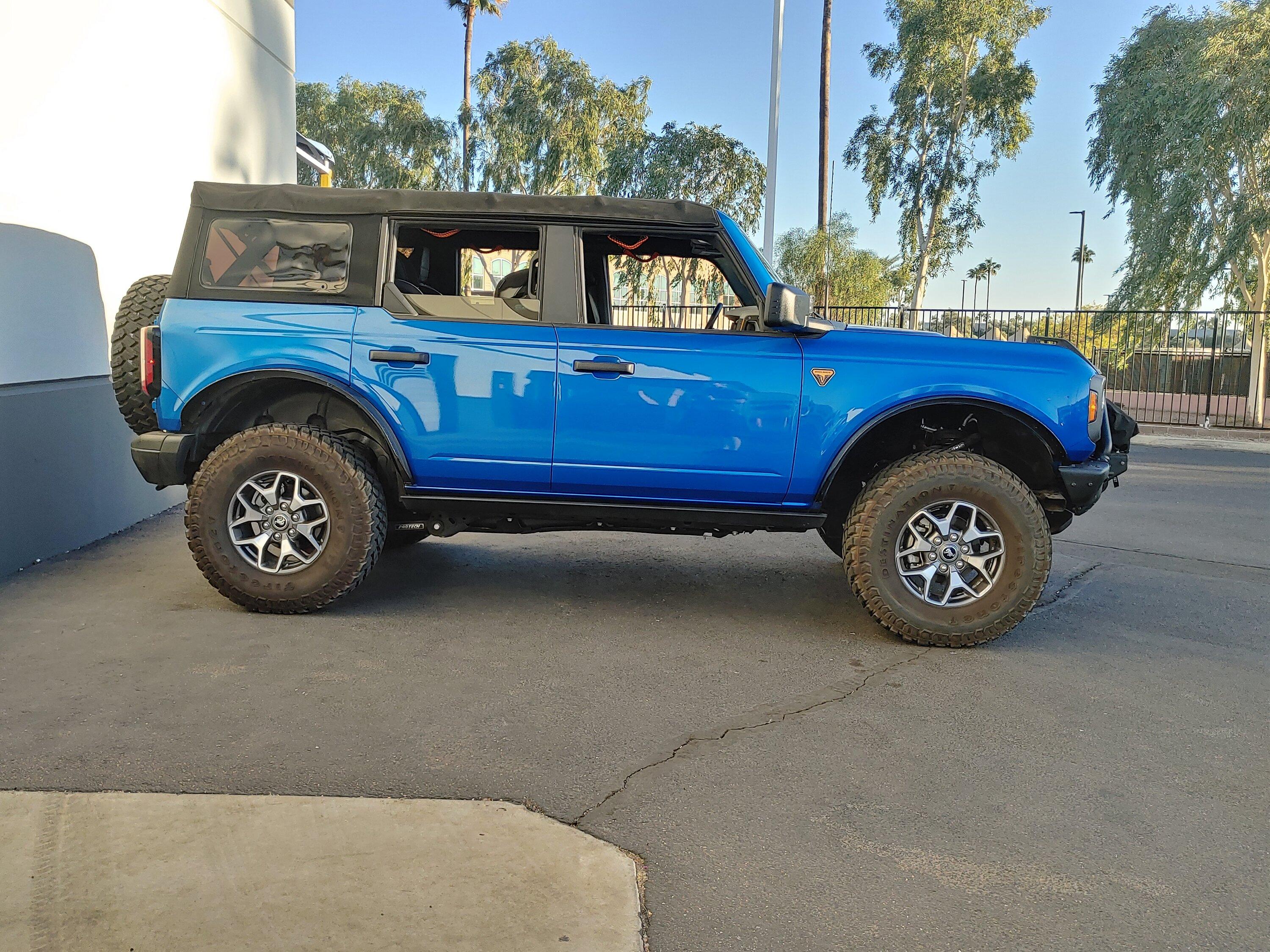

A budget boost and some bigger tires will help. A few brands have small spacer kits that work with the Badlands. I wouldnt go any higher than 1.5" spacers on the non Squatch Badlands shocks.
My BL on 1.5" spacers and 315's with 1.25" wheel spacers, to clear the upper control arms.

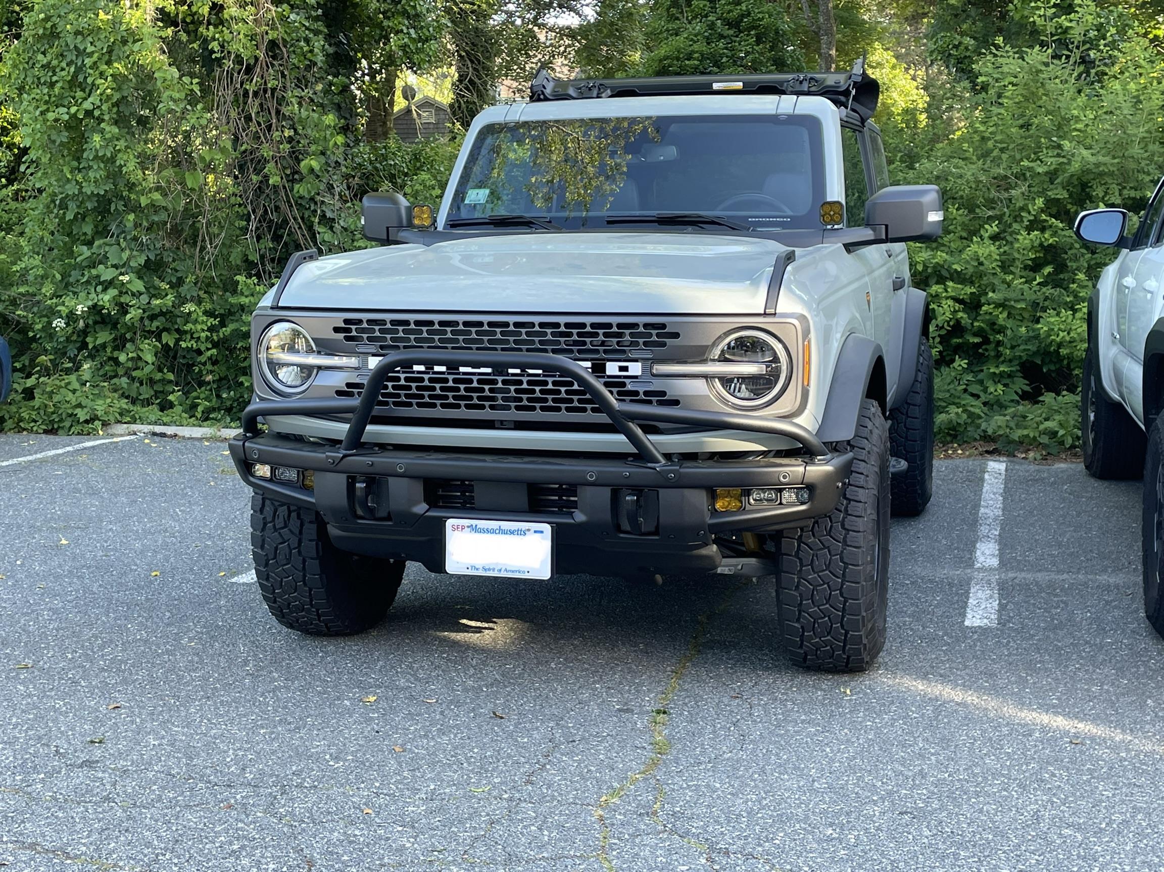

For a base bronco do you recommend the same? Not sure If I have the same shocks and whatnot as a badlands. What do you think is the best looking lift height with 35's?
The base without Sasquatch comes with the black Hitachi shocks. Badlands comes with Bilstein, but the standard spring unless you add Sasquatch.
For 35s, I like 1 1/2 inches of lift. An affordable option that will improve brake dive and off road performance is the Bilstein 5100 shocks. A set of 4 can be found under $600 and they are adjustable from 1” to 3” of lift in half inch increments . If you search Bilstein 5100, you will find reviews from many Bronco6g members that are running them.

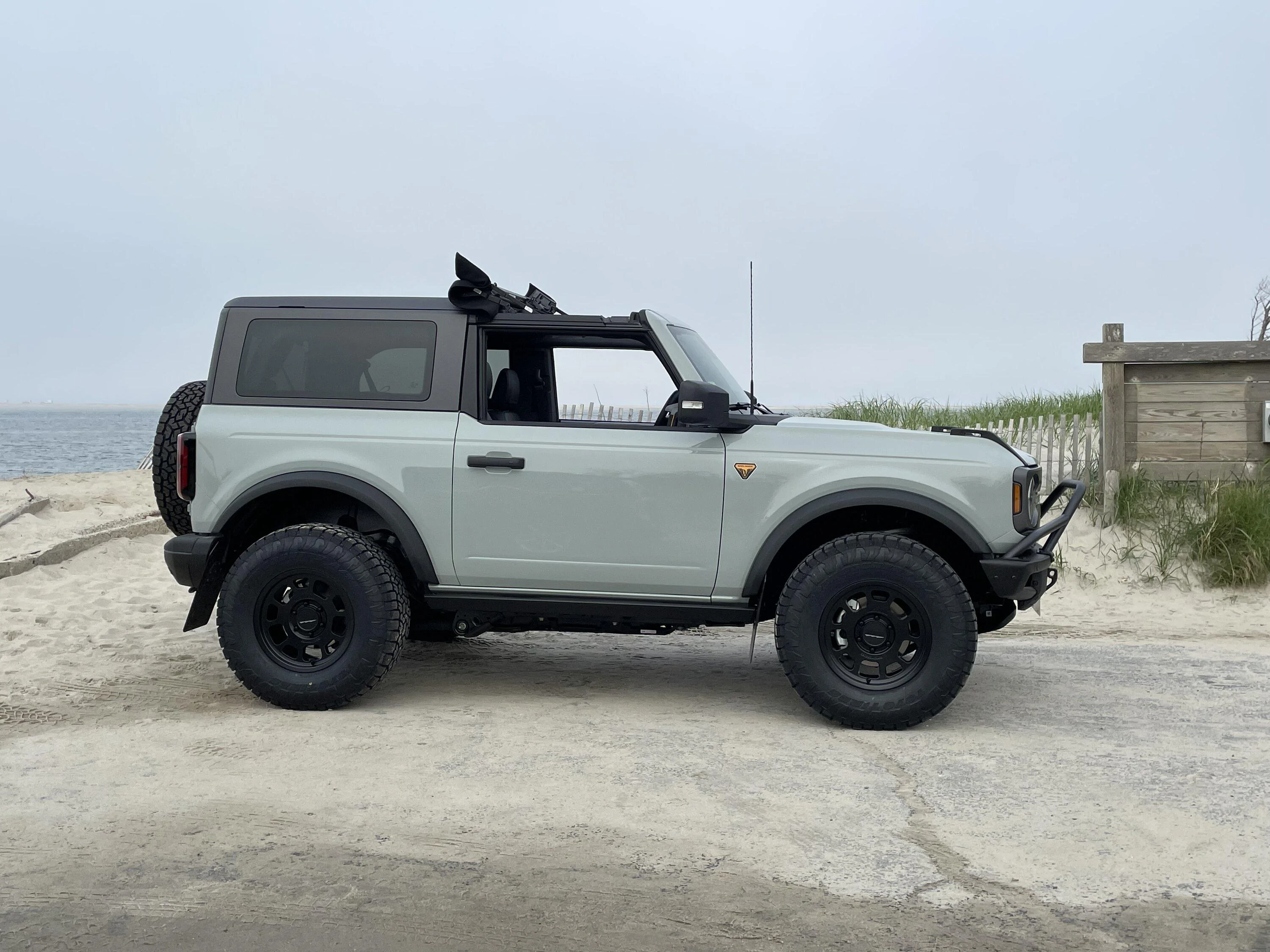

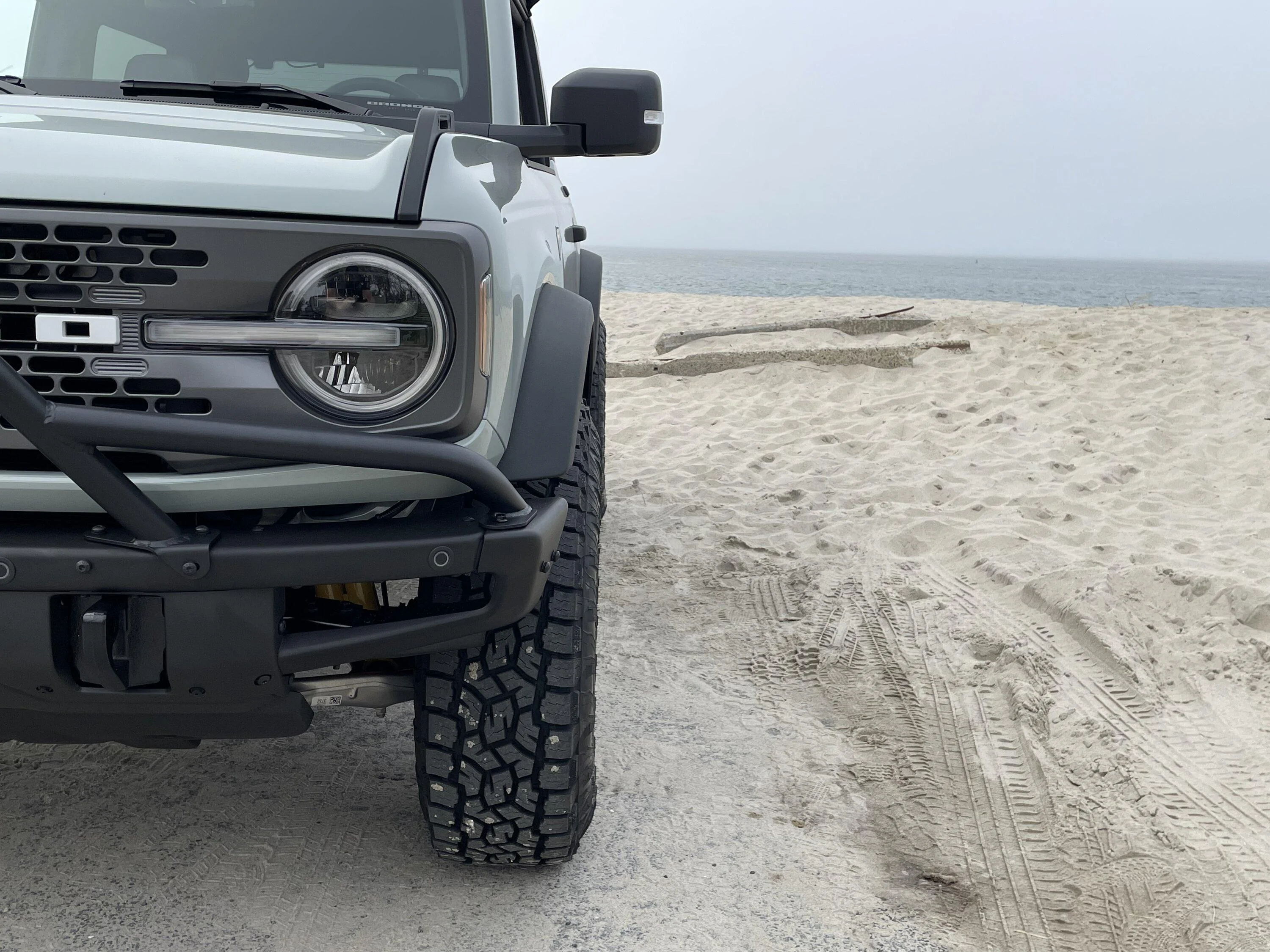

I did the 1" leveling lift, modified crash bars and installed 35Ă—10.50 17 tires on the origional Badlands wheels.

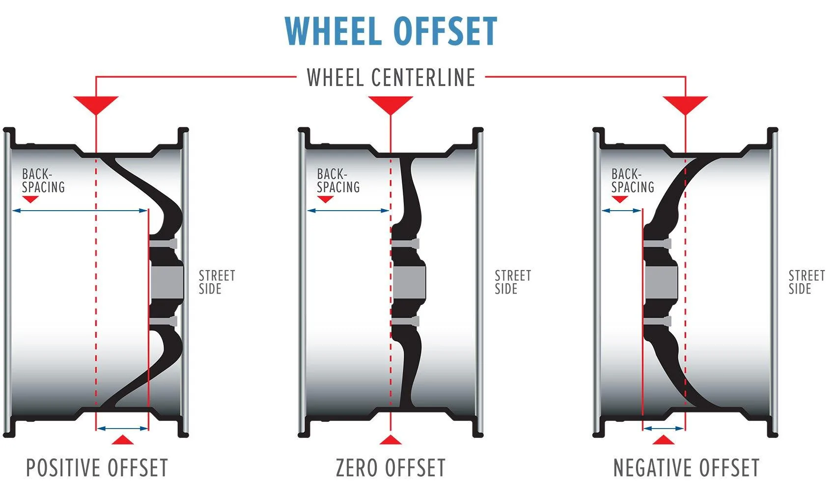

I like it. Realized this is a total noob question.... The offset is changed with diff width rims?
IwannaGOfast
Jon
Jan 6, 2022
995
1,669
Brea, CA
2021 4 door Badlands, 1991 Ranger Long Travel, 2014 Cruze Commuter
Not the width of the wheel, but where the wheel mounts within the wheel.

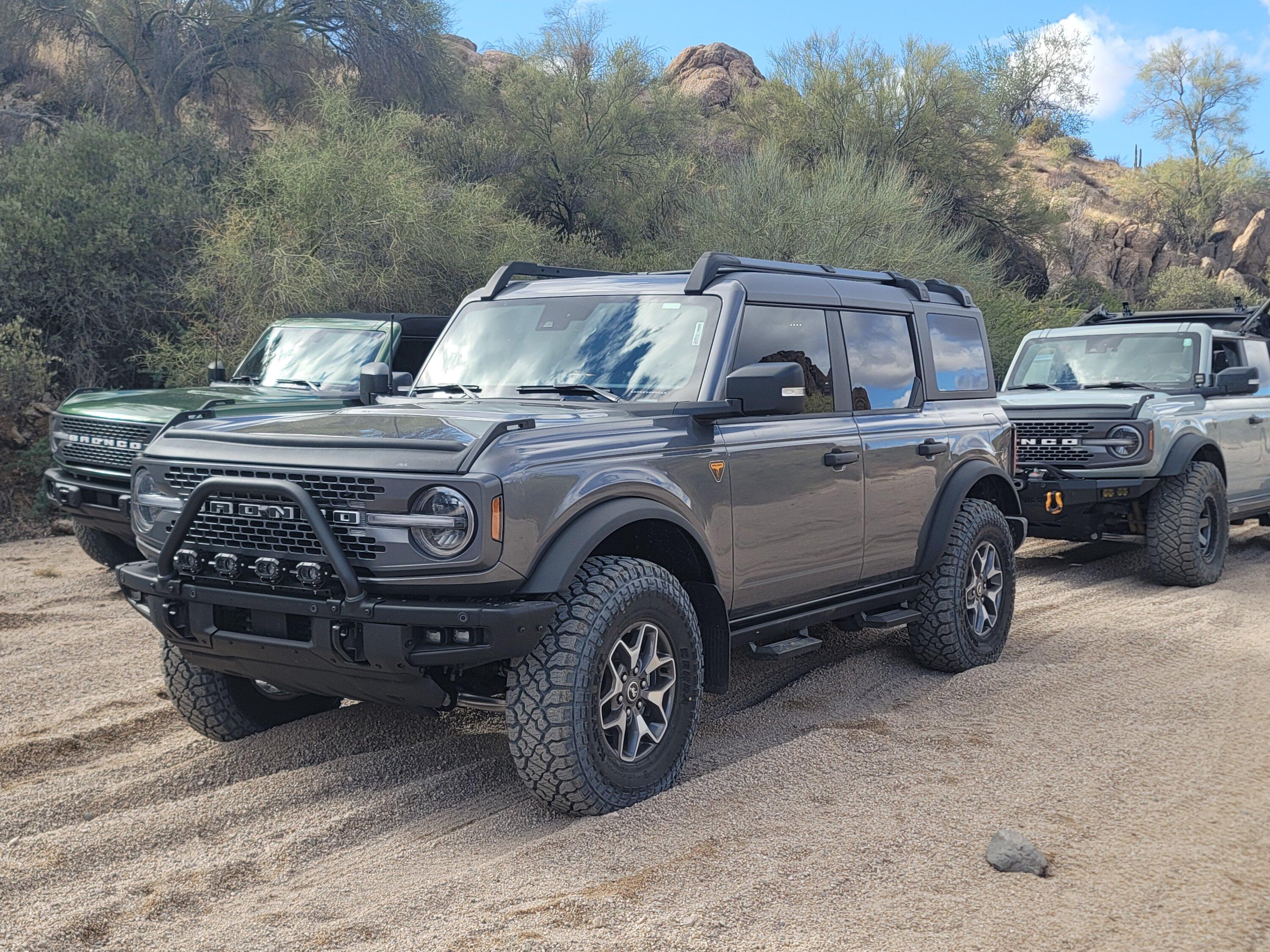

This is mine with 285/75R17 on +35mm offset wheels. Stock suspension but I plan on adding a 1” leveling block up front this winter.
Looks nice. So you don't need the 1" in front level to run 35s? No rub?
