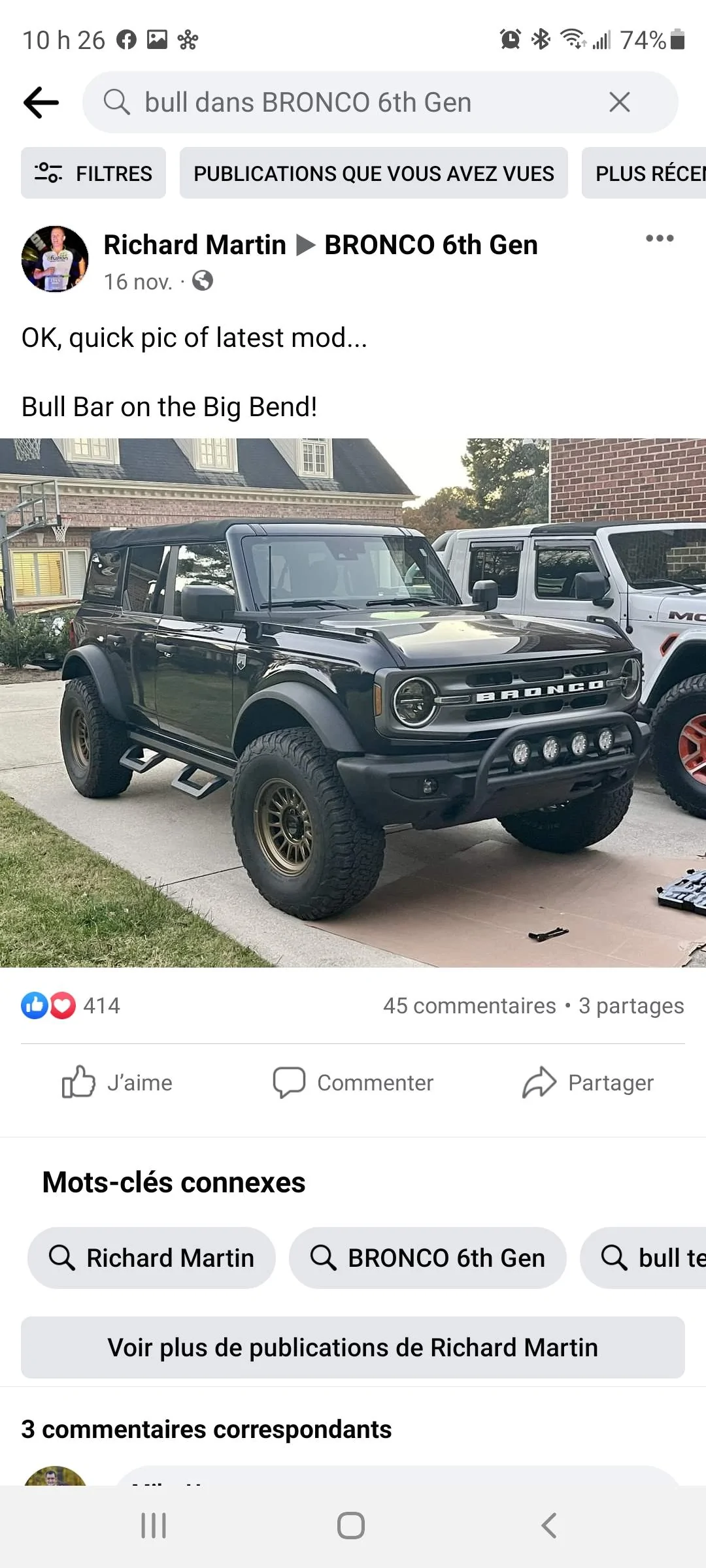

I have the regular front plastic bumper with the oem fog light. I plan to add a bull bar with led lights.
I like the feature that the vehicule goes on high beam automaticly....
Would it be possible to connect those led lights on the high beam circuit?

None mine but i like!
