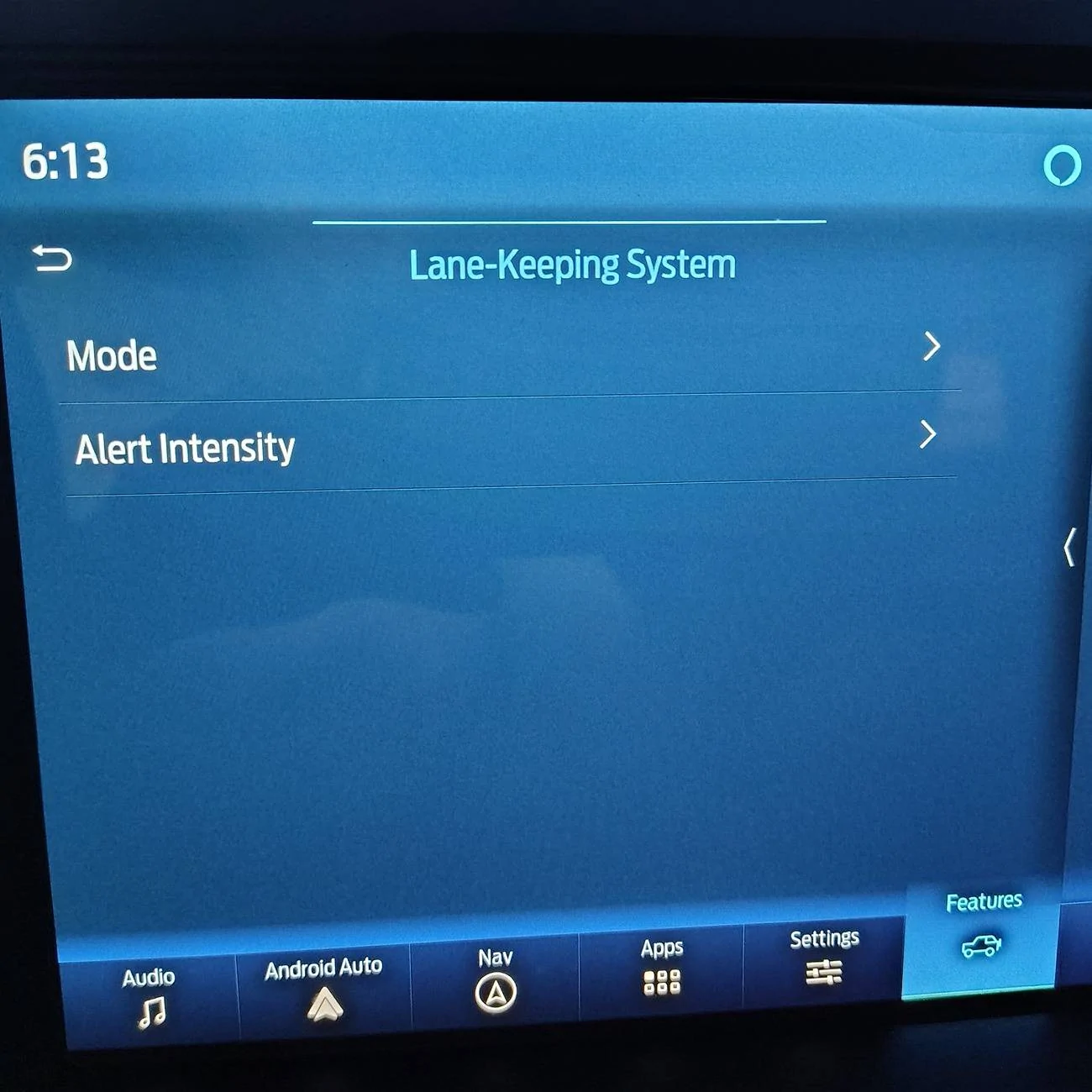

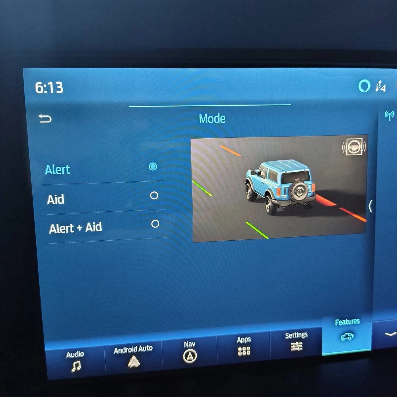

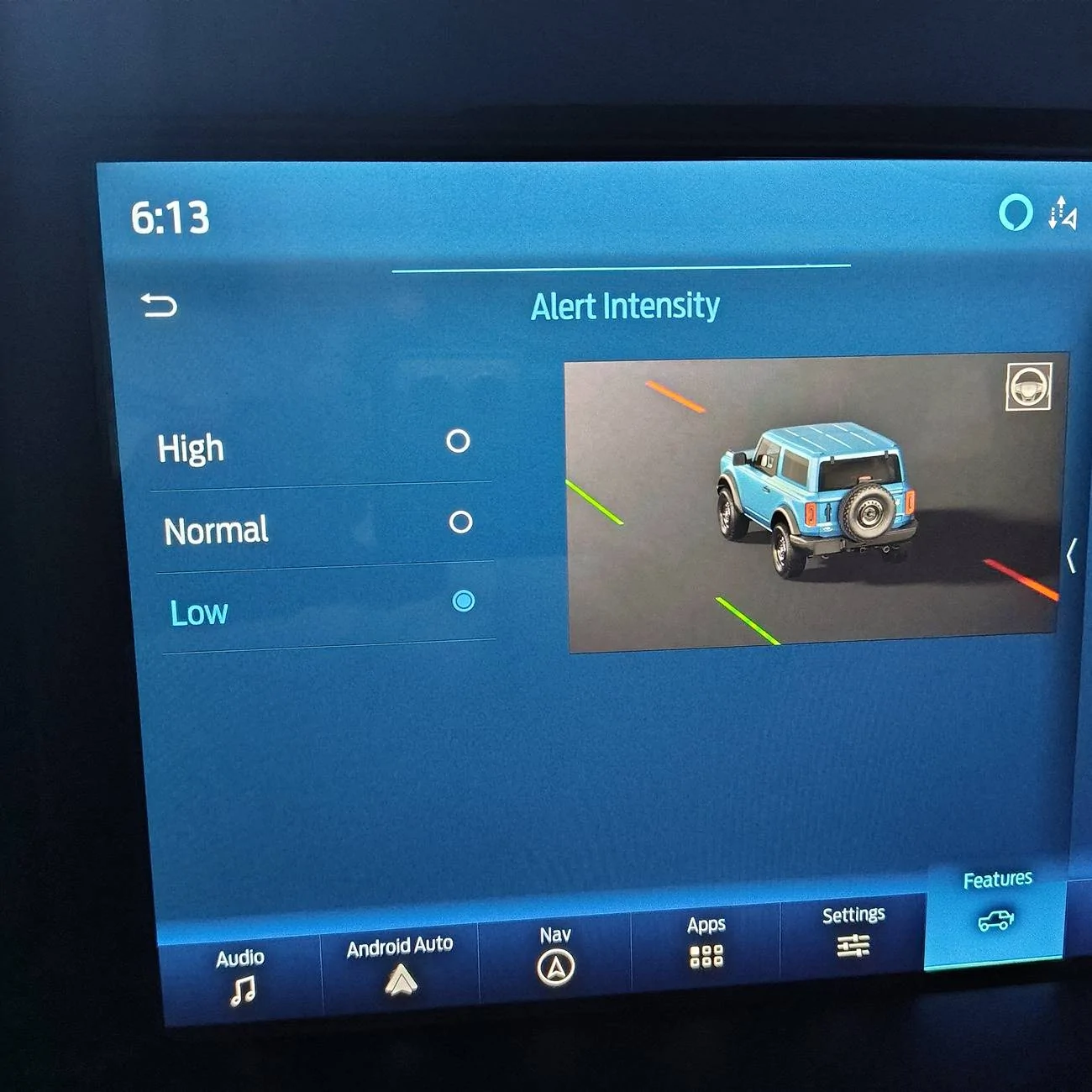

There's not an option to just turn it off on my Bronco....
Not sure if that’s because some of your forscan changes or what, but just pressing the steering wheel button should disable the whole system. All broncos are the same.
Like I said, I did that on day one and it’s never been on since.

No clue? When I got mine, I pushed that button on the steering wheel and it just got rid of the green lines on the dash. I never had an option to turn the whole thing off and everytime I asked about doing it in Forscan, I got yelled at... Eventually, I had though I got rid of it all, but maybe 2 months ago, I noticed the wheel vibrating showed back up... I'm not a big fan of these automatic or even manual updates to these vehicles... I also noticed that my splash screen is no longer the rolling rocks animation, it's just an outline of a horse... I guess I need to see if I can change that back too?

Yeah if the lines on the dash are off, the system is completely off. It shouldn’t be vibrating or anything.
So whatever you changed in forscan may have messed with how it works and now it’s partially active even though it shouldn’t be?
Hard to say.
