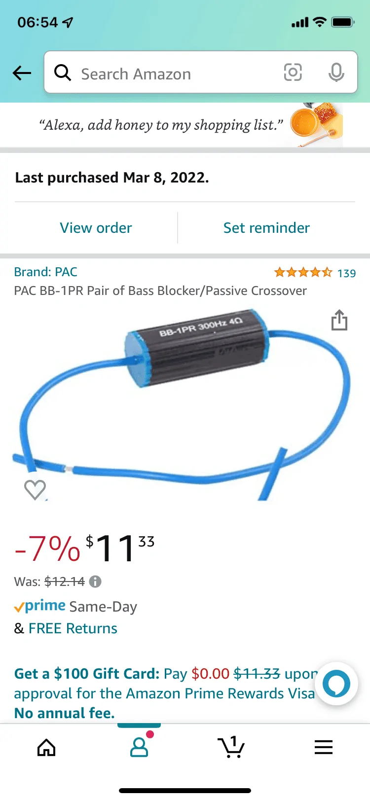

It’s probably hitting the limiter. A few of us are having the same issue. I have the bass blockers and it doesn’t help.

Do these only go on the dash speakers?
Yes. In terms of the amp. I’ve put the gain to almost zero. Don’t really need more as the power is enough to drive my speakers.
I installed them only in the front and heart no much difference between fronts amd backs. A font Kickers CS sounds a bit sharp on the top with s new 6.5 " Morel that performs outstanding.
After lower the highs a bit in the setting I think that i achieved the optimal performance without a new external amp and a sub.
