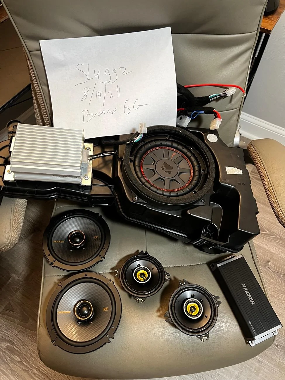

I have the same speakers for sale, as well as some kicker 4 inch ones if you’re still looking. Got pics with timestamps

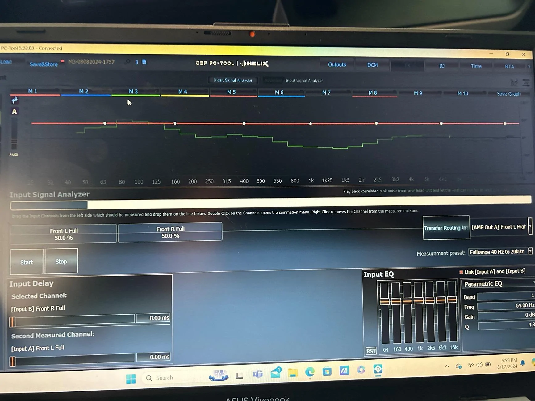

Base system is full range with a cutoff at about 50hz. I assume BO system is same if dash speakers are tied to the kick panel like the base system. They probably have a different tune is all. Here is what comes out of base radio to kick panels.
This is interesting. So you can pull a full signal from the kick panels?

Yes. This is from the base. I don’t have a BO to test that. Ford does roll of the lowest bass frequencies to protect woofer. So a DSP restores the rolled off bass.
Yea but what I’m wondering is if your aren’t getting the full range from the speakers for high level input, how does that effect the signal range from DSP as far as summing goes
If you buy a DSP with as many or more inputs than channels of OEM outputs, you can sum inputs to a DSP output. Or you can divide an input to various outputs.
