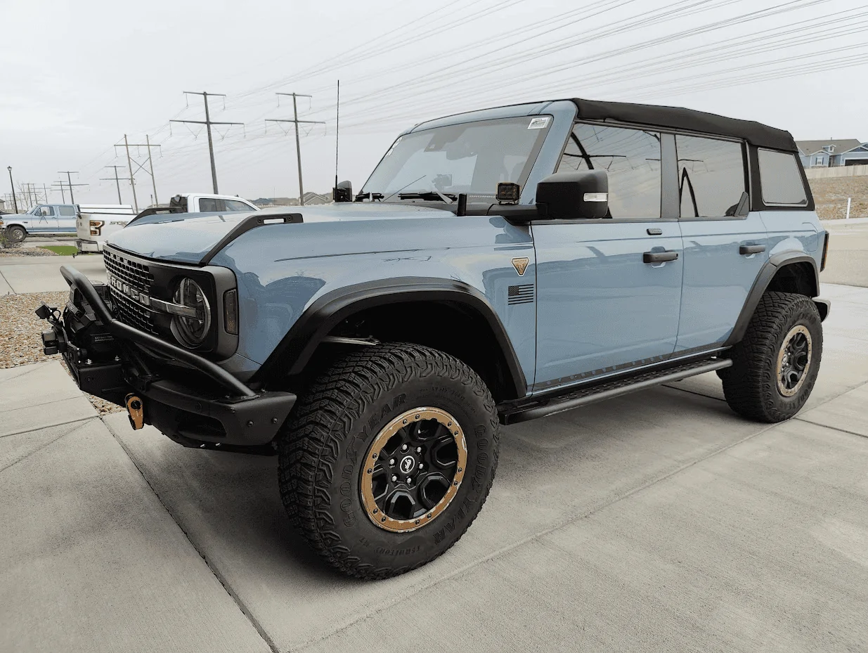

Just installed mine as well. I added a line of XPEL vinyl along the inner edge of the fender so you don't see any blue under the flares. I also swapped out the rear bumper end cap for the non-sasquatch so they don't stick out as far.
I'm impressed with how well these follow the body lines. The black bolts provided to use on the rear fenders are not quite long enough due to variations in the factory rivnut depth, so I had to reuse some of the factory blue bolts that I took off.
Small bonus is the rear fenders have a segment that attaches to the doors, so no more problems with snow buildup on the rear fender preventing me from opening the doors. Overall I LOVE the look with the new flares.

Where did you get the non sasquatch rear bumper sides?
Looks awesome.

Thanks! I got them from SearchFordParts.com
Part Number​
Part Name​
Price​
Quantity​
Total​
M2DZ-17F774-CC​
Cap Bumper End​
$23.56​
1​
$23.56​
M2DZ-17F774-CD​
Cap Bumper End​
$23.56​
1​
$23.56​

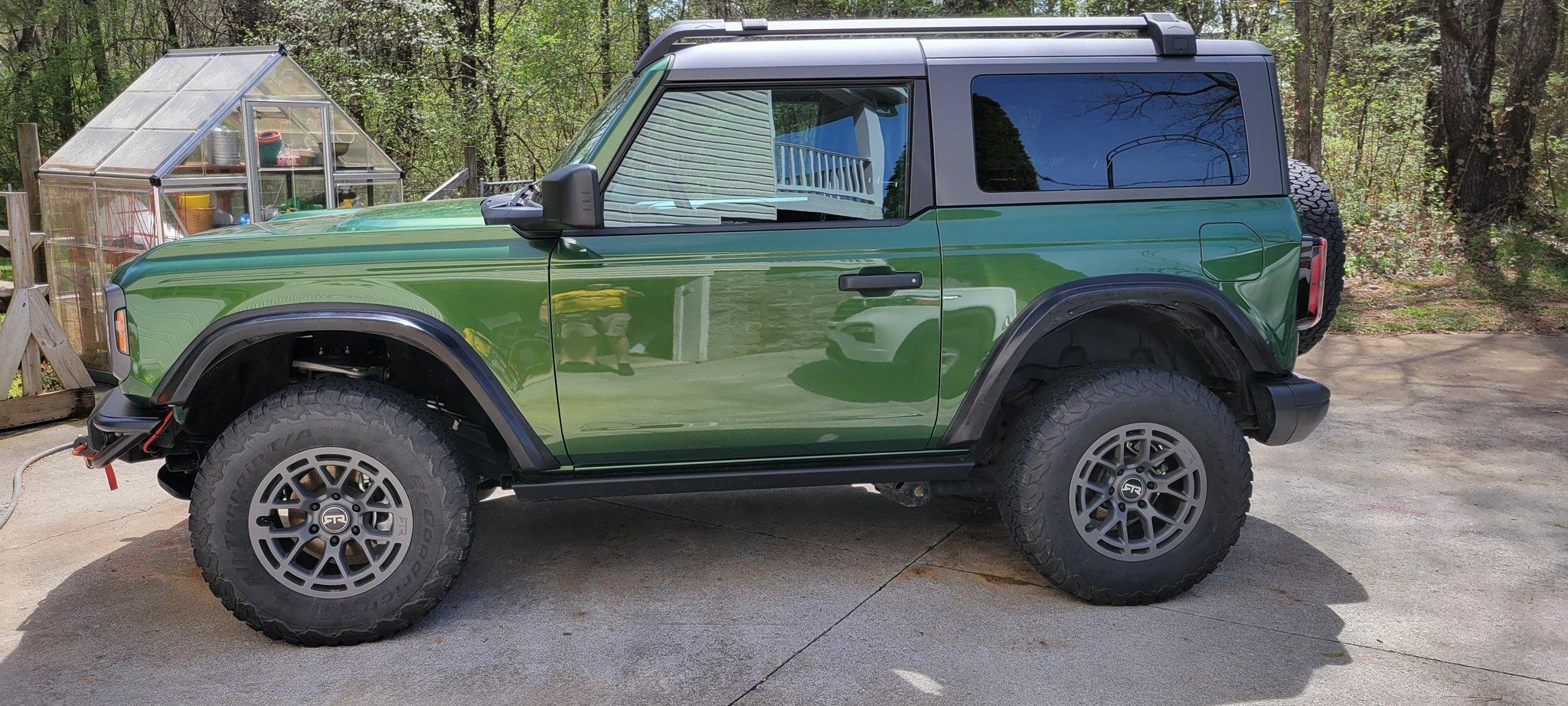

Anybody else's KBD flares turning gray real quick??

Have you tried hitting them with 303 or similar?
I havent yet. Just put em on a few weeks ago. Only washed with Griots BOSS foam and Adams soap and havent been treated with anything.

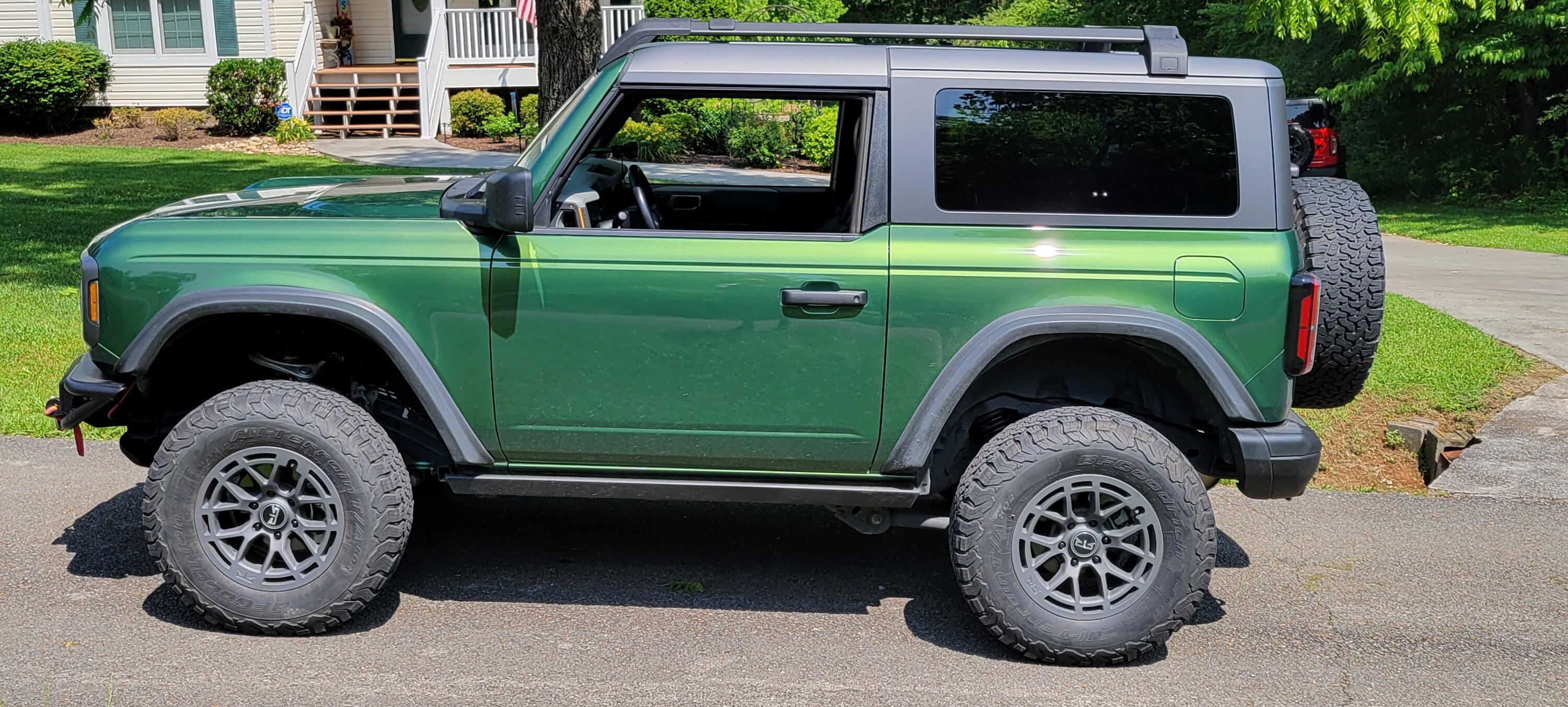

Taken yesterday
Thanks. I haven't reinstalled mine yet, but one of my concerns was how shiny they are (new). I prefer the more dull finish, but a little more black. I can't say that yours are showing any less grey than the stock flares when left untreated. I am also interested in seeing what 303 would do to the appearance/protection. You may be knocking me off the fence to get mine painted.
