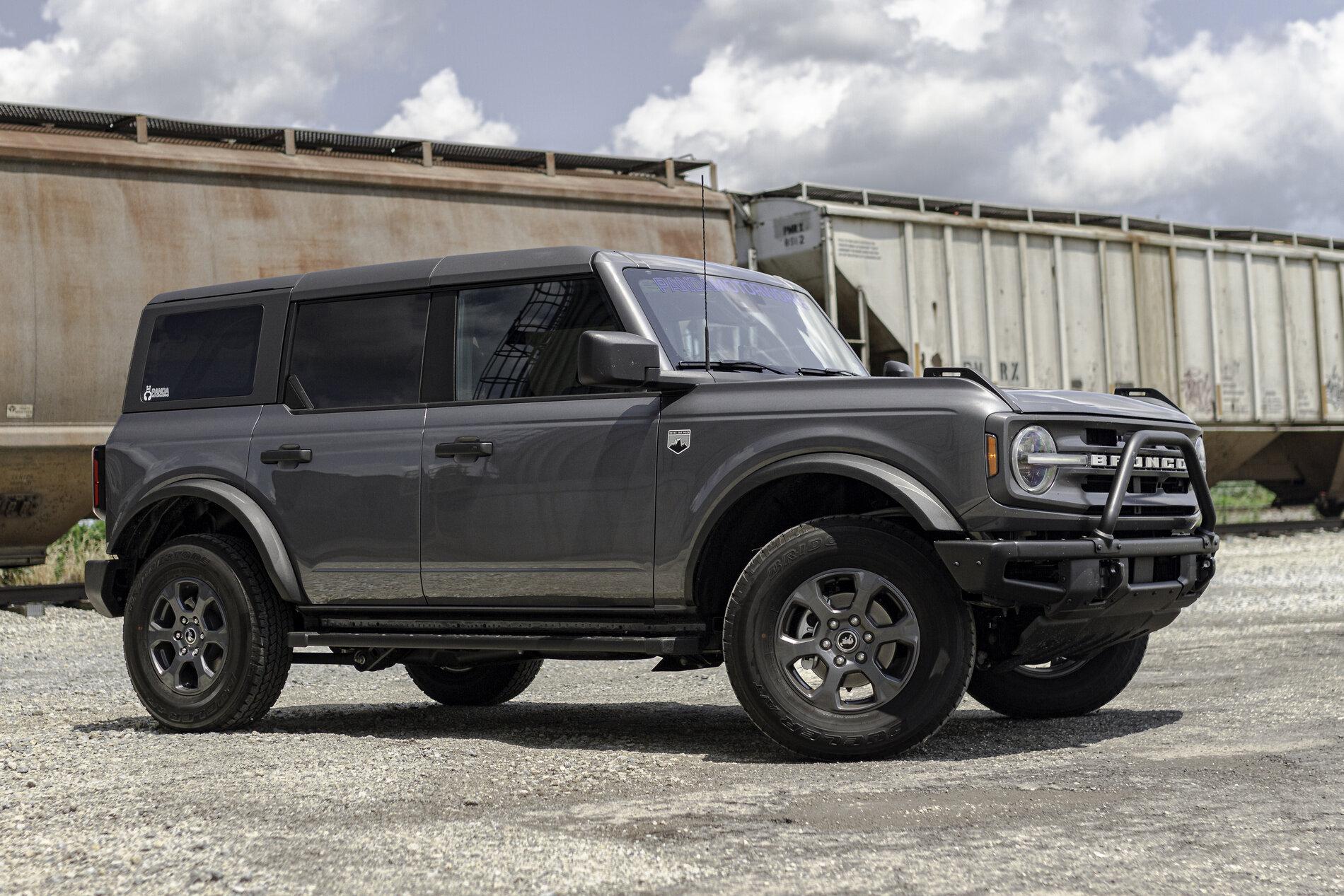

It does not poke 2.5", its probably somewhere around 1" or less of poke. 17x8.5 +0 has been one of the most common sizes for the Bronco thus far! This picture may show it a little better, but as I stated earlier I will not be able to get a picture straight on to show poke until tomorrow as our Bronco is at @Diode Dynamics this week for R&D!
something is off here .... cuz the math don't add up .... if you keep EVERYTHING the same as stock and ONLY move the factory offset, from +55 to 0, you've moved your tire and wheels outward by over 2 inches ..... (that doesn't include moving the centerline of your wheel)
I am not sure how this doesnt add up.
The factory wheels are not flush with the fender. by changing the offset we have moved the wheel outward and 3/4 of an inch outward of the fender.

It looks great, but doesn't 'look' like 2+" wider than stock.
Technical question: How does the steering feel with the change in offset? I used to design suspensions, and having the scrub radius increased by more than 1" often made the steering feel weird.

Stock is 17x7.5 and these are 17x8.5, so only an inch difference in width. Honestly, I did not notice much of a change at all going to these wheels. I do expect that to change when the M/Ts go on though.

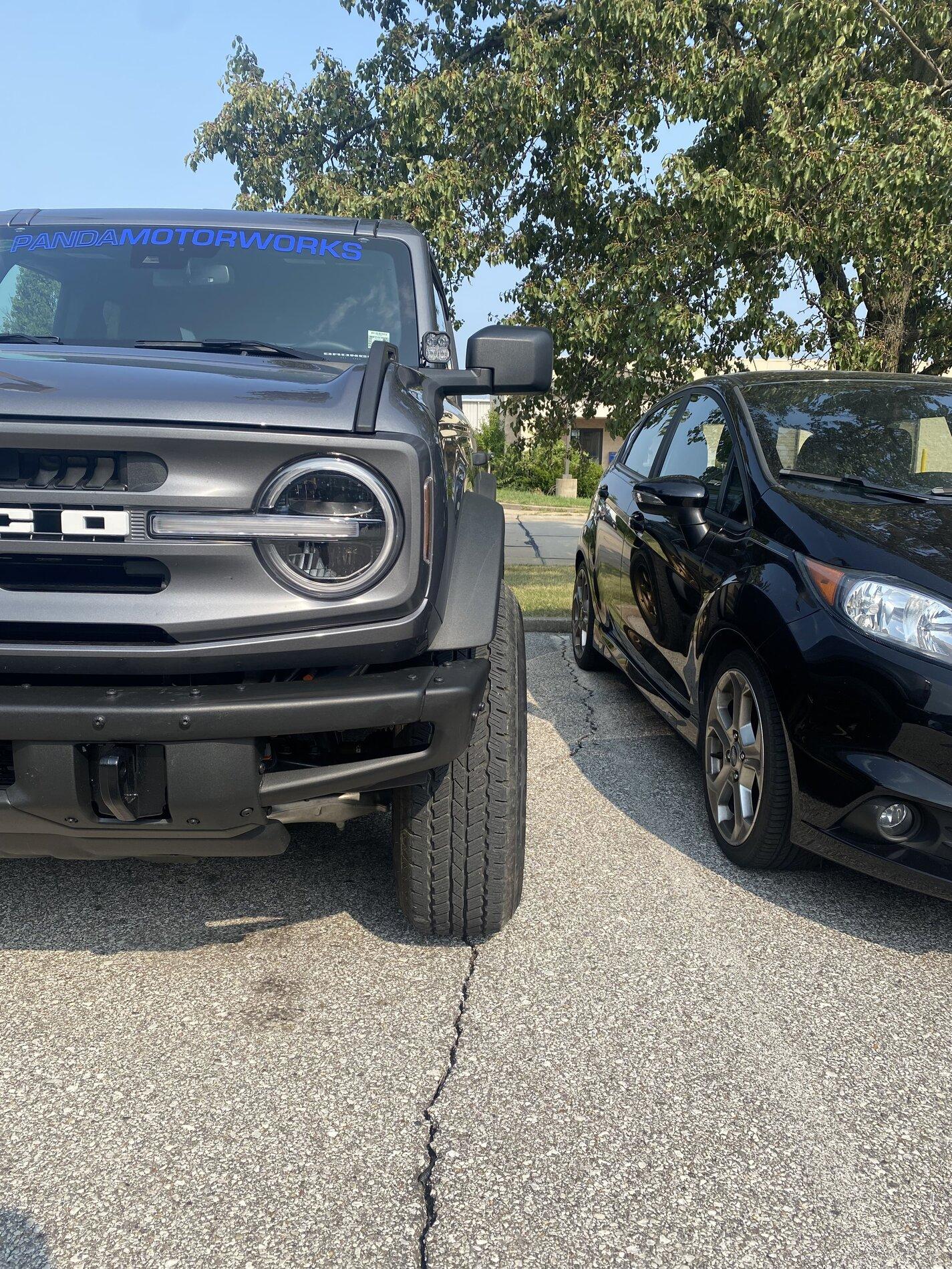

We just picked up the Bronco and I know a lot of people were requesting a straight-on shot to see the poke. So here it is! Again, this is with the Bridgestone Duellers that come on the Big Bend model on 17x8.5 +0.
Ford Bronco Kansei Off Road Wheels Mounted on Bronco IMG_9285
