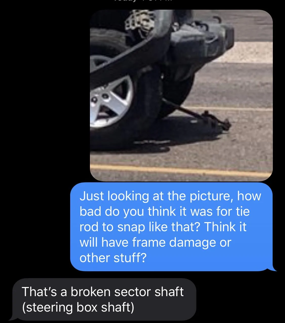

Is that the drag link or tie rod hanging out under the front?
Texted my buddy who builds jeeps, he says it’s a sector rod shaft. Not good i assume

That would be the shaft that comes out of your steering gear box where the pitman arm connects the drag link to the gear box. Looks like the pitman is still attached to the linkage in the pic.
Won't have that problem in you Bronc, it has a rack not gear box.
