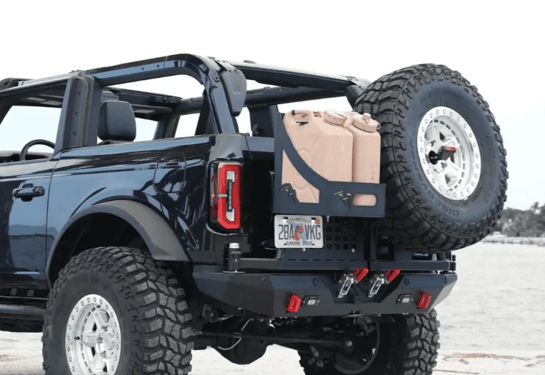

Hey All
Going Overlanding near Tahoe in about a month. Looking for a solution to store extra fuel and water jerry cans to the tailgate. Most of the options I'm seeing out there are several hundred dollars or universal types that I am not sure will fit well. Any recommendations? Pic for reference.

What bumper is that in the picture. I was looking for a double swingout. Tire is a bit too high but hopefully it’s adjustable.
