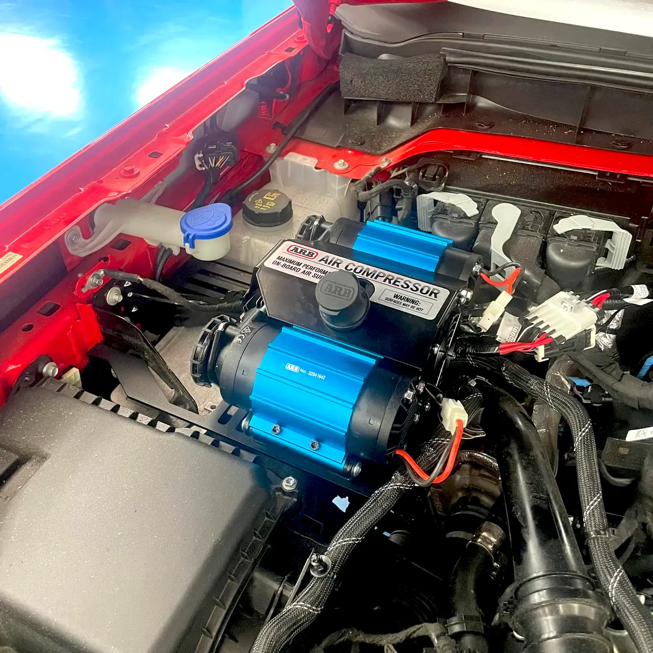

I have been researching option for mounting an on board ARB single brushless compressor. The engine compartment is my preference. I have found a mount that I like offered by JCR Off-Road. It looks like it meets my needs but I would like information from anyone that has some experience with it. It looks good but I would like more input than its looks.
The mounting holes are made for the the ARB brush style compressors. So, I would need to make my own compressor mounting holes, but that is not a big deal.
Anyone have any positive or negative insights for me?
I have had one in use with my ARB twin compressor for about 3 years now with no issues. I had to trim it a bit when I upgraded my intake to the Injen. Install wasnt terrible either.

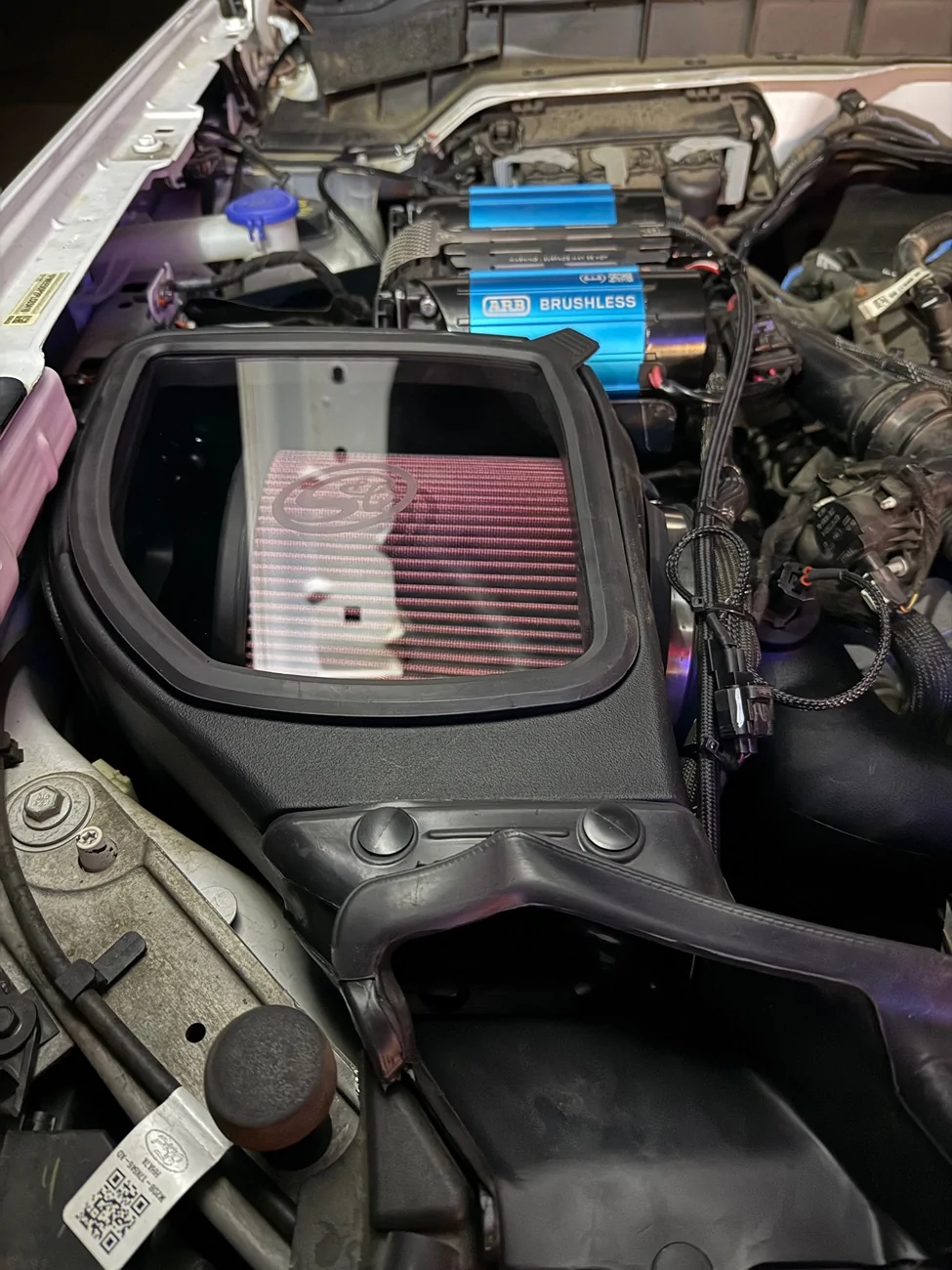

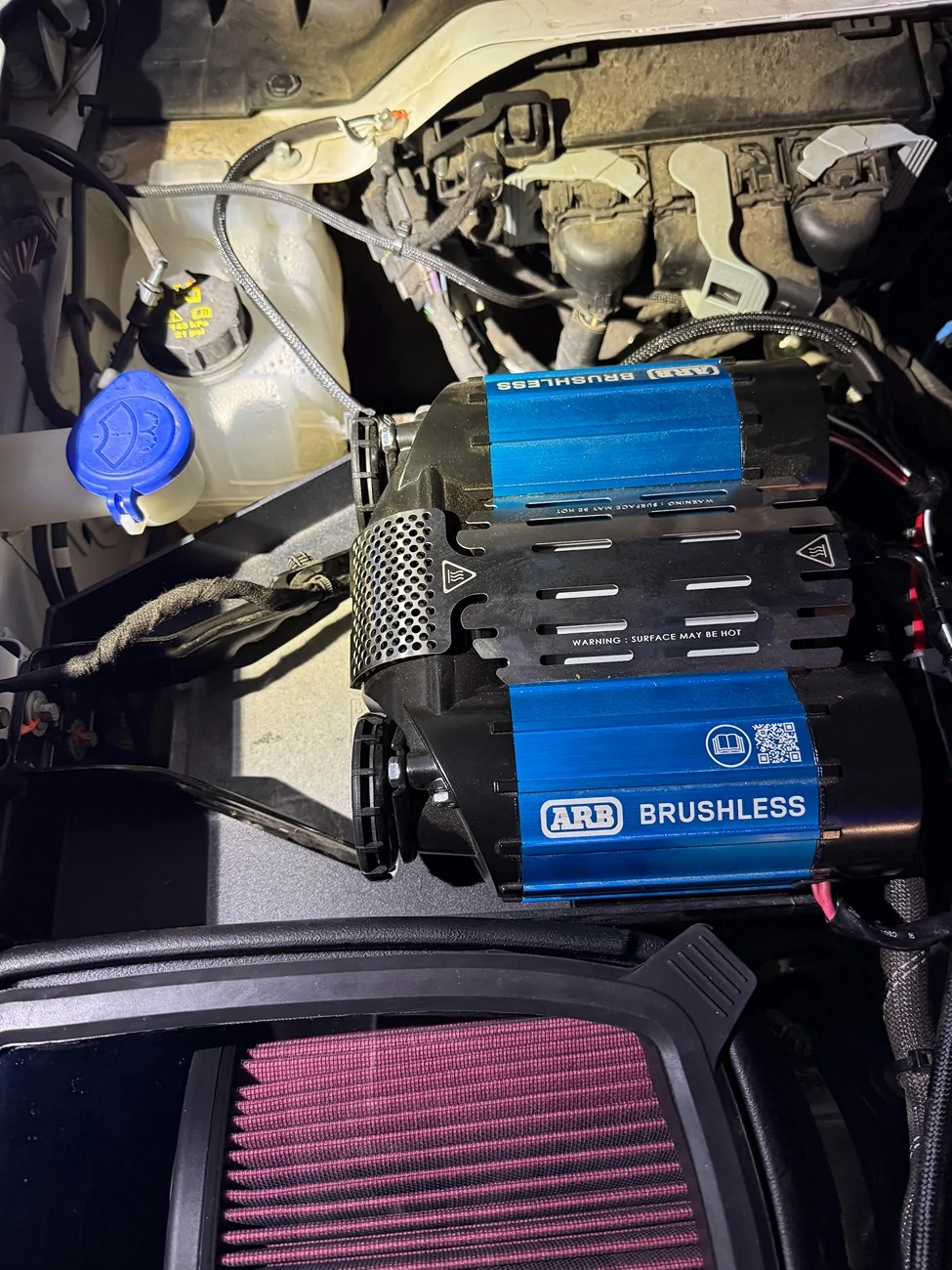

I’ve got the JCR mount with an ARB brushless dual. Very happy with it. Getting the nut plate on the firewall aligned was a pain. And I found out today it fits with the S&B intake.
