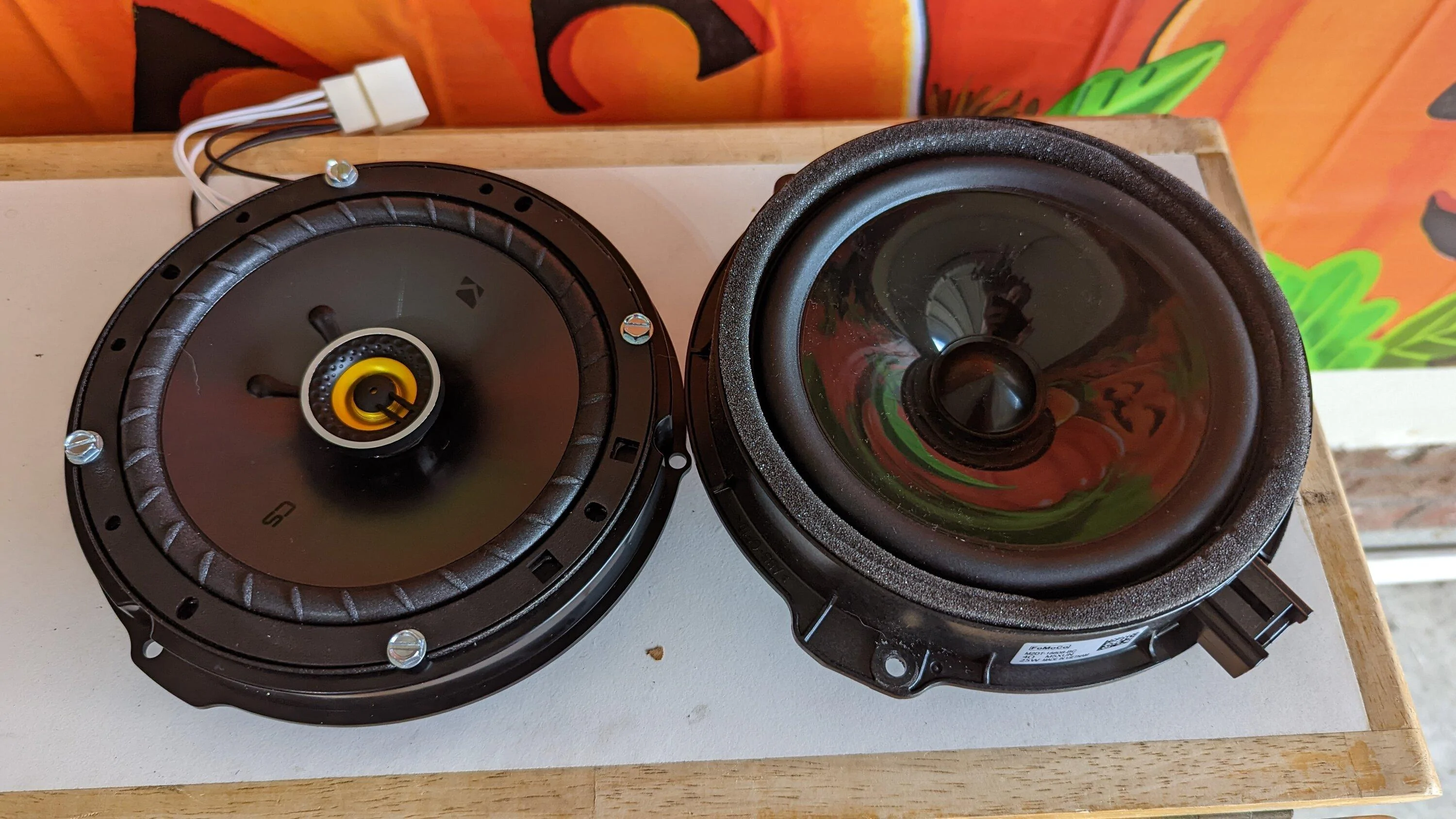

Swapped the 6.5s today. The supplied screws did not work with the Metra 82-5605 speaker bracket, so I had to find some at Lowes. If anyone is curious, #10 x 3/4" is the perfect size screw to mount the speaker to the Metra bracket.
I could definitely notice a bit more clarity though the difference is minimal. Still waiting for the 4" pigtail to arrive to put those in.

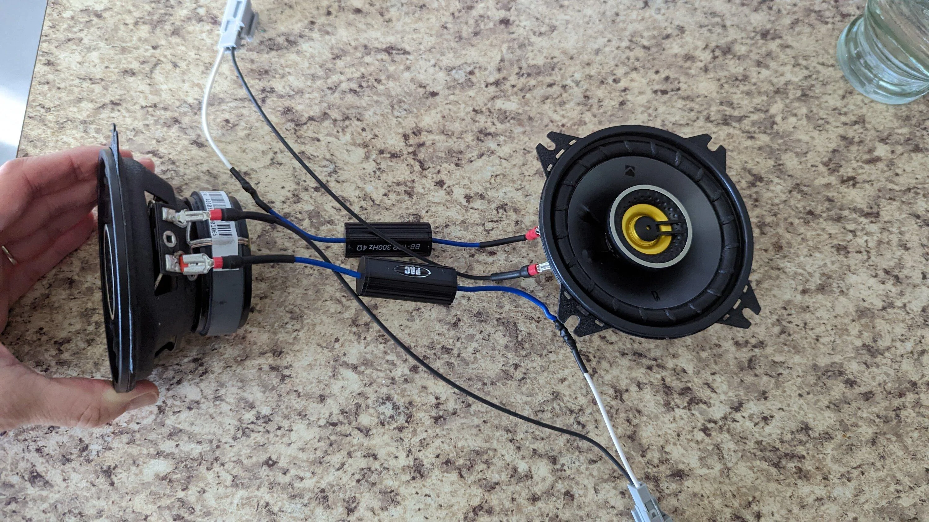

Dash 4s went in today. I went with 300 hz bass blockers, soldered w/ heat shrink. Sound is improved. They don't have that under water/muffled sound like the OE speakers. I notice an improvement, but the sound is still lacking a bit (I'm going to blame the lack of power to the rear pods & lack of overall bass). It's on the right track though.

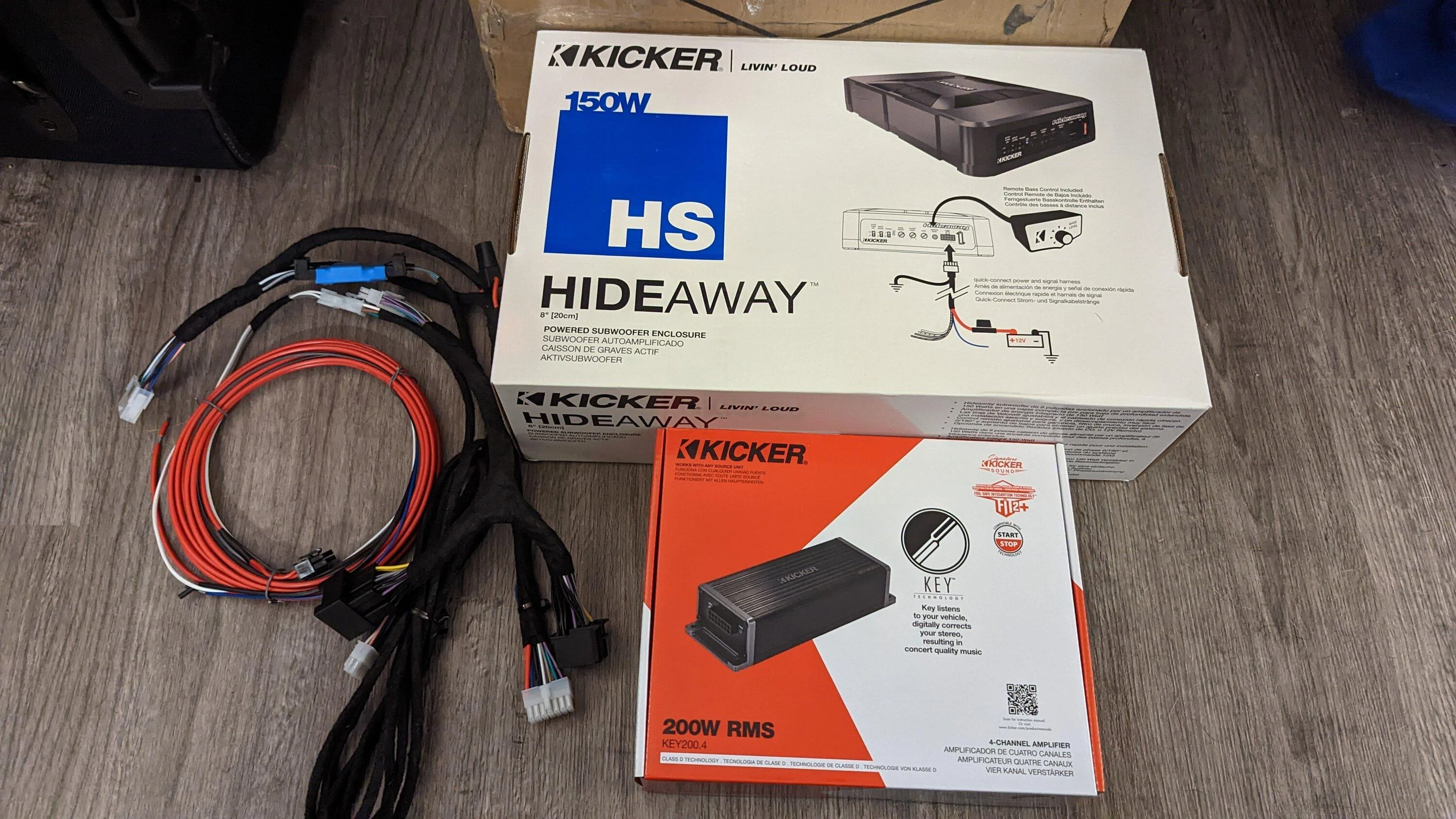

I've fallen down the audio rabbit hole (I am no audiophile, but I really do dislike the stock system. For a nearly $50k well equipped Bronco, it's just not up to par). I want the sound that matches it's price point.
After installing the new speakers, It improved the highs/mids but still sounds really flat. I would even say noticeable bass lost from the kicks. That was a disappointment, I figured it would improve.. but after further digging found that the likely culprit is the factory head unit struggling to move the heavier magnets. Makes sense. Rather than back track and put OEM back in... I figured now what?
After LOTS of research and back and fourth, I ordered kit #15 from Plug & Play Kits with the Kicker Key Amp & Kicker Hideaway 8". I have two young children and this is the "family" car as well as my tinker toy, so I just want well rounded sound. Not looking to damage their ear drums, LOL!
I considered just getting the amp with the attachment to add the sub later but I feel like I will still be disappointed in the bass so said F it, lets just do it all now.

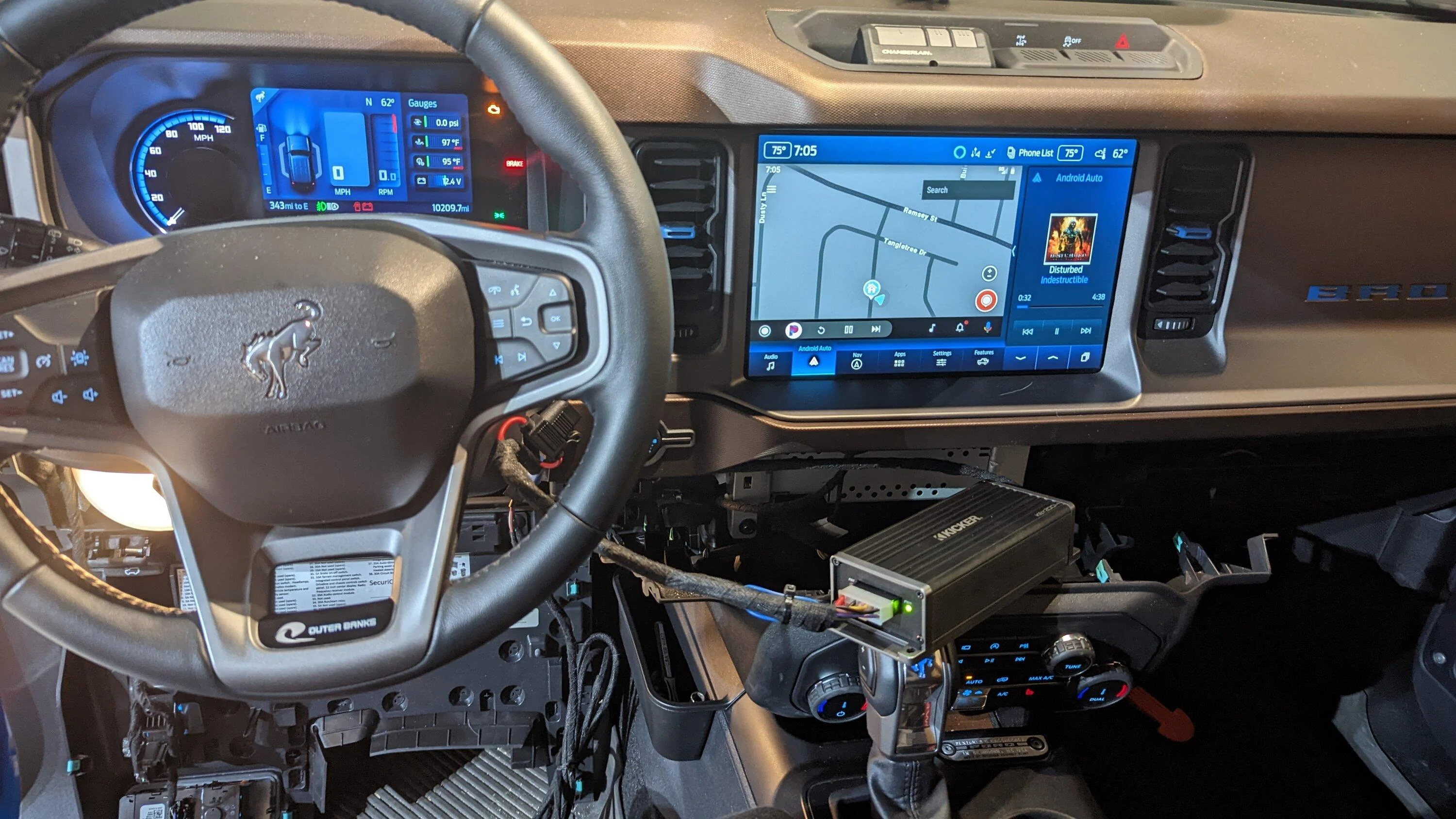

Key is now installed. I do need to re-do the DSP and make a couple adjustments, but overall sound is highly improved. Will be installing the sub later today. The PlugNPlay kits harness makes install so much cleaner than I can imagine trying to accomplish without it. A must have.

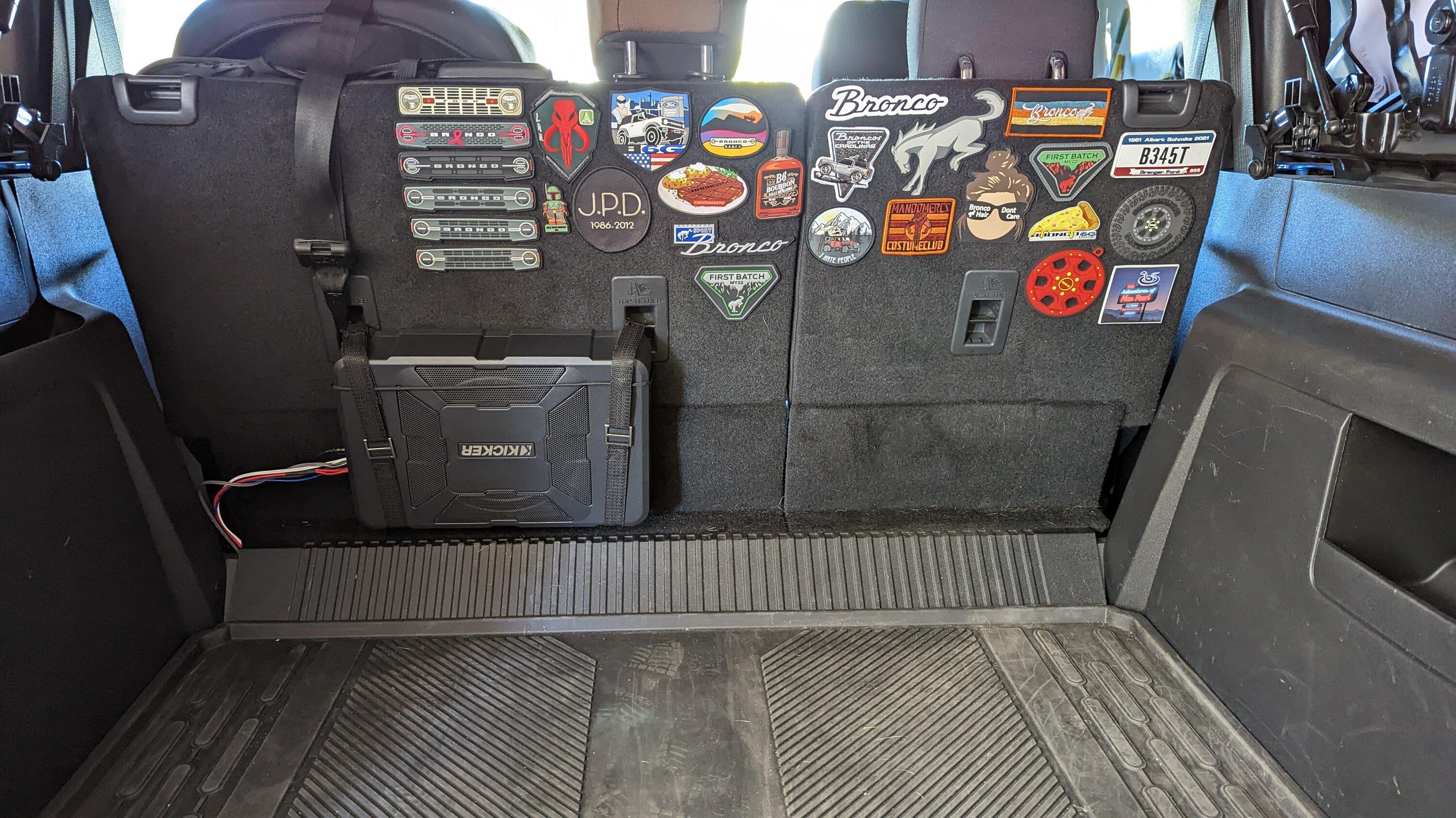

Hideaway installed! Quite a project. Simple in nature, but all the trim panel clips, wire feeding & ziptying, leave you with some sore finger tips afterwards. I took my time, install is very clean. I just need to get some loom for this bit of exposed wire harness. I was so relieved to find a nice lil hidden spot to feed the wires underneath the rear side panel. I just mounted it here for now with the provided straps. It's actually quite sturdy. I was cold and ready to be done in the garage. I may alter it at some point.
HUGE sound improvement with the amp & sub, and I'm still lost in the sauce with the settings (where I want the gains, crossovers, etc).. but that can be slowly tweaked over time.

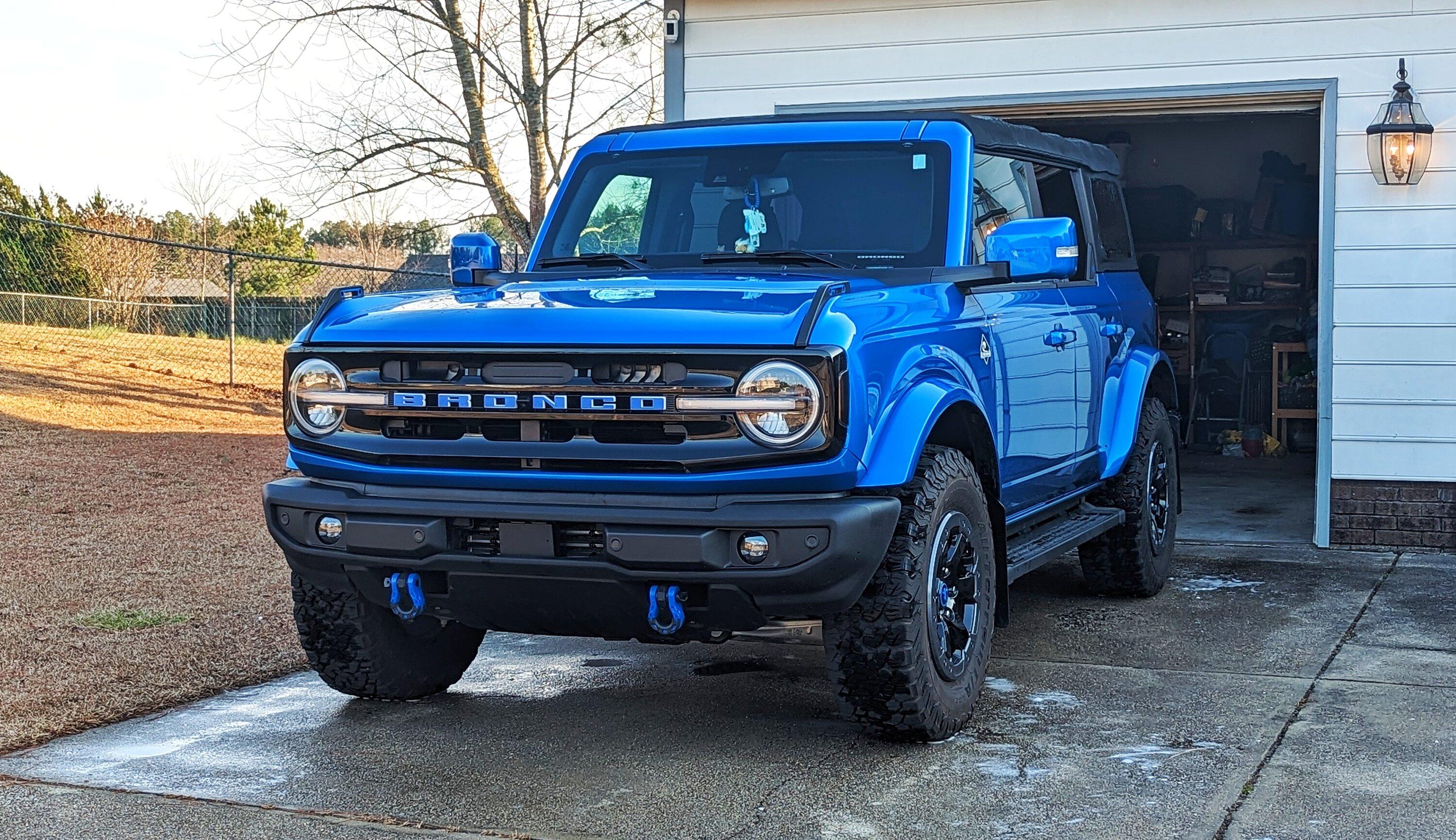

Today marks 1 year since the day it was built! Happy Birthday Blu! I washed & detailed the inside & outside.
A few days ago I also decided to put on some tinted film over the side markers. I like it with the black grill.
