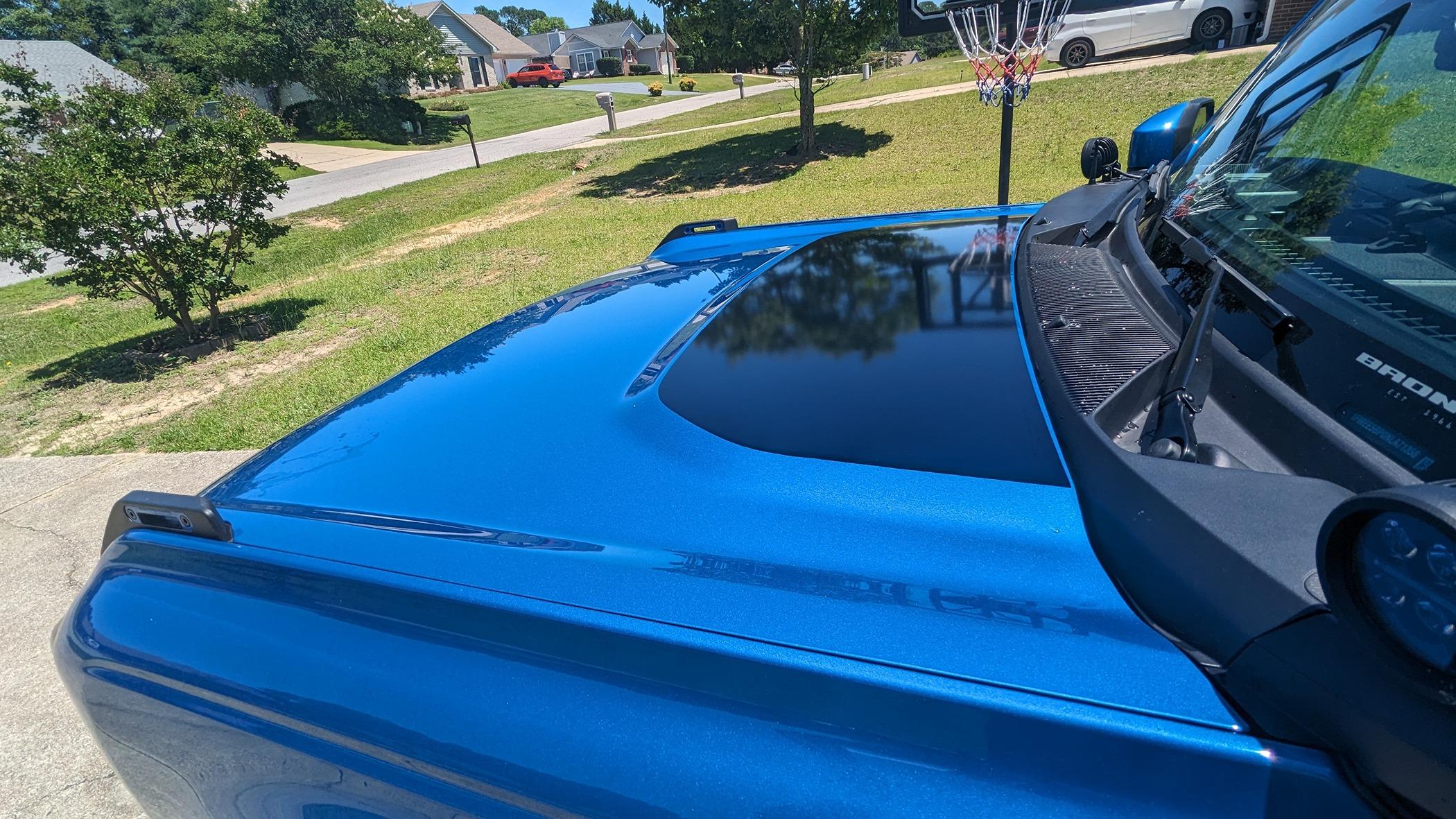

Installed the @StickerFab gloss black hood overlay. Followed his install vid with soapy water in a spray bottle and it installed super smooth. No bubbles, etc.
Ford Bronco Jazer's Blu Pony PXL_20240530_170919302
I chose to leave about 1/8" ish hood exposed against the cowl, instead of wrapping the overlay around the edge. I figured that it would be less likely to peel up over time as well.

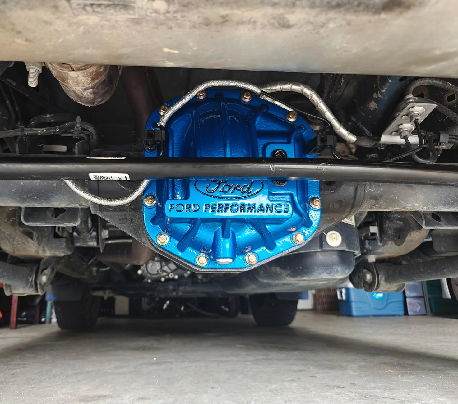

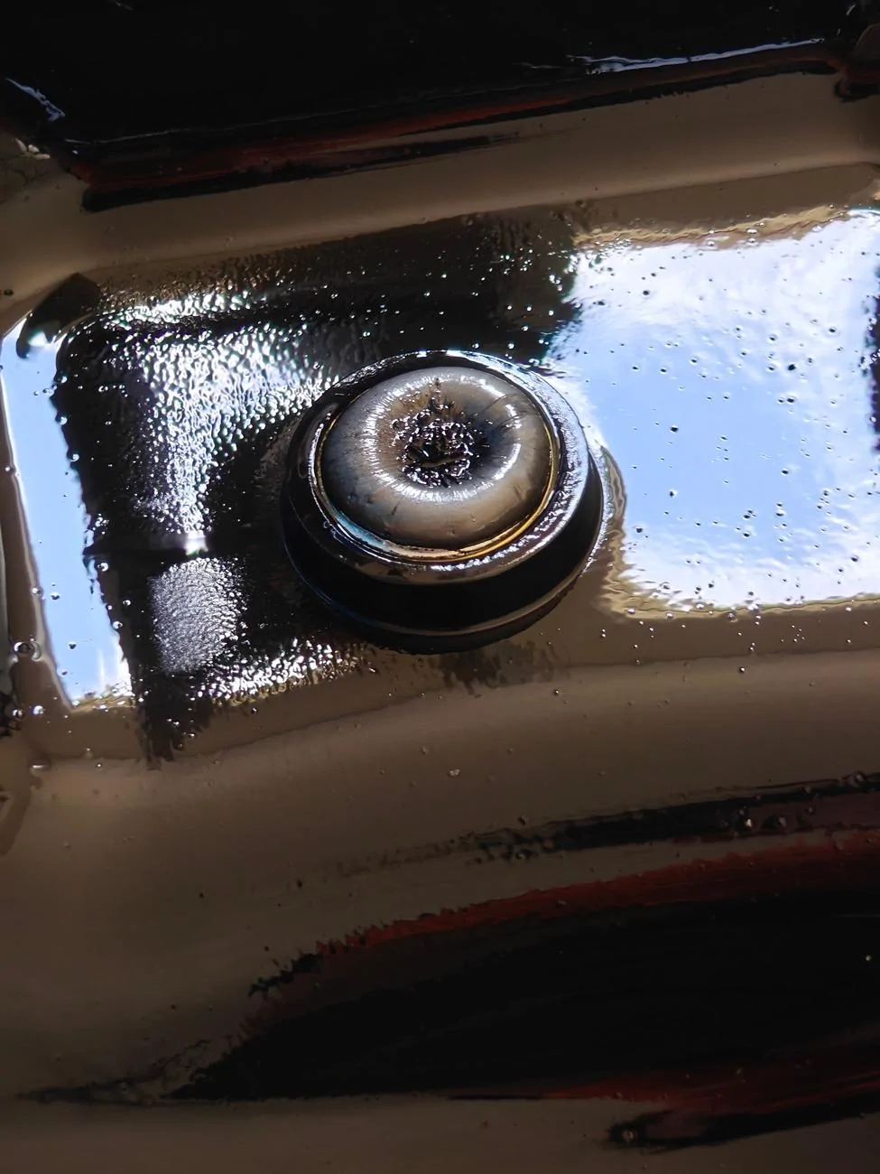

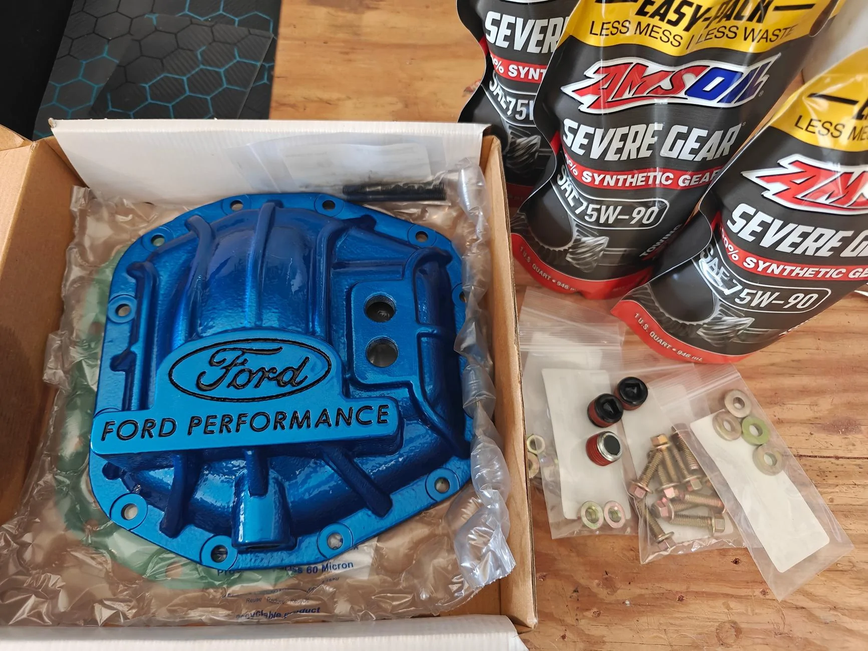

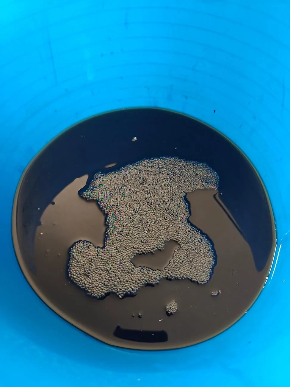

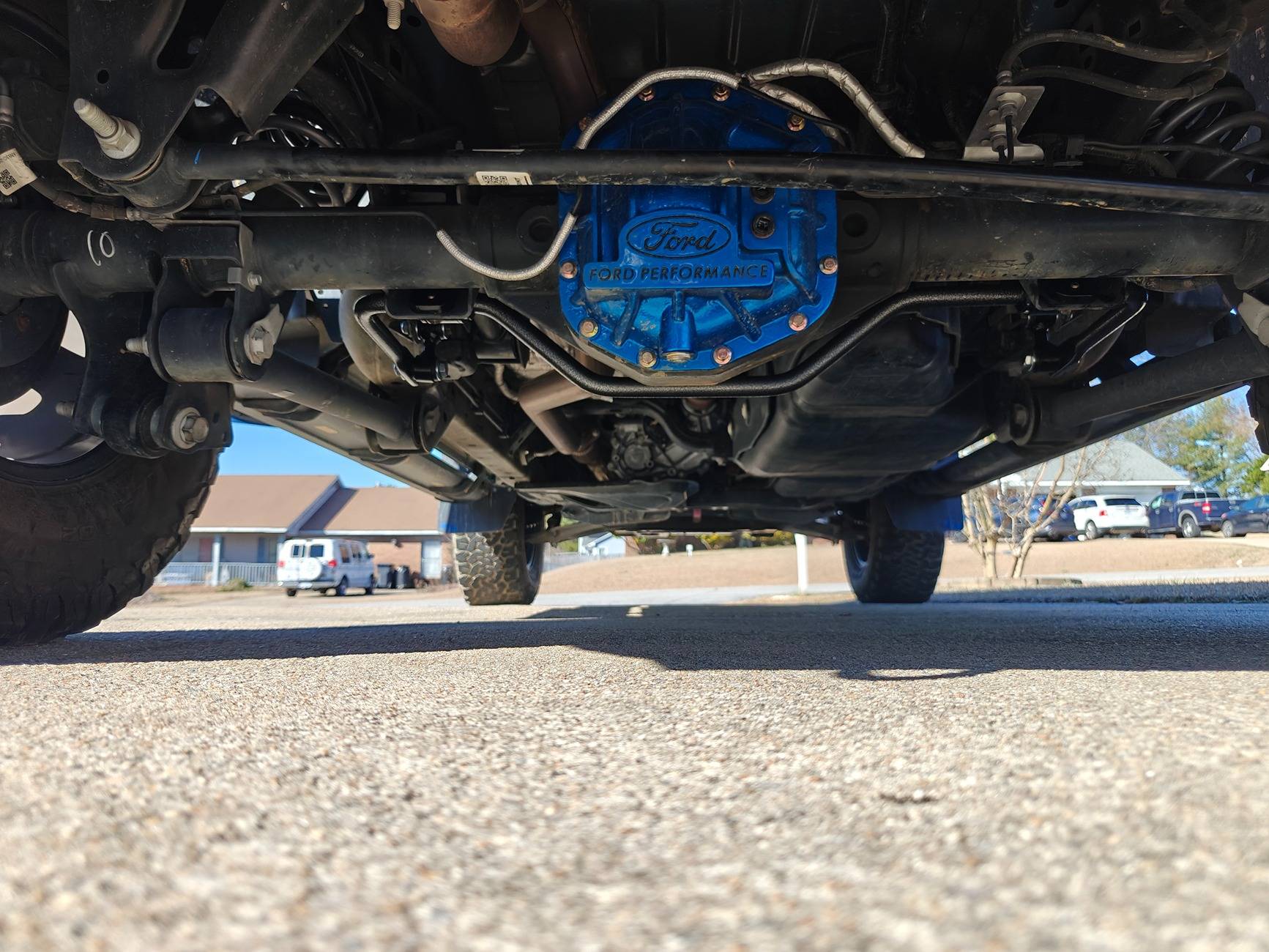

Rear diff oil change day. Kind of wish I did it sooner, but 25k miles is far better than Ford's recommendation! Fairly dark and lots of gunk on the magnet.

Looks prettier now too! She needs a lift and a smaller muffler now though..... 😈

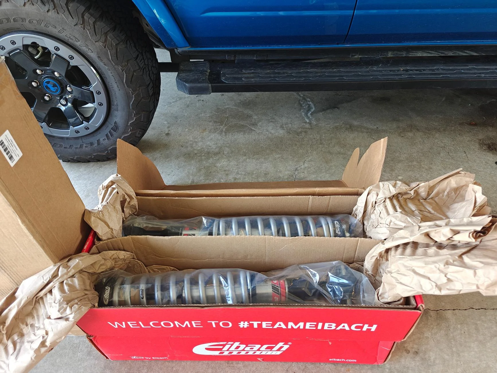

It is time!
Eibach Pro Truck 2.0s. Hoping I don't shrink the 33s tooo much 🫣

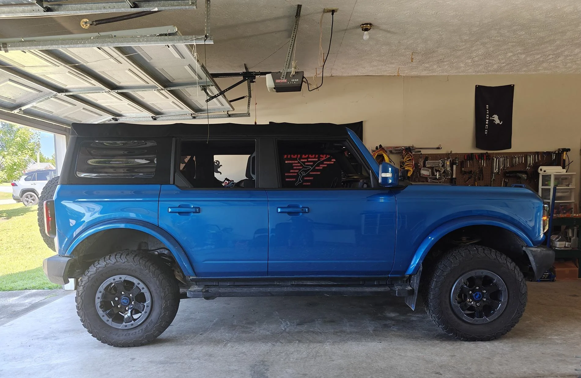

After a LONG weekend, I completed the install on the Eibachs!
Ford Bronco Jazer's Blu Pony IMG20240825144555
Happy with my settings. Kept about 3/4" of rake. Have the rear's ALMOST bottomed out at lowest settings. Left a few threads for adjustment if needed. Didn't want to shrink my 33's too much.

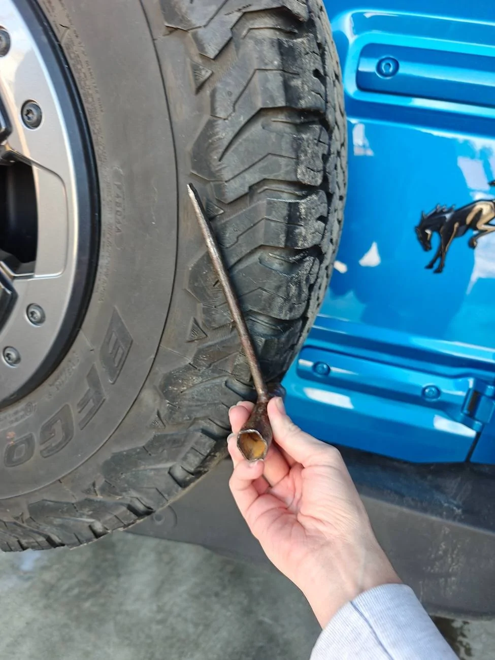

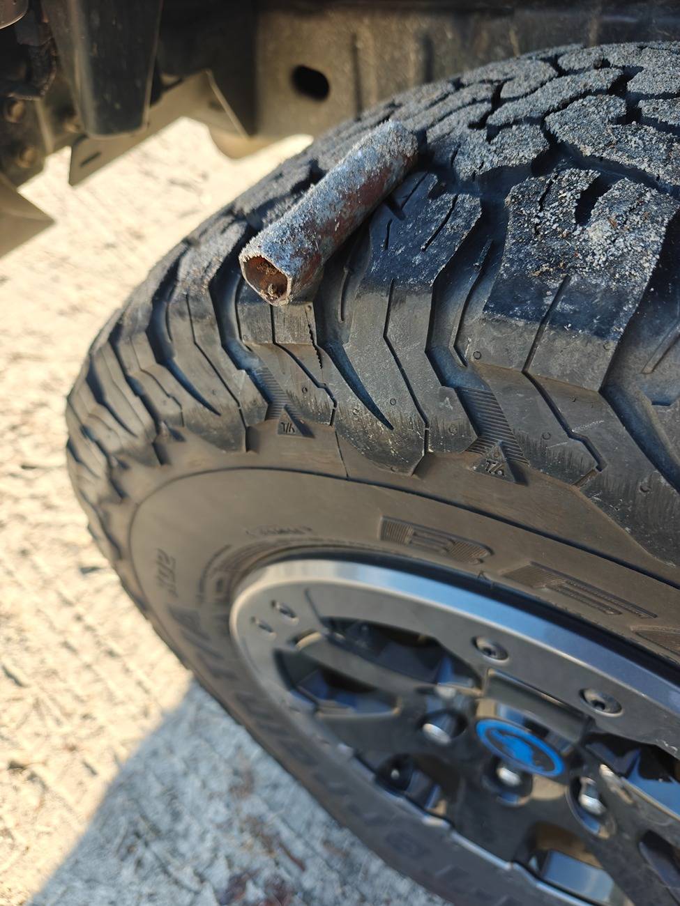

Last week I had an unfortunate incident where I picked up someone's apparent chainsaw tool and demolished my tire. On close inspection, the base of the tire where it went in was tearing, the tread block ripping off & the hole was quite large in diameter & too nearish the side wall for the shop to repair it, understandably.
In a position where replacement of these tires is in the near future anyways, and plans to upsize, replacing just the one was not an option. I ended up ordering a new set with a bump in size to 34s. Going from 285/70 Ko2s to 285/75 Toyos.
Ford Bronco Jazer's Blu Pony IMG20250218090311
Showing how far it went in. Glad to have such beefy tires in this situation. This tool could have potentially caused wheel damage with a lower profile tire.

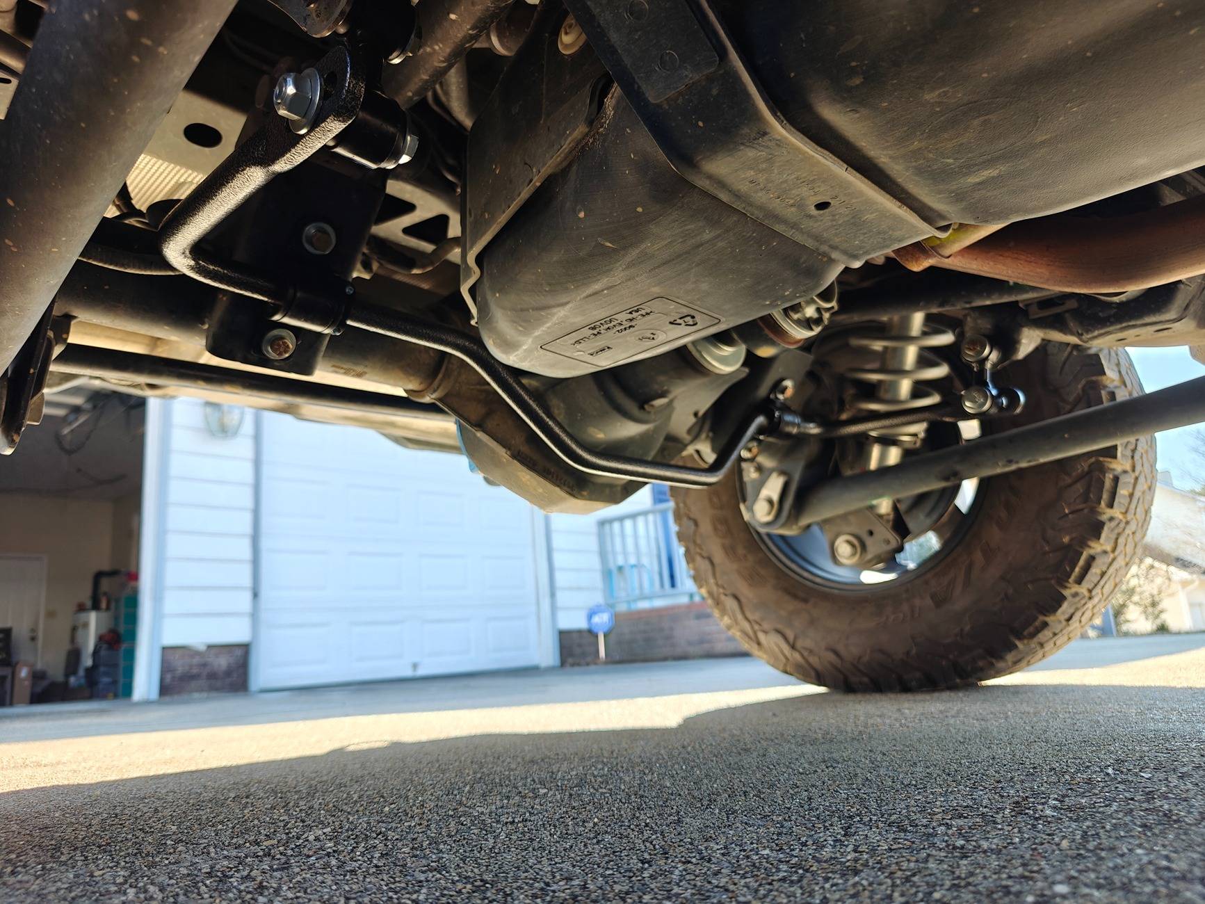

After installing the Eibachs, I've noticed extra lateral sway while driving. It isn't terrible but enough that it bothered me after awhile on a roadtrip and particularly a few weeks ago driving while I was recovering from Influenza. The "rocking boat" sensation really bothered me so I got home and ordered the Hellwig rear sway bar.
Finally had a nice enough day to crawl under the Bronco & install it. I set it at mid adjustment for "increased sway control". I only took it around the neighborhood so far, but definitely noticed an improvement. Less body roll, less rocking & less brake dive! I am eager to drive it at speed and see how much better it feels overall.
It hangs down a little and will definitely need to be cognizant of it's location when off road, so as not to hang it up on anything - but the day to day performance is worth the downside there.

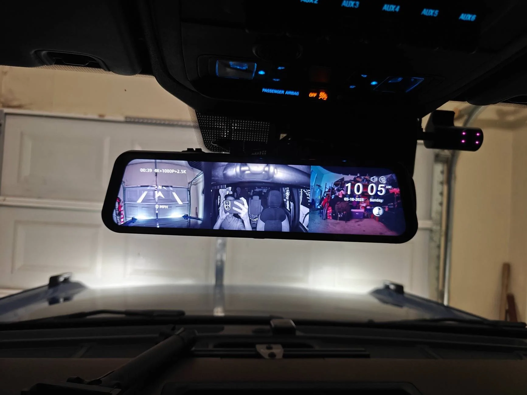

Installed the Wolfbox G900 TriPro. Here is a link to my install/review thread on it. Really neat lil gadget!
