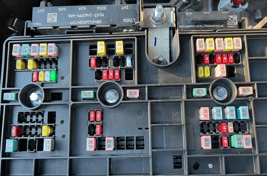

you could show me which one is fuse #20?
Ford Bronco Issues with FordPass and Alarm 1677626709243
The only fix to this is resetting your modem by disconnecting it from power. You can do this either by pulling fuse #20 on drivers side fuse panel ( which I suggest getting a fuse remover/tweezer because mini fuse is pretty hard to come out ) or by disconnecting the battery for 5 minutes.
This has happened to me 3 times with little less than 1k miles on my Big Bend. Supposedly Ford is aware of this problem and will send out an update who knows when.
You need the fuses under the steering wheel not the fuses under the hood. On that set of fuses it's pretty clearly marked on the plastic next to the fuses.
That being said I pulled fuse #20 and left it unplugged for 15+ minutes and it didn't work. I've also seen a handful of posts stating it is fuse #12 which I haven't tried.
