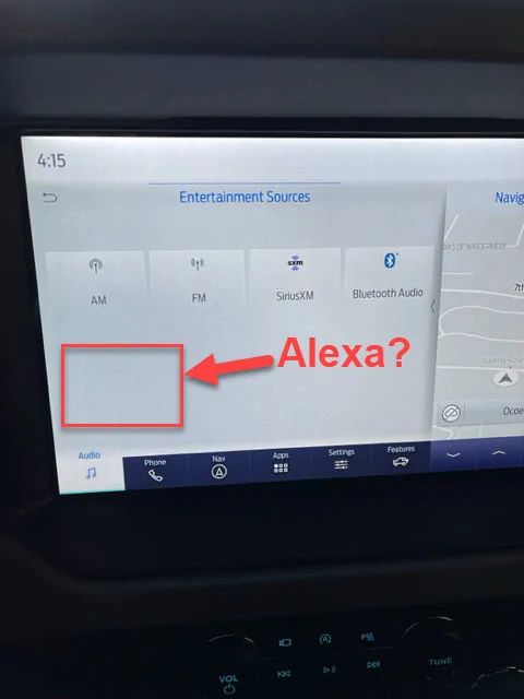

I just took delivery of my 2023 Bronco Badlands and was enjoying all the connectivity features such as Ford Streaming, Alexa music and so forth.
Today, 10-days into ownership, it appears that I've lost all connectivity as I no longer have Alexa music on my Entertainment Sources screen, the FordPass App is showing outdated mileage and range information, the remote start/lock/unlock features are not working, and the connectivity menu options are not working.

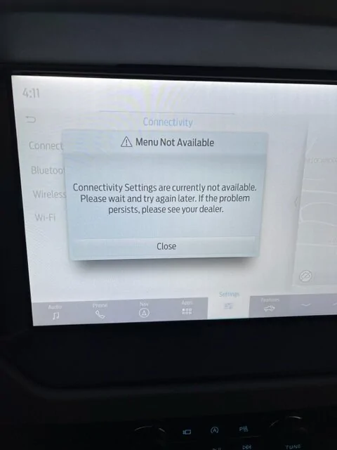

When I tap on Connectivity Settings within the Connectivity screen, the pop up menu will either display a spinner and close (without any message) or a dialog titled "Menu Not Available" with the message "Connectivity Settings are currently not available. Please wait and try again later. If the problem persists, please see your dealer."

I found several topics on the Bronco6G forum describing the issue and suggesting remedies such as disconnecting the battery or the #20 fuse on the interior fuse box so it sounds like I am not the only person with the issue.
I called and spoke with a Ford Pass representative who informed me that Ford is aware of the issue and expects a fix within the next month or so. I subsequently spoke with two additional representatives in hopes of getting a more definitive answer or, perhaps a chance to speak with a tech. One person was unaware of any such issue and another in the "interior technology/over the air department" gave me a case # CAS-41322306.
Can someone at Ford provide clarification on what our expectation should be regarding the reliability of the connectivity system? For example, I am no longer able to depend on the use of the Ford Pass App to unlock my doors if I leave the keys in the vehicle. Also, can I really expect my system to start working in the "next month or so" or am I being given "happy talk"? Should I be feeling this level of disappointment after waiting 2 years and 4 months for my Bronco?
