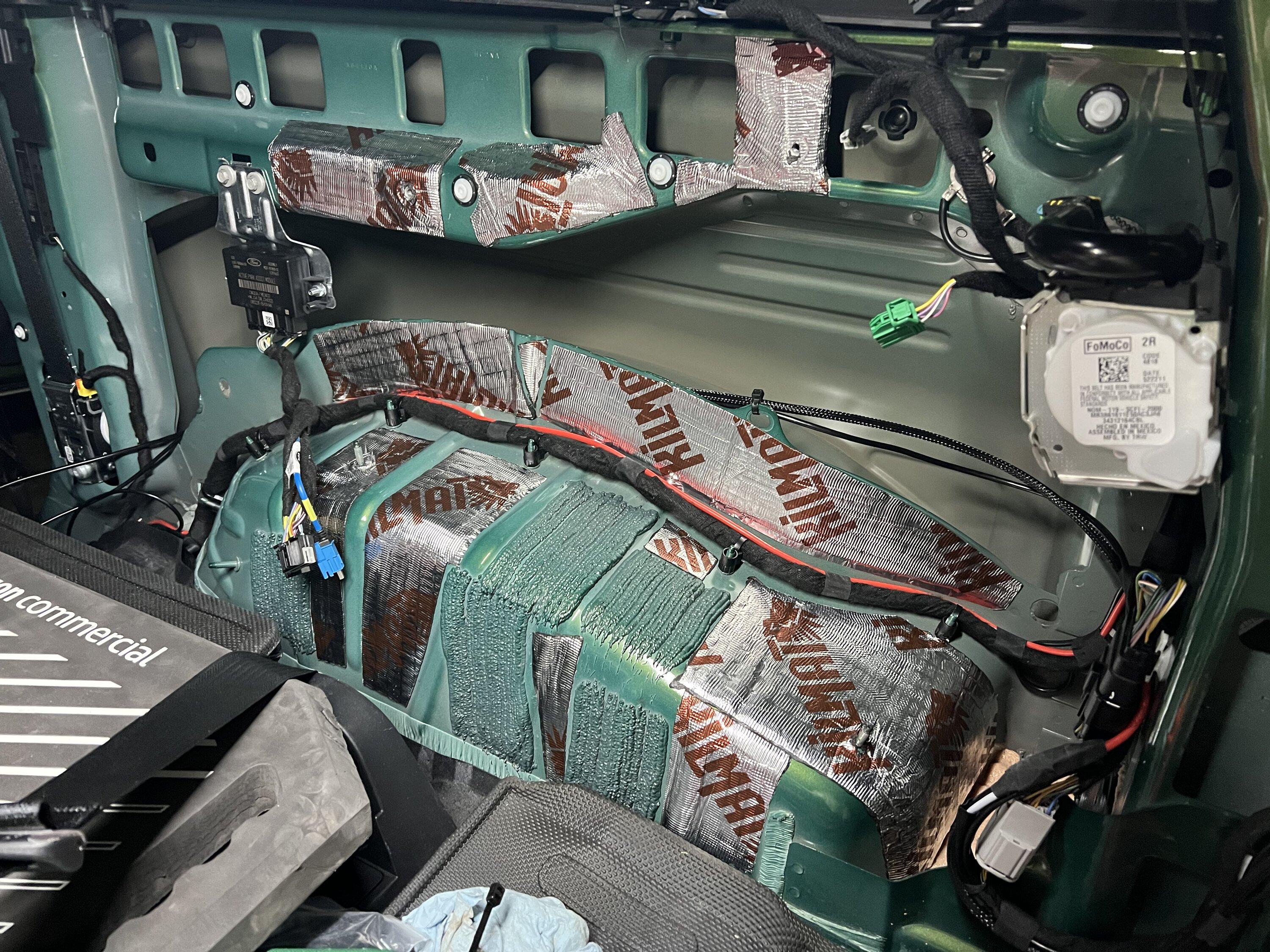

Didn't help at all. See this post.
Last night I added Kilmat to the metal behind the enclosure and rubber washers between the enclosure and the mounting points. Unfortunately, by the time I was done, it was too late to test at a high volume. Will give it a try on the way home this evening.
If this still doesn't solve the rattle, I will pull the enclosure again and cover the outside of it with Kilmat.

Added a sheet of Kilmat to the interior of the enclosure and it still rattles like crazy! 😭
Next step will be removing the enclosure and adding Kilmat behind it. I haven't had the rear panels in my rig for a while, so no place to jam paper towels like others have.

I believe I have finally killed the rattle. As I mentioned previously, installing Kilmat inside the enclosure did nothing. However, installing Kilmat on the metal panels, as mentioned in my other post has eliminated the rattle. I've tested it with a fairly wide genre of music and have not experienced any further rattling.

Congrats and thanks for sharing!
