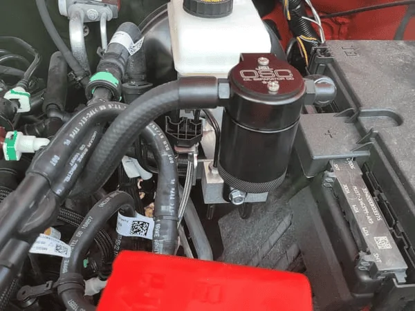

I was not informed on this topic so I have dug into this a little bit and found a good can I think. Any outside opinions and info on this matter is appreciated.
Oil Separator | Oil Catch Can | 2021-2024 Ford Bronco EcoBoost (jlosc.com) 1710202851548-7t.png
I cannot swear that it is doing anything with only 25k on the odometer, but I am in it for the long haul. I want my engine to last a long time so I am being cautious. I installed the same one pictured above and feel slightly better about my long term odds. Is it really doing anything that the engine isn't already doing? No idea, but I like to hedge my bets. I don't believe it is actually hurting anything in the worst case.
