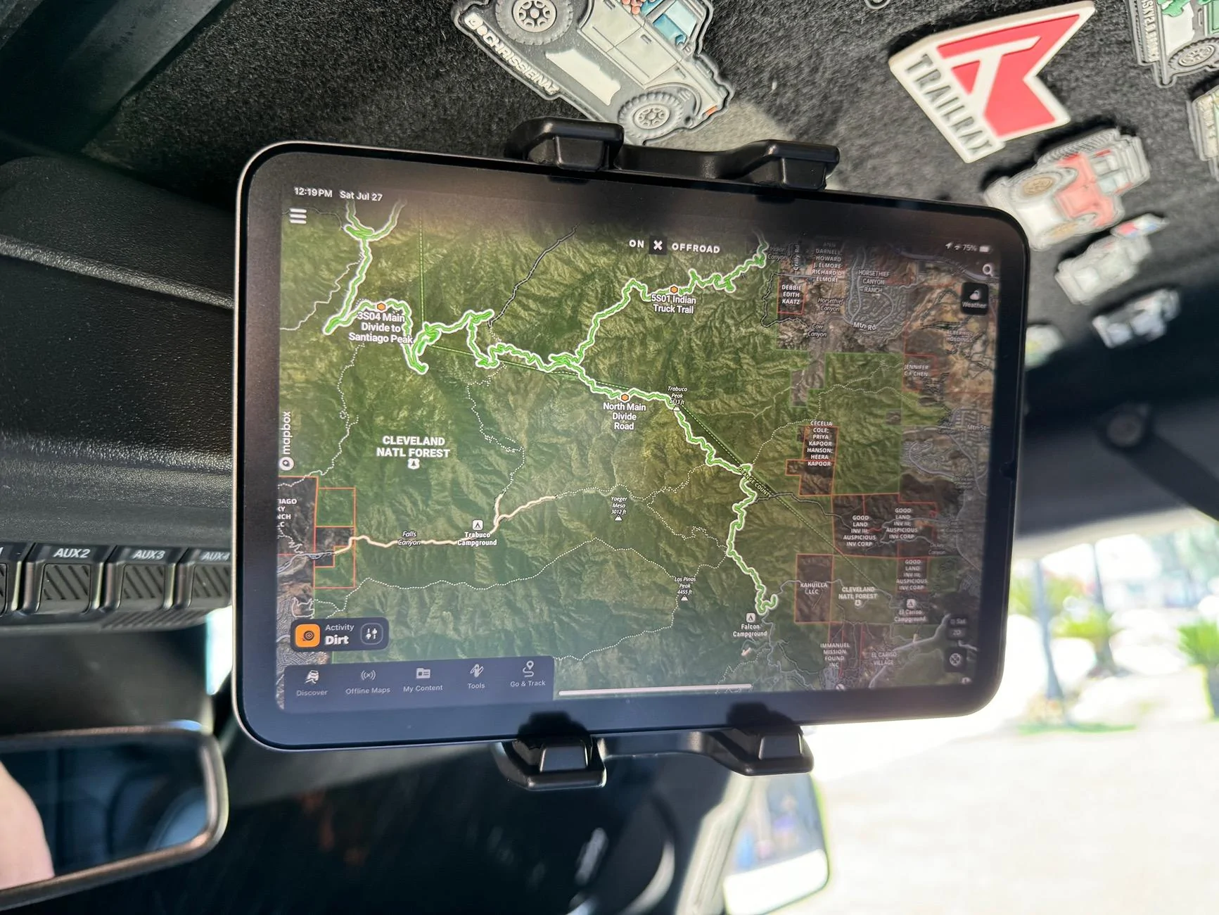

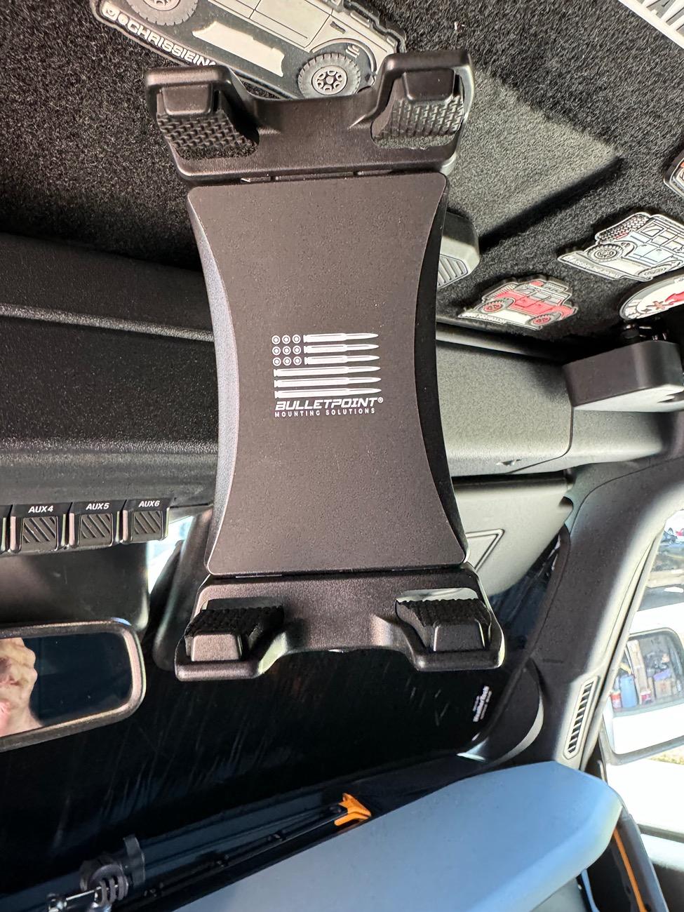

This is what I use with my iPad mini
CMM OFFROAD FORD BRONCO HARD TOP PANEL BALL MOUNT
BULLETPOINT - Micro Carbon Fiber/Kevlar Hybrid Mount Arm - Matte Finish
BULLETPOINT - Tablet Holder - Compatible with iPad, iPad Mini and Samsung Tablets
NICE Setup!!! Never thought of going overhead (y) So couple of questions....

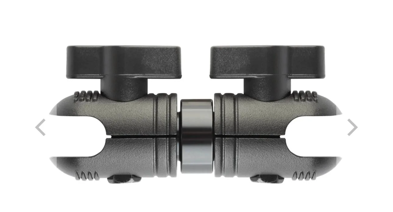

- How did you get the arm to be so short? I just see the ball-end connectors on each side and no center bar/shaft. (NM - figured this out :) .....it's the 1cm version)
- I want to mount a 9.7 inch ipad there - will that mount fit it? Or do you recommend nothing bigger than a mini (too obtrusive?).
- So the iPad has to have cellular since you cannot "cast" from your iphone right? (no CARPLAY). How much is the cheapest cellular plan(and from what provider) you need to do this and make it work?

For the arm I use a Mini (9cm | 3.54") I did have to convert one of the Flange Sockets from a 20mm to a 1” ball end.
Ford Bronco Ipad usage for Bronco :) IMG_1215
I have a WiFi plan in the Bronco so I hook it up with the WiFi an it’s good to go.
I use a iPad mini 6th gen that’s 8.3-inch (diagonal) display the BULLETPOINT mount is adjustable, expands from 4.75" to 9.25".

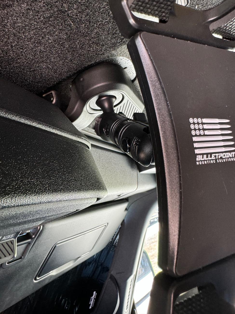

Thank you VERY MUCH for this tip.
I ordered one from CMM. A very nice product delivered really fast.
Dumb question. An easy install? No instructions either in the envelope or at CMM. I'm asking b/c I want to install tomorrow and it will be raining. Hoping that I don't have to take the panel out (and the roof rack off); hoping it's just a remove OEM fastener and install ball mount.
Appreciate any tips you can send my way. Even if it's as simple as, "hey dummy, just remove OEM hardware and install mount." That works, too. :)

Remove OEM hardware and install mount. The only tuff part is get the torq right so the latch works with ease and the right pressure on the panel.Good luck you got this.
I love my set up.

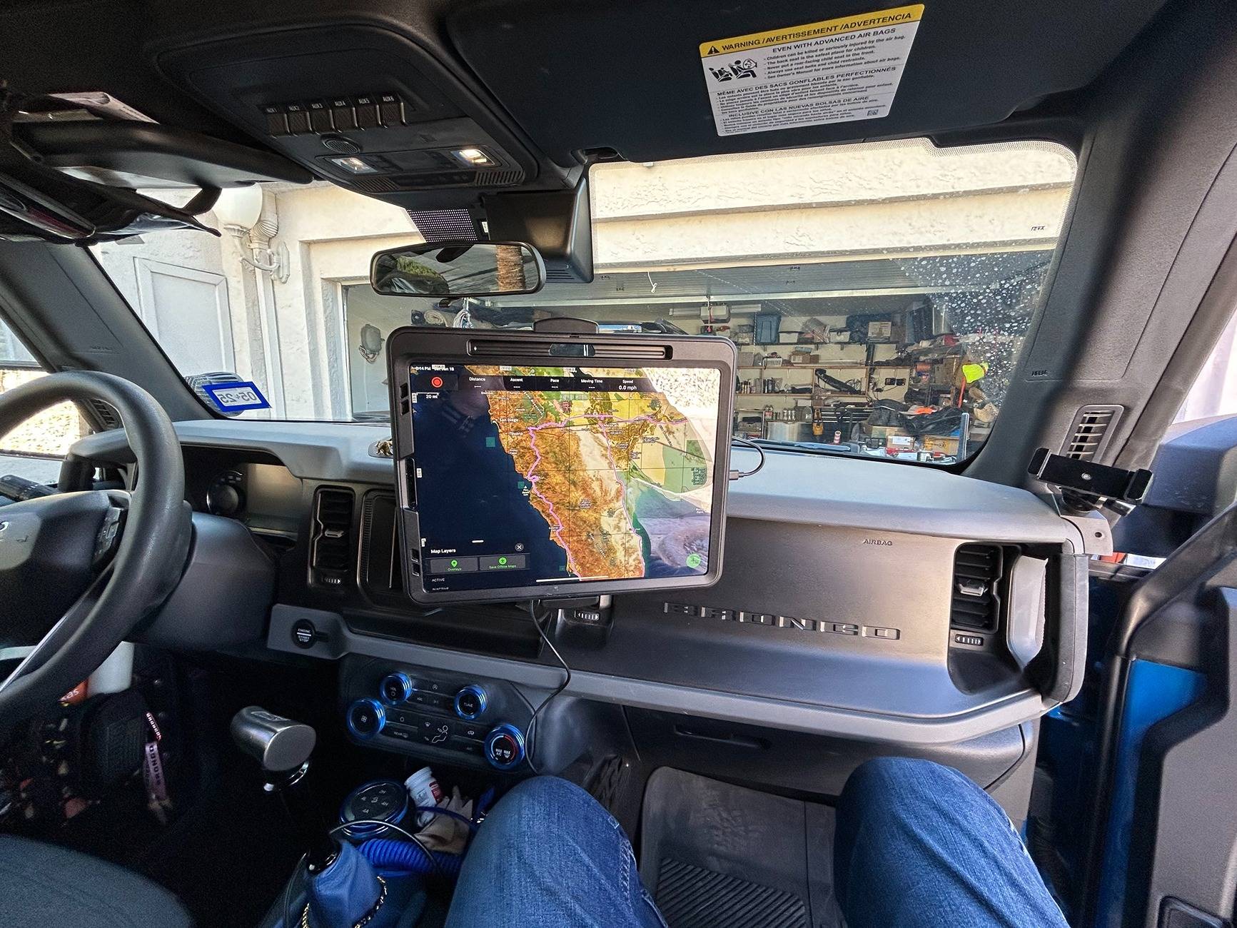

I too am working on an iPad mounting system for running GAIA in the Baja. Went with the Builtright Pro Dash Mount and ArmorX appliances (iPad case, arms, balls, claw, etc). So far so good. I'm using a 12.9" Pro for now. It's pretty heavy and may need to go smaller for stability. Will know more when we test it on the trails. Plans are to centralize power under/on the Dash Mount for cable management and stable power,
Also mounting a UHF/VHF radio. More to come.
