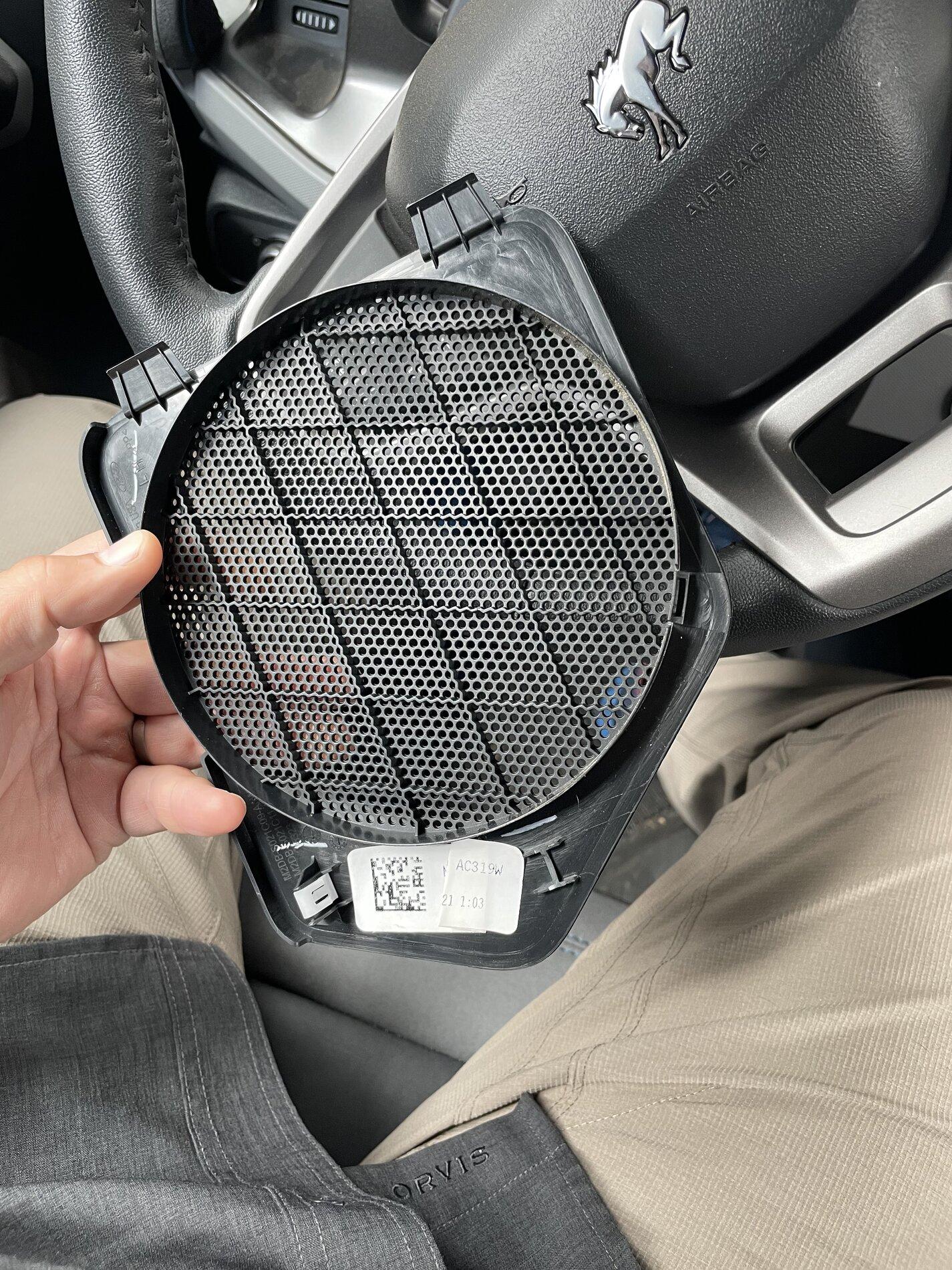

Use some 3M dual lock if the grill is back ordered. A 1” square of the dual lock in place of that broken clip will easily hold it in place.

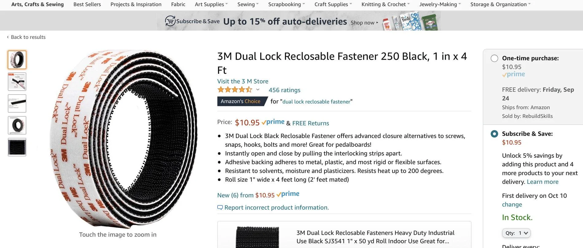

If you do this, make sure you get the industrial strength with red backing on the adhesive side. Otherwise in heat the weak adhesive will fall off. Also suggest prepping the surface with an alcohol wipe before applying velcro locks.
Alcohol wipe is recommended and I’ll normally rough up the plastic substrate with a scotchbrite as well. The adhesive is good for temps up to 220* and I’ve never had it fail in an automotive application.

So, this just happened. Driving along and I felt something hit my foot and fall behind the clutch pedal. I came to a stop and found the cover to the speaker in the kick panel had broken off and came loose.
I'm not sure I see this as the "interior falling apart."
