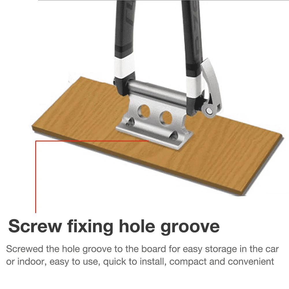

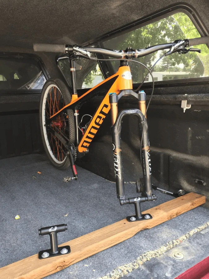

This is a really clean solution! Quick search showed bed rail and rooftop fork mounts.. I'm assuming the bed one would mount better to the 2x8? Does it matter? Thanks for the pro tip!
This is similar to what I am saying. Just get the fork mount that bolts and mount it to the wood.

That's what I was imagining but not what I had found originally. Rock on, this is a great idea. Thanks!
It works much better than lying your bike down as it holds it firm and upright. Worse case a bungee cord over the frame, or the seatpost to a point in the vehicle works for stabilization if needed.
Considering I ride over 100+ per year, and have a bike in my vehicle 200+ times a year this is my preferred way for transport. I don't even think I would get the optional fork mount from Ford as A)this method is cheaper and B) likely that only fits 100 mm front forks (mine range from 100, 110 thru axle, 150 thru axle and I needed different set ups for different bikes).
Likely if you don't know you just have a simple fork mount 100mm width and it will work fine.

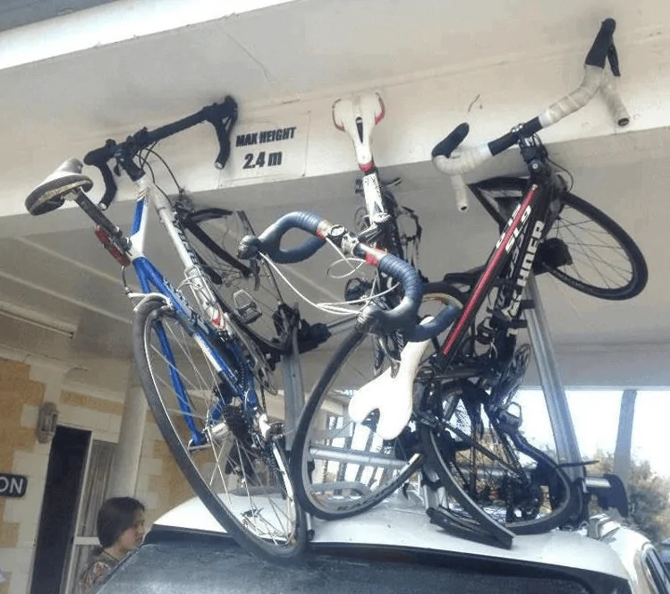

Roof mounts beware. By the time you put the rack on, that's a pretty high lift for the bike. Then there is always this...
Ford Bronco Interior Bike Rack 1619635404967
A friend of mine forgot his mountain bike and turned on a road with an immediate low railway underpass. Shattered the glass roof of his van and messed up the bike...plus they are still out in the weather, if you have good bikes you want to protect.

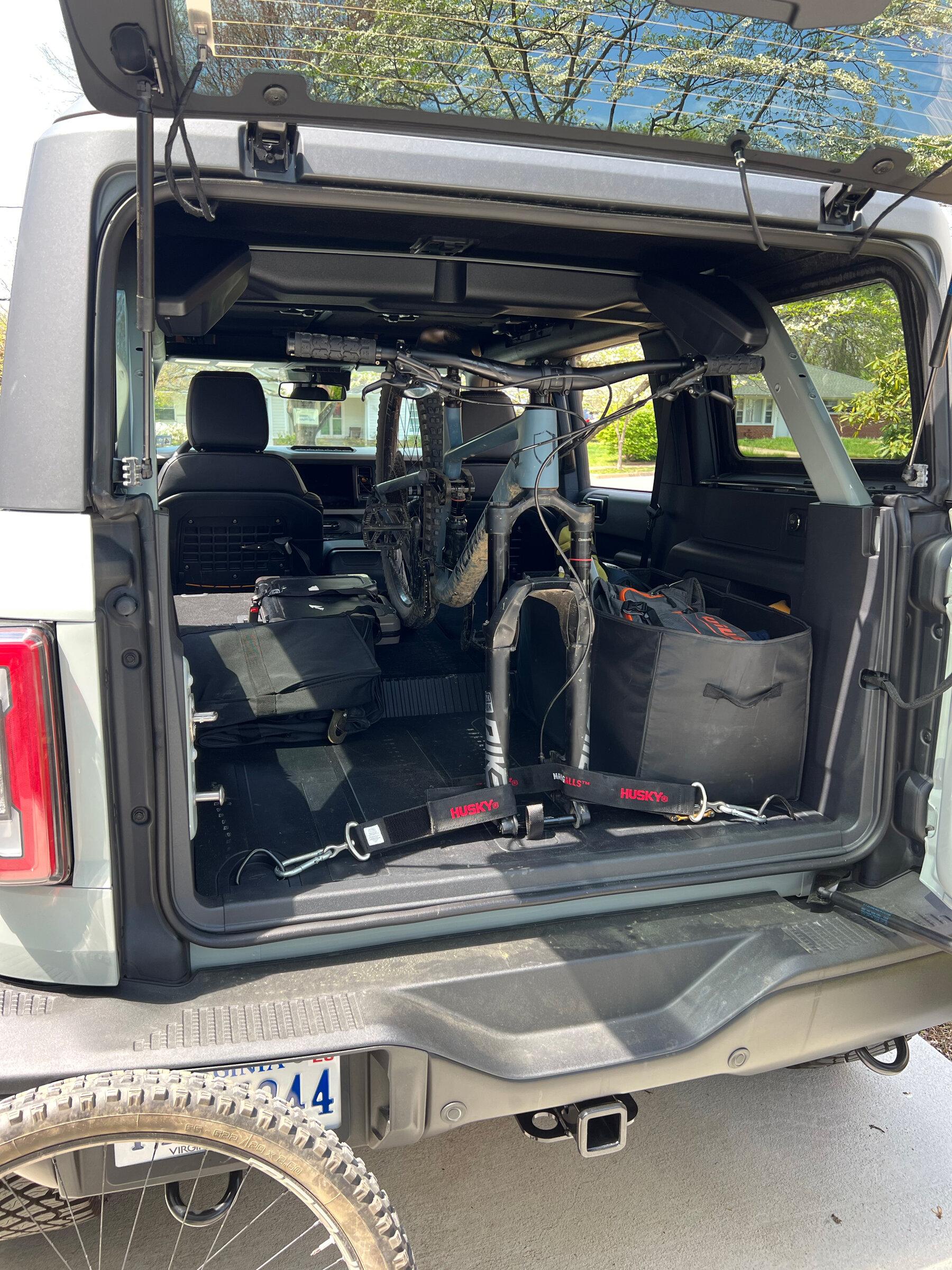

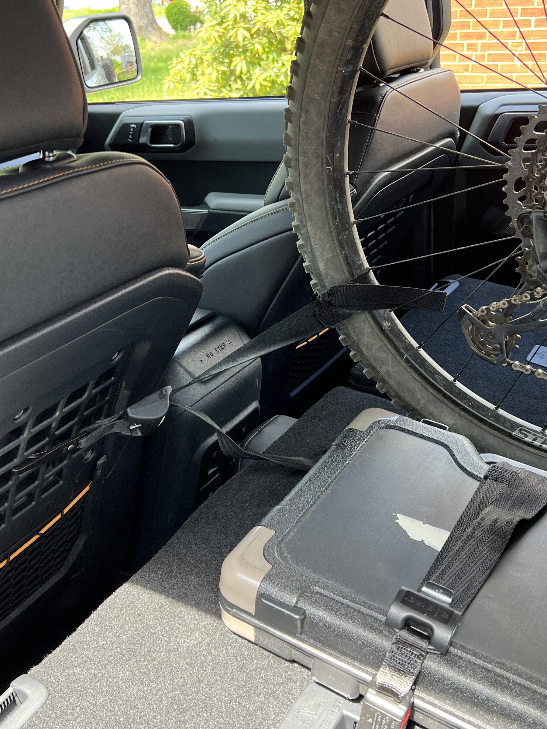

I have a 3-bike hitch rack on order. While I wait for it to come in, I've been running this set-up and it's been working great. It's just two Husky velcro straps from the anchor points to around the fork and another strap (old carseat anchor) from between the molle panels on the front seats and through rear wheel.
I plan on getting a getting a fork mount to make this setup more secure. I also want to see if I can shuttle four bikes (three on the hitch rack, one in the truck) and still seat two people in the back seat.

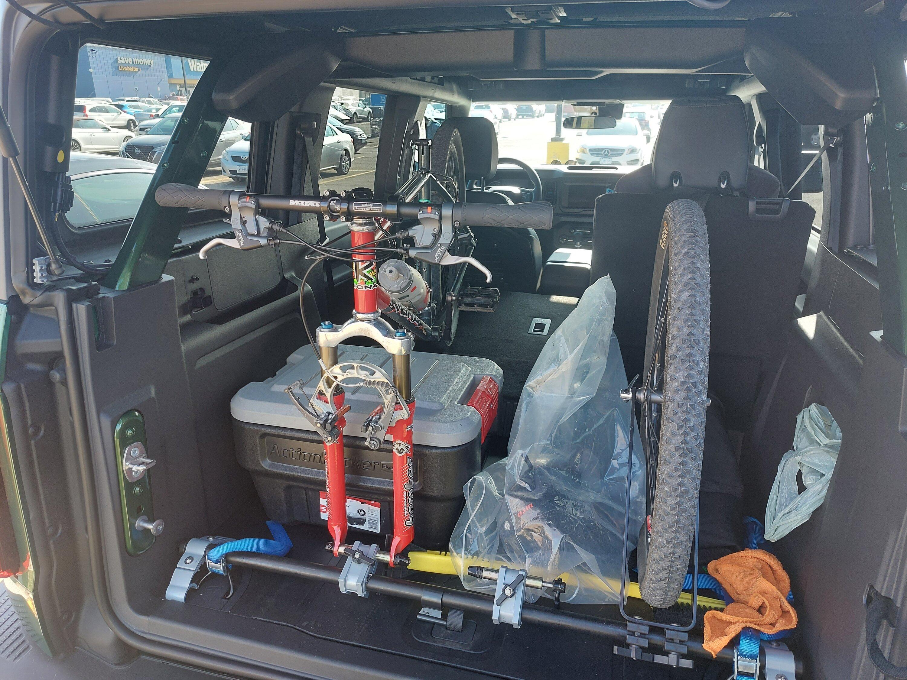

This is my setup. New Bronco old school steel.
It's a factory rack from an xterra. It works really well. These old bikes aren't as long but plenty of room

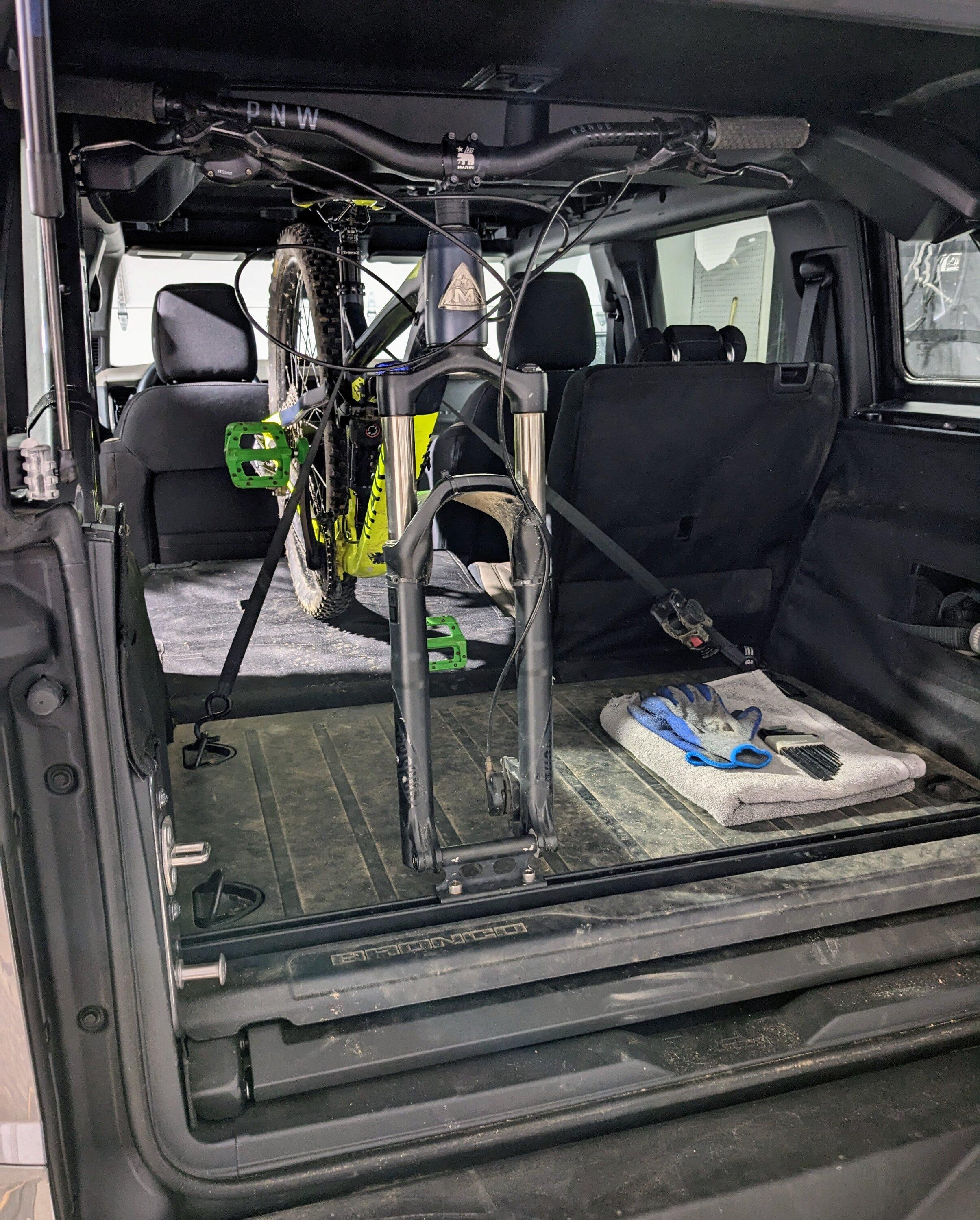

Here's mine - I cut an extra bed rail from my old Tacoma to fit the Bronco cargo width. With a ratchet strap across the d-rings, the whole thing is solid. The beauty of the Tacoma rail is it uses t slot bolts and accessories so you can quickly slide and tighten everything where you want it. The fit is a little snug with a full size 29" mountain bike but I do have the added floor height of the slide-out tailgate.

I'm curious how this setup worked out for you. I'm looking for a solution to keep my mountain bike upright inside the bronco. Is the bike stable? It looks like it would just fall over. Have you tried anything else? Thanks.
