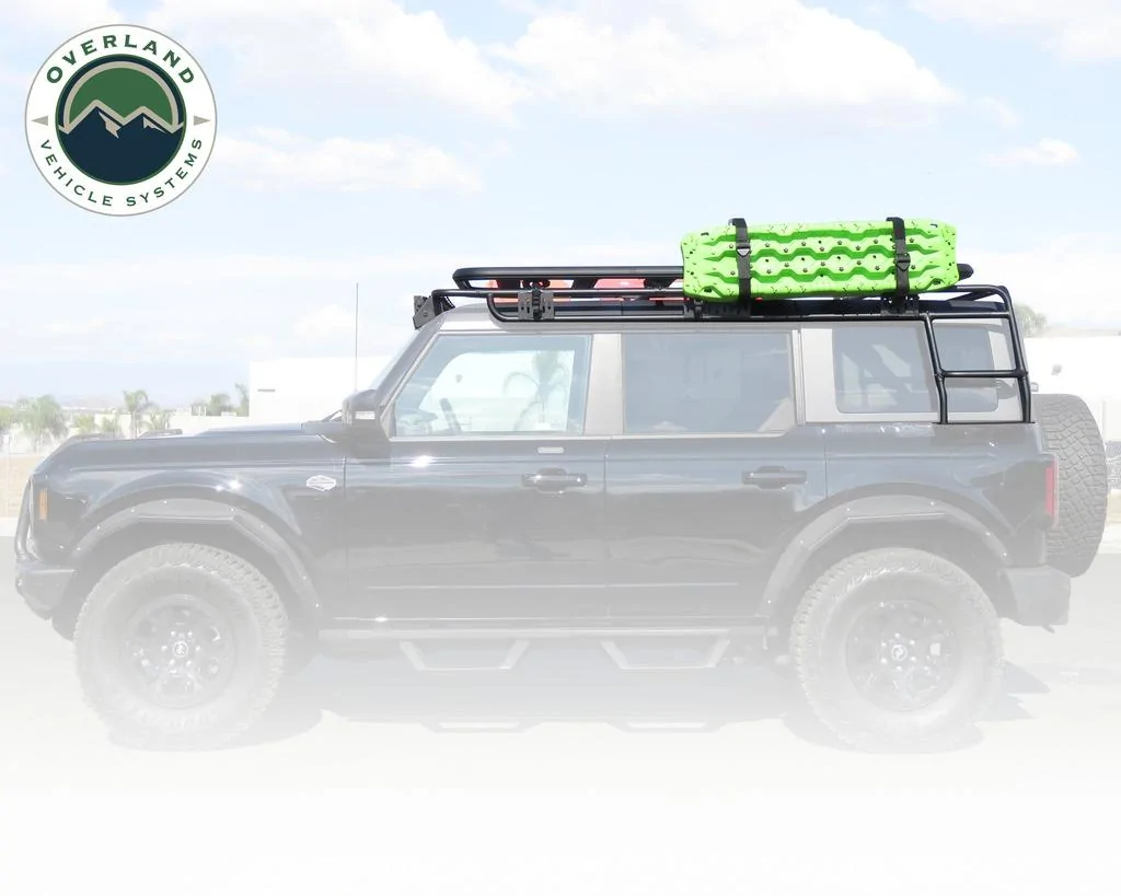

my only issue that i can see with all these top of tub frames is hard top alignment after?

Looks great, like to see it on a 2dr.

Based on the pictures, it seems like it would be impossible to remove any of the roof panels. The sides have a lip coming down that would block you from being able to slide them out... Or am I seeing it wrong?

That was my take as well. Also not crazy about the piece above the windshield unless you are running a light bar. I prefer to keep all lights below the hood line for glare.

With this not being my first rodeo. I have a real issue with the one that requires I mount it between a factory mounting point of the vehicle and the hardtop itself. This has always resulted in water leak point, fatigue on the seals and if I remove it for some reason. The seals now need to be replaced or again, leaks. Well I can always put silicon there (And have) but not on a $60k+ vehicle!
Of course this reduces the amount of weight I can place on a rack that is dependent on the hardtop structure itself. And if overloaded can damage the hardtop. This helps me in keeping weight under control (Glares at lovely wife who likes to take everything on trips).
So if more weight capacity was our need (As the wife rules our world). To heck with the seals! Mounting to the body between the Hardtop and the body is the only way. And this one is a nice option.
